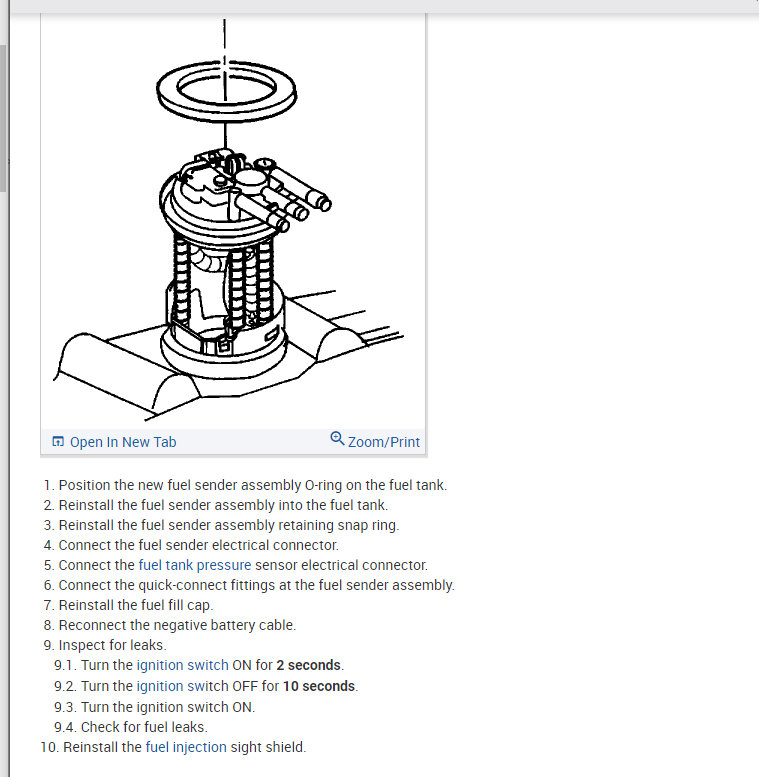

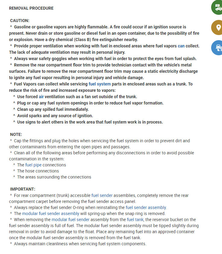

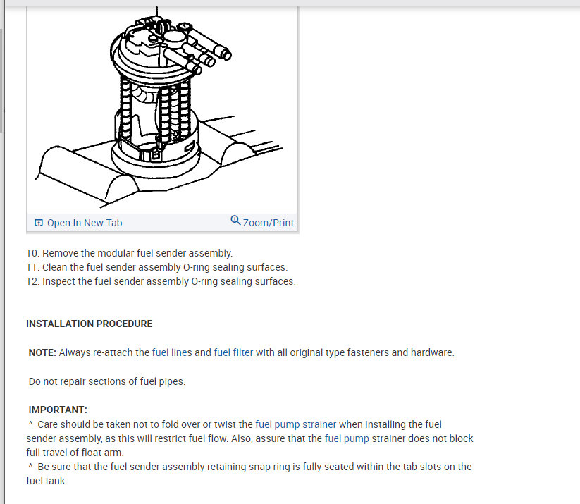

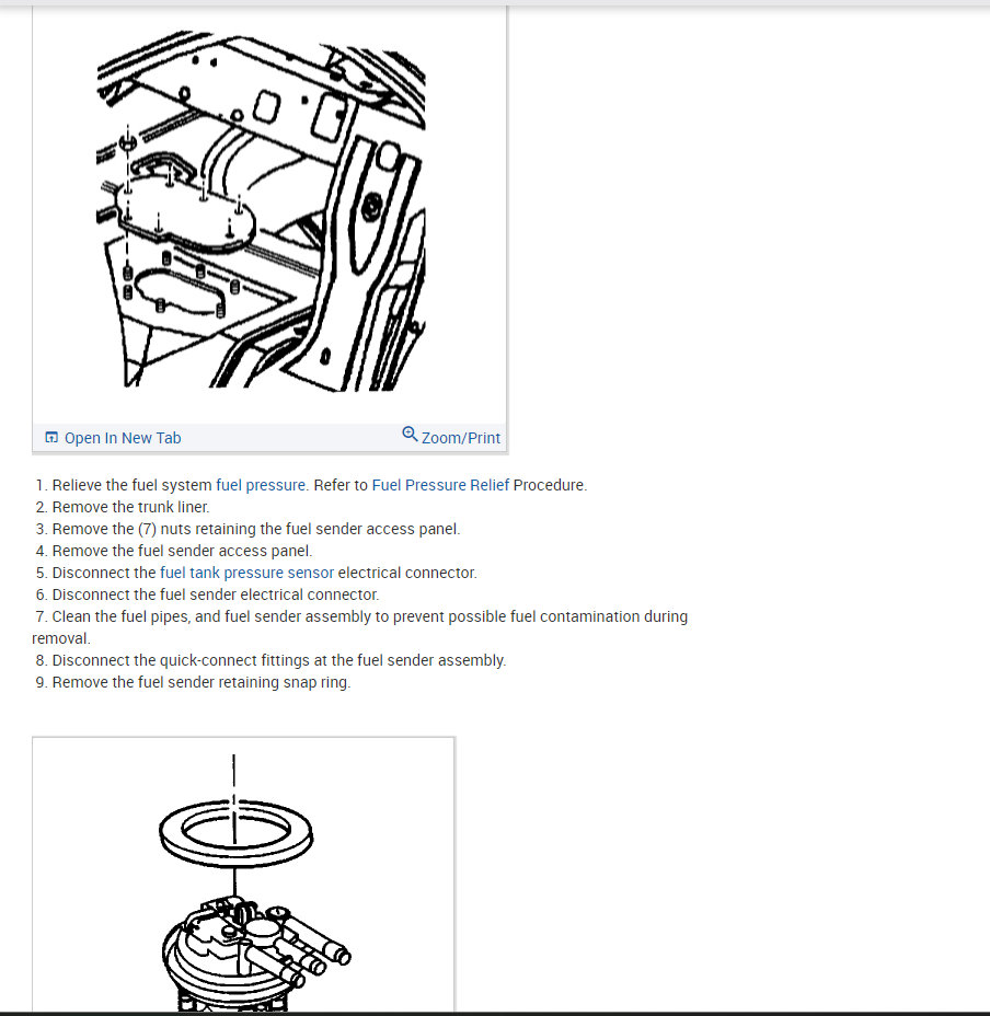

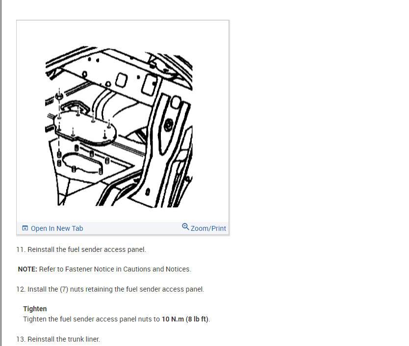

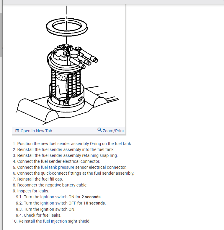

If the car starts and stalls then it could be a theft issue or it could be the idle air control.
However, it sounds like you have a fuel issue. If the vehicle ran better after doing a fuel treatment then that points to possible fuel contamination and clogging the injectors.
So, I would suggest checking the pressure and then doing another injector cleaning. If this makes any improvement then we are going to need to clean the tank out, replace the injectors, pump while the tank is out, and the fuel filter.
https://www.2carpros.com/articles/how-to-replace-a-fuel-injector
https://www.2carpros.com/articles/how-to-change-a-fuel-filter
https://www.2carpros.com/articles/how-to-replace-an-electric-fuel-pump
I would not worry about the theft system or IAC until this other stuff is checked and then go from there.
