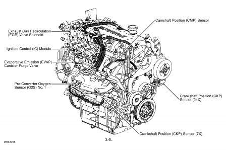

Ask your hubby to check CKP wiring and perhaps remove and clean sensors ! I would expect if it was a bad injector you would gat a misfire code for the actual cylinder/injector that is misfiring ..let me know
Crankshaft Position (CKP) Sensor (7X) (3.4L)Lower right side of engine. See Fig. 3 .
Crankshaft Position (CKP) Sensor (24X) (3.4L)Left front of engine. See Fig. 3
https://www.2carpros.com/forum/automotive_pictures/266999_ckp_4.jpg
