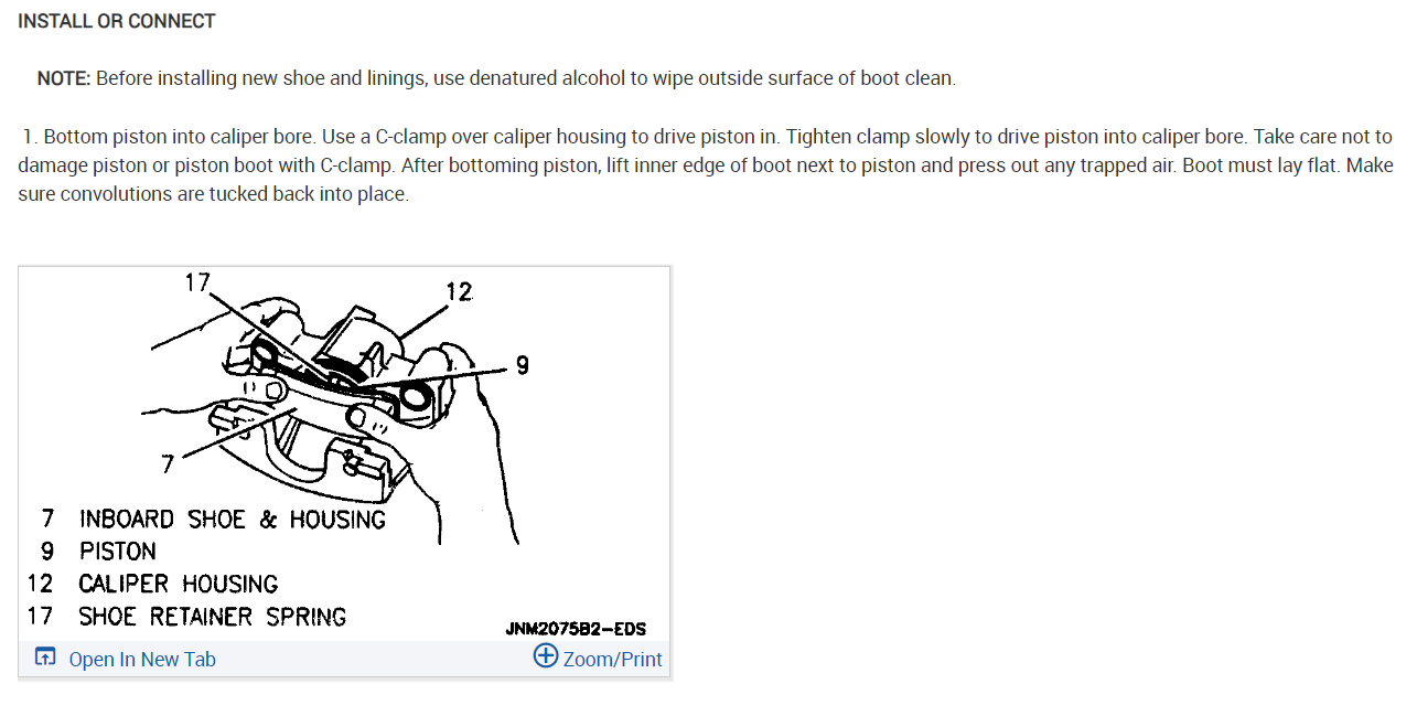

Hey, hope you can help... Lately while i drive (accelerate, coasting, or turning) I hear a high pitch fluttering squeaking sound... but it goes away when the brakes are applied at any pressure. Ive heard it could possibly be a belt, or calipers??? Would love some input before I take it in for repairs.

sounds like bad break pads,also check the rear pads or shoes.if this dont work,reply back.
Dec 14, 2007 at 4:50 AM
  • 55,238 POSTS

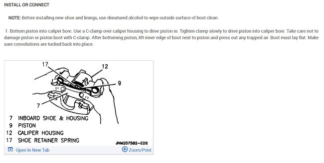

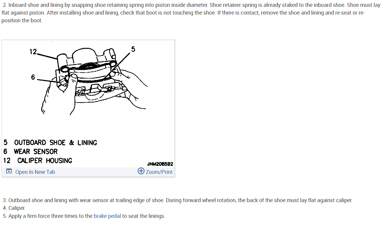

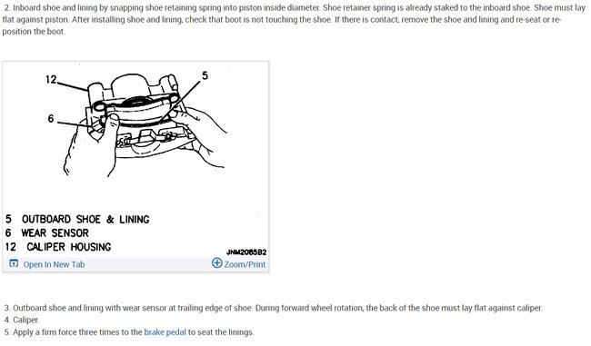

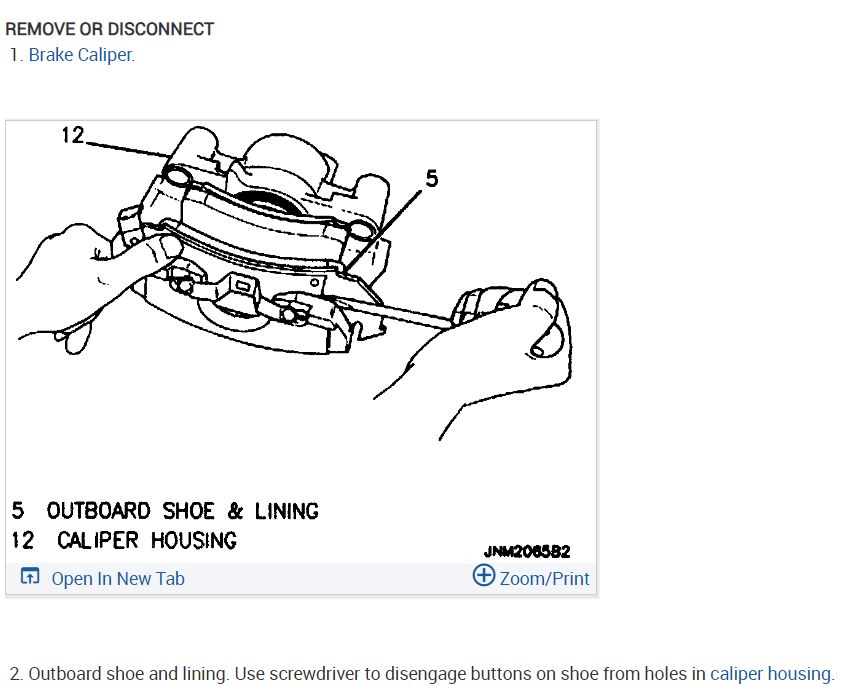

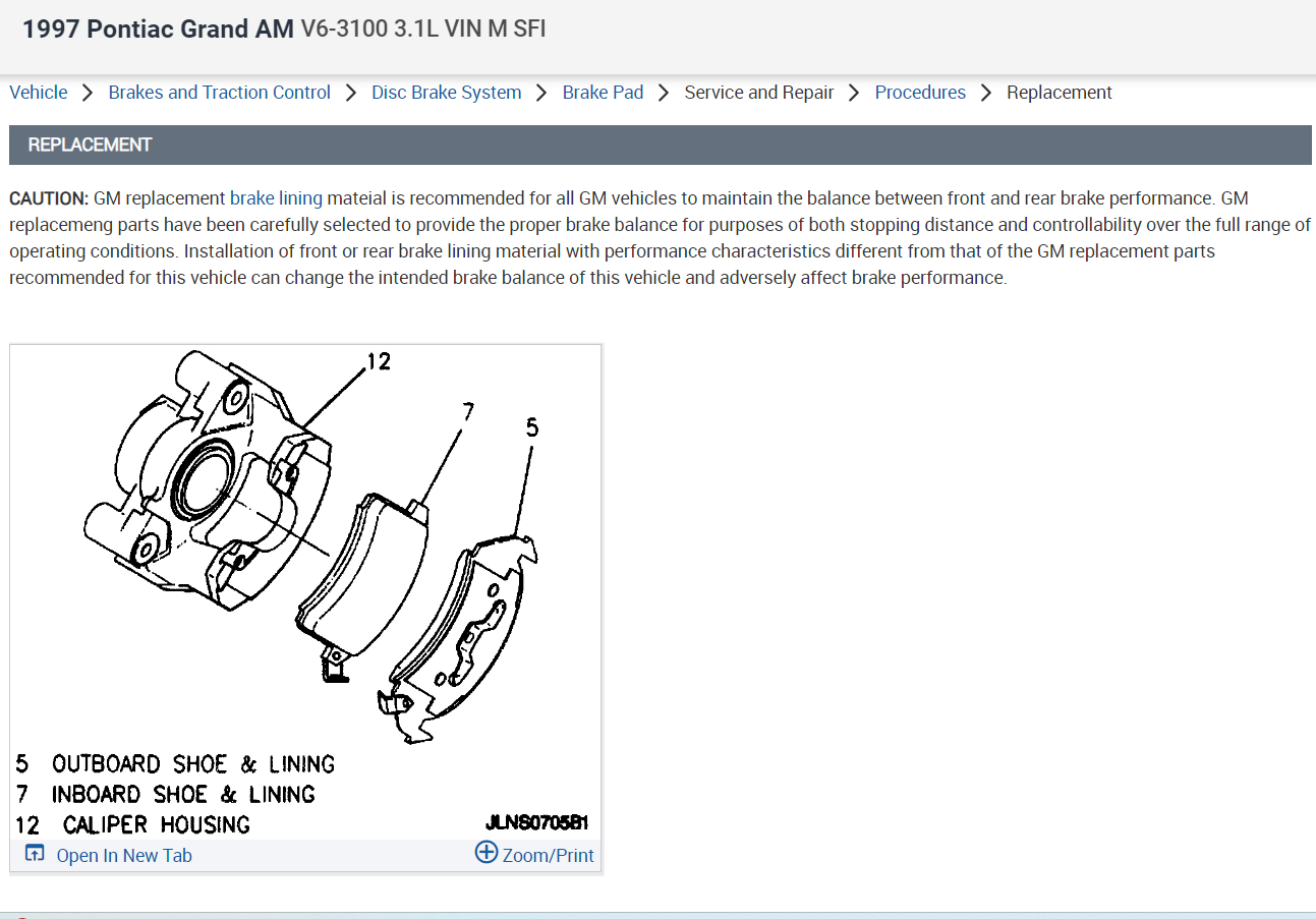

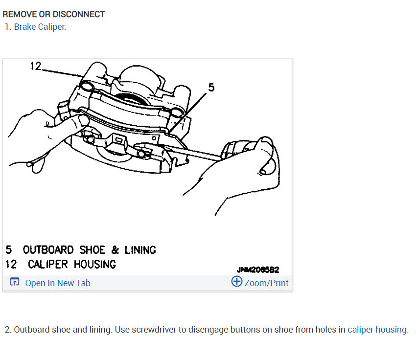

I agree with NDDUNC, it sounds like the brake pads are worn out I would check the front pads first. Here is a guide to help explain better.
https://www.2carpros.com/articles/brake-pad-symptoms
Here is how to do the front brake pads replacement on your car. Check out the images (below). Please let us know what happens.
