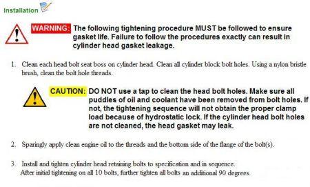

i need to know how to change head gasket for a 92 pontiac grand am.4 cyl. Quad ohc
