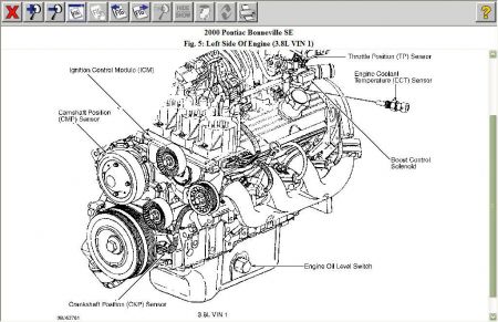

2000 Pontiac Bonneville SSEI, 78000 miles, 3,8 liter supercharged.
while driving the engine quits. Random event. Computer shows no fault codes, fuel pressure checked and fine. Battery voltage 14.4vdc.

Check the connections on the cam and crank sensors located below
https://images.2carpros.com/forum/automotive_pictures/12900_bonneville_cam_and_crank_sensors_1.jpg
