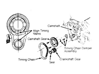

I have a 88 bonneville it was running fine, I come home and parked it went out the next morning and it would not start. The battery was dead, I charged it and it wont start.I changed the crank sensor because that went last time, it still will not start. There is lots of spark, and there is fuel coming up to the rails, could it be the cam sensor? Also does it have a timing chain and where is it located.

If you are getting good spark, the cam sensor should be fine. Has the check engine light come on? Have you checked fuel pump pressure? Have you checked the for a pulse to the injectors?
Also, your car has a timing chain. Here is a picture of the chain and the timing marks.

The car has good fuel pressure, the check engine light did come on at all. We checked the pulse for the injectors too. It still wont start.I am going to check the timming chain to see if it jumped time. Is ther anything else I can do?

If you have spark and fuel, the only things left are timing and compression. Let me know what you find with the timing. If it's good, then we need to check the compression.

Thanks for all your help. The camshaft gear was broke the car runs good now. It great to have people like you to help.
