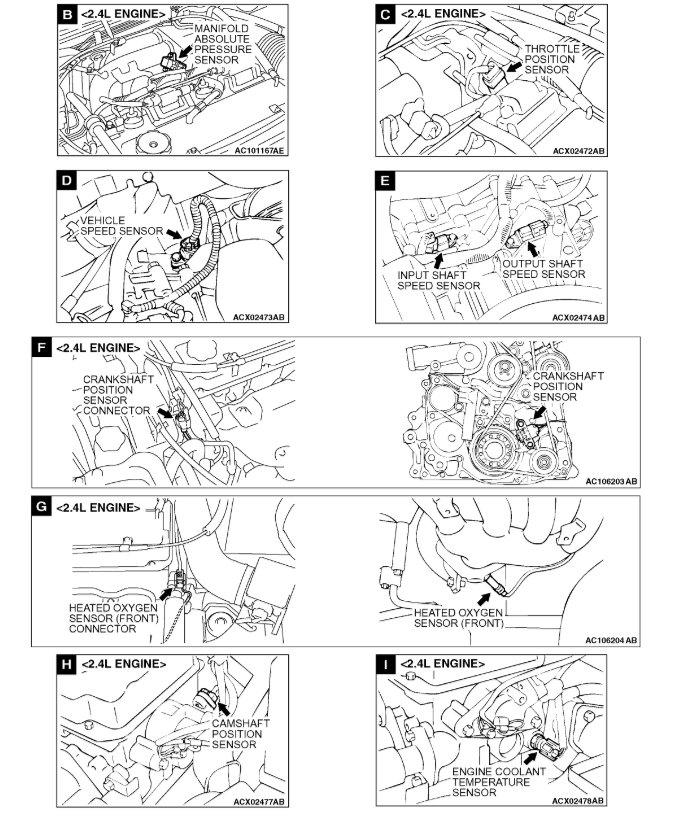

Car is randomly misfiring, idles rough, but drives okay at normal speeds. Do you know if this car has a known issue with this code p0 300? I have replaced plugs, wires, and air filter. Can the air intake throw this code? Or coils throttle body or crank shaft sensor?

This can be caused by low fuel pressure or a bad MAP sensor. Here is a guide to help you check the fuel pressure and a diagrams below to show you where the MAP in the diagrams below. Also I would service the throttle bore as well.
and
