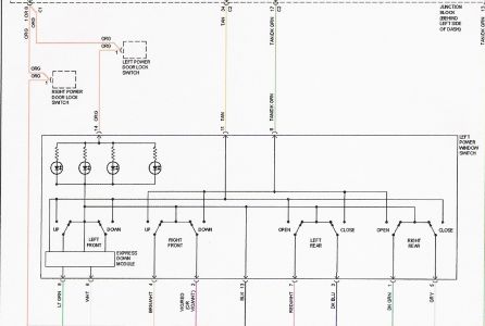

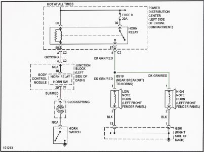

I bought this van a few weeks ago. When i bought it the horn didnt work from the steering wheel but it did from the remote. As well as that, the airbag light is always on, so I'm wondering if that has something to do with the horn not working, if maybe something could be wrong in the steering wheel. My other new problem, is my windows just quit working. then they worked again, and now they dont. I got mad, and hit my door and then they worked, Could it be a relay?? If so, where would I find it? Thanks

Ok the window's will probably be either a bad wire or a window motor or switch. The horn might be the horn button itself or a wire. As for the air bag light would need to scan and get codes to help you with that. If you have a digital volt meter and can do some testing I will get you a wiring diagram of the horn and power window circuit and try to help you through it. Let me what you would like to do and I will try to help.

Ok here you go. The first will be of the window circuit and the other of the horn. You may need to save pic and magnify it with windows pic ok. Window wiring
https://images.2carpros.com/forum/automotive_pictures/249564_window_wiring_1.jpg
Horn wiring
https://images.2carpros.com/forum/automotive_pictures/249564_Horn_wiring_1.jpg
