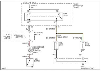

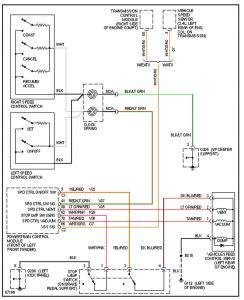

I have a 97 plymouth voyager: 216k miles and a 3.0 litre v6 engine. The steering wheel controls (cruise controls and horn) stopped working recently. I tried checking te fuses and they were all good. Do any of you guys know what could be causing this problem?
Thanks.
Sep 2, 2007 at 12:09 PM
SERVICE WRITER
  • 9,123 POSTS
The common demnominator on those circuits are the clock spring in the steering column.
