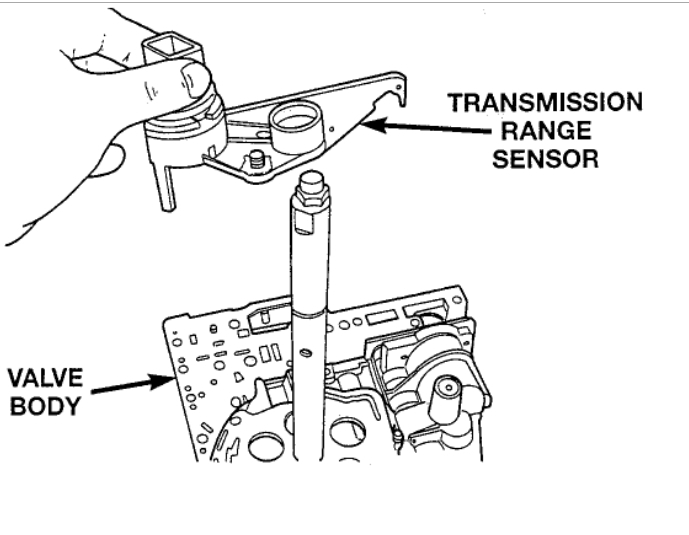

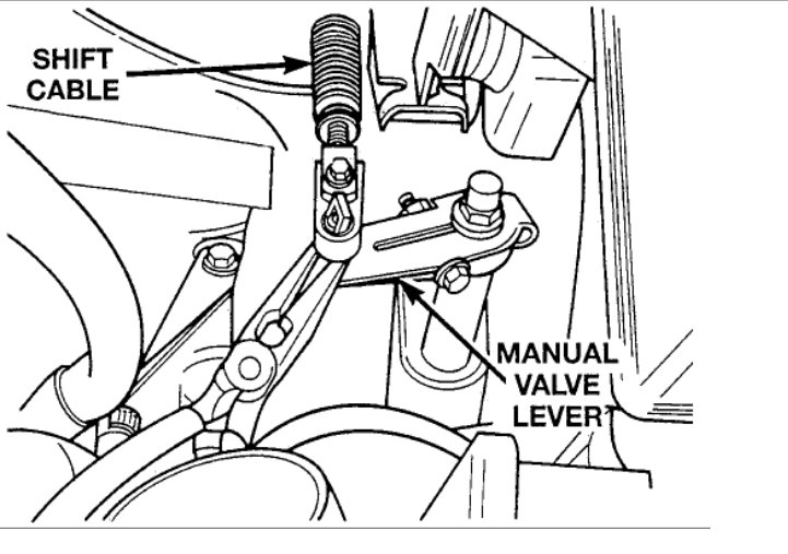

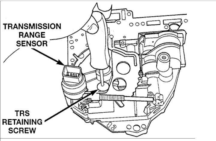

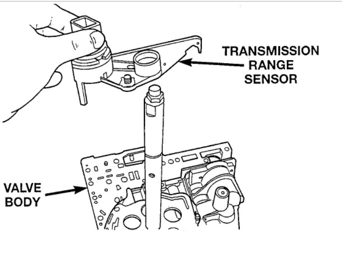

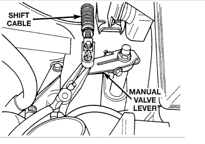

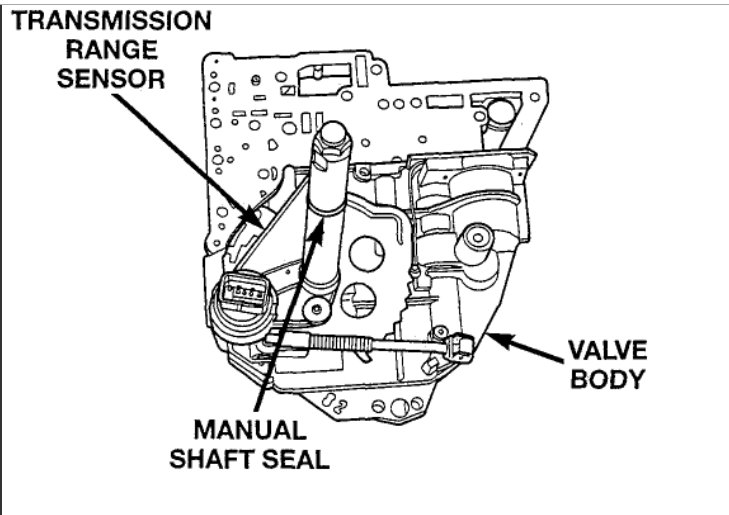

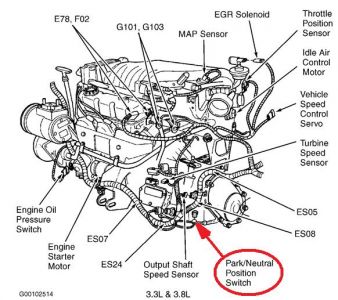

I have searched for days and even called the dealer parts shop trying to determine the difference between:
a) a park/neutral position switch
b) a transmission range sensor
c) a neutral safety switch.
I got a code P1899 on my Plymouth Grand Voyager Espresso w/ 3.3 L engine. 4 speed automatic(or at least I believe it's a 4 speed. Indicator shows PRND3L).
Is there a difference between these parts? Also, given the code P1899, which should I replace. The dealer parts shop nor the local Autozone could confirm which part I need. Help!!!
If the vehicle doesn't have either; then, what would code P1899 mean? The shift indicators are flashing and the trip as well as the trac off lights are coming on.
May 14, 2010 at 11:08 AM
  • 55,267 POSTS
This transmission range sensor is the neutral safety switch all wrapped up into one. Here is a guide on how to service the transmission and replace the sensor (Below)
Please let us know what happens so it will help others.

4 or 6 cyl engine- On left side of transaxle, behind PRNDL switch.

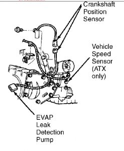

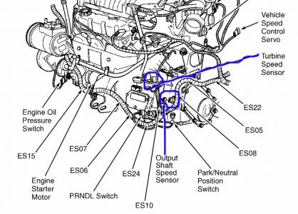

Transmission problem
1996 Plymouth Voyager 6 cyl Front Wheel Drive Automatic 255512 miles
where do i find the input speed sensor on a 96 voyager with a 3 speed automatic transmission according to manual the input is on the front side above neutral switch, and theres nothing there.

OBXAUTOMEDIC
  • 3,711 POSTS
Hello, Here is a diagram.
https://images.2carpros.com/forum/automotive_pictures/188069_96voyagerturbineandoutput_1.jpg

AUSTINANDCOMPANY
  • 5 POSTS
that is a picture of a trans with 4speed auto, my 3 speed auto on the front only has the neutral saftey switch and the lock up switch located directly behind the fill tube, the reason i'm looking for one is i've replaced the out put speed sensor and still have speed sensor failure code not sure the 3 speed even has one.

OBXAUTOMEDIC
  • 3,711 POSTS
Sorry for delay in responding... Ok, I take it you have cleared the code after replacing the sensor. Have you look on the fire wall side on top of the axle housing for the Speed sensor? Here is a diagram...

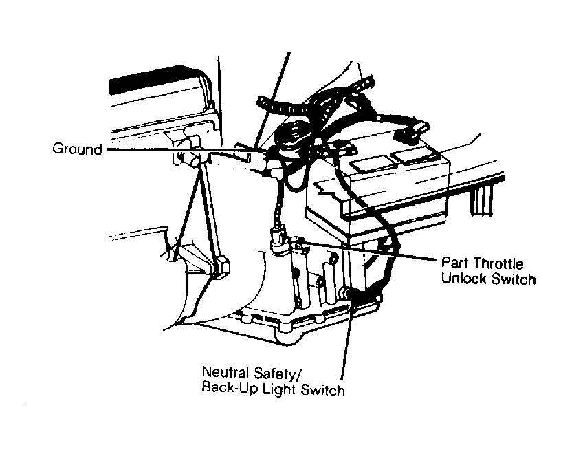

RUBYGIRL1630
1997 Plymouth Voyager Automatic
where is the neutral safety switch in a 1997 plymouth voyager
Oct 6, 2017 at 10:52 AM (Merged)
BLUELIGHTNIN6
  • 16,542 POSTS
park/neutral position (PNP) switch is located on the transmission. .
https://images.2carpros.com/forum/automotive_pictures/261618_Noname_2614.jpg
