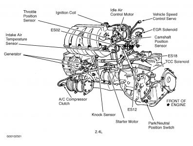

1996 Plymouth Voyager 6 cyl Two Wheel Drive Automatic
how do you replace a neutral safety switch?
or where exactly is it located?

Park/Neutral Signal The Park/Neutral Position (PNP) switch on the transaxle provides an input signal to Powertrain Control Module (PCM), indicating when transaxle is in Park, Neutral or if a drive gear is selected. The PCM uses input signal to determine idle speed and ignition timing. Park/Neutral Position Switch (2.4L)On transmission. See Fig. 3
https://images.2carpros.com/forum/automotive_pictures/266999_3_1.jpg
Park/Neutral Position Switch (3.0L)On transmission. See Fig. 6 .
https://images.2carpros.com/forum/automotive_pictures/266999_6_1.jpg
Park/Neutral Position Switch (3.3L)On transmission. See Fig. 10 . Park/Neutral Position Switch (3.8L)On transmission. See Fig. 10 .
https://images.2carpros.com/forum/automotive_pictures/266999_10_1.jpg
