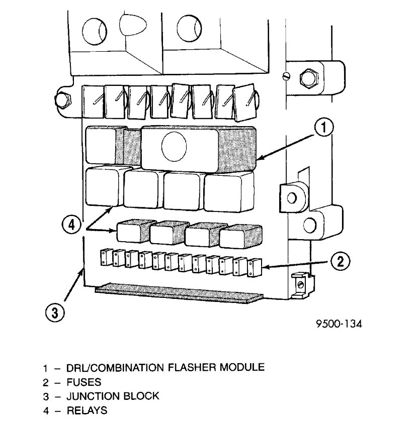

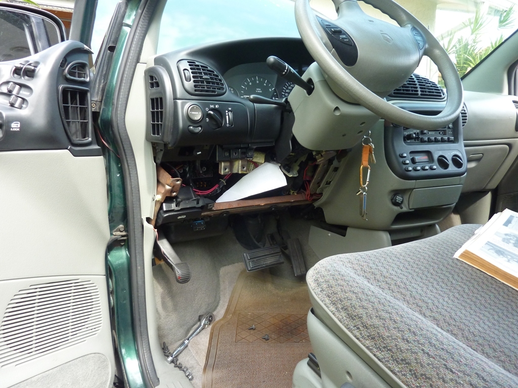

This is common when the combination flasher goes out here is how to replace it which is easy because it self initializes. Check out the diagrams (Below). Please let us know what happens.
REMOVAL
1. Remove lower steering column cover.
2. Remove knee blocker.
3. Pull combination flasher from junction block.
INSTALLATION
- For Installation, reverse the above procedures.

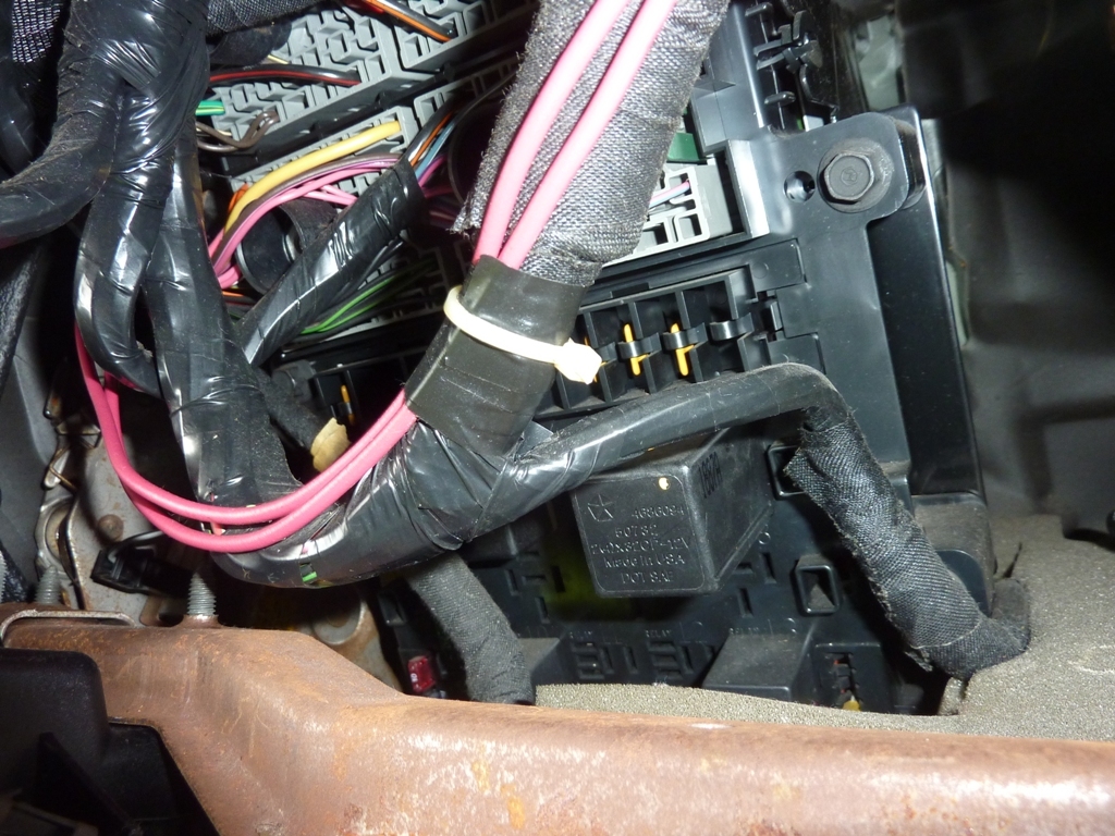

For spiel1, I would still look to see if the flasher is drooping in its socket, especially after the opening-the-hood comment.

K-VERSA
caradiodoc is right. the electronic flasher assembly. It is a relatively expensive and heavy unit. The weight can cause it to partially unplug from the socket.
The same model/year car, identical problem with intermittent disruption of the turning lights operation (bulbs, wiring, switch excluded as the cause). Removed the unit, inspected the electronic assembly under the cap - okay. Slightly twisted the contact blades before plugging the unit snugly back. Turning light flashing operation resumed okay.
