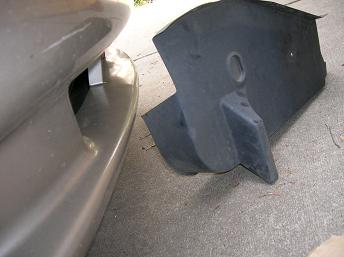

(Thanks to freeengineinfo for the pictures) This plastic engine guard is located under the passenger side and will need to be removed to access the air conditioning.

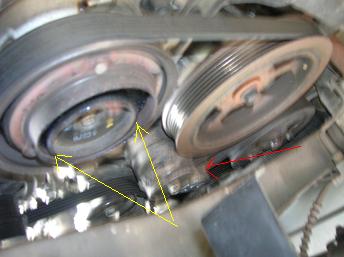

The arrow points to the idle tensioner. The tensioner is generally loosened by rotating the piece with a ratchet or socket, but there isn't enough room to get at this spot. Luckily located at the back of the belt tensioner is a block that an adjustable wrench fits on. Just rotate then slide the belt off the tensioner wheel.
https://images.2carpros.com/forum/automotive_pictures/435113_2_1.jpg

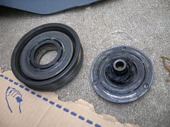

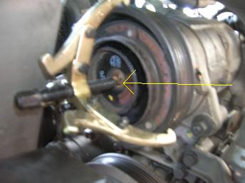

This three jaw puller can be used to remove this pulley, first you will need to loosen the bolt located in the center of the pulley. As the pulley works out farther it will eventually pull out far enough to tighten up against the center bolt. As it comes out farther you will need to use a longer bolt until it comes off. Before you remove the pulley remove the center piece first and refer to the picture two spaces below.
https://images.2carpros.com/forum/automotive_pictures/435113_3_1.jpg
https://images.2carpros.com/forum/automotive_pictures/435113_4_1.jpg

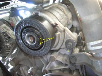

The two arrows point to the cir-clip that will need to be removed for the bearing to come off. If you don't remove it first you have what happened here. From this picture you see that the clip will still need to be removed, which includes reinstalling and uninstalling the pulley again for it to come off.

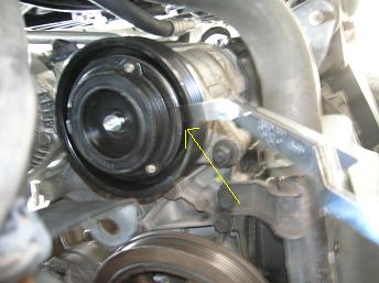

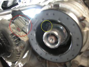

Here is the ac clutch coil which can be removed by the cir-clip shown by the center yellow circle. The plug for the ac clutch is shown in the red, the little orange clip will need to come out before the electrical connection will pull apart.

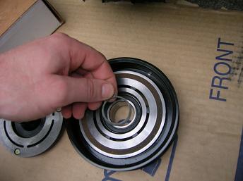

Here are the new parts including the new cir-clip held in my hand. The beveled cir-clip edge must face outward. Always verify that the cir-clip is in the groove by rotating it in the groove.
