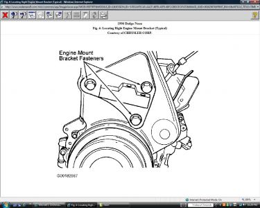

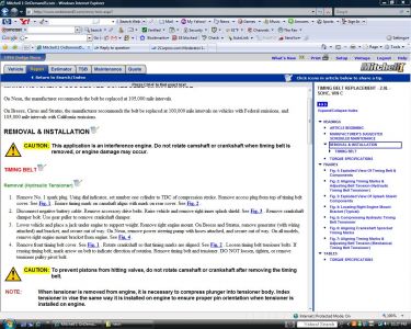

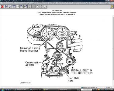

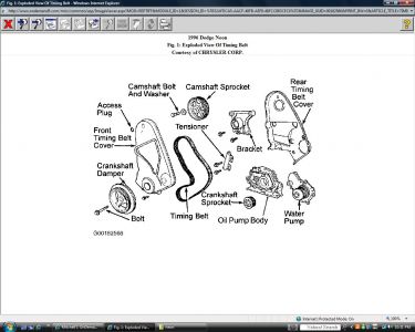

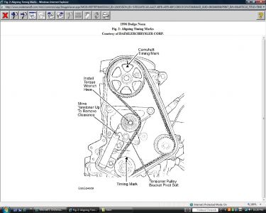

heres how to check timing on sohc and dohc
https://images.2carpros.com/forum/automotive_pictures/52960_Untitled2_1.jpg
https://images.2carpros.com/forum/automotive_pictures/52960_Untitled1_1.jpg
https://images.2carpros.com/forum/automotive_pictures/52960_Untitled3_1.jpg
https://images.2carpros.com/forum/automotive_pictures/52960_Untitled4_1.jpg
This is for the dohc
https://images.2carpros.com/forum/automotive_pictures/52960_Untitled_1.jpg
