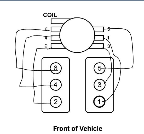

I changed the plugs, the wires, distributor rotor and cap and it still has a little miss to it. and it is backfiring.

First, is it backfiring from the exhaust or intake? Also, are you certain you have the plug wires installed in the correct firing order? Have you pulled diagnostic trouble codes so we know which cylinder is misfiring?

A lot of times, a backfire can be caused by fuel pressure, a vacuum leak, or ignition timing. Based on the mileage, I don't suspect any internal engine problems, but anything is possible.

I attached a pic of the firing order to help confirm the plug wires are going to the correct plugs. Sorry about the sad looking plug wires. I tried. LOL
Let me know if any of this helps or if you have other questions.
