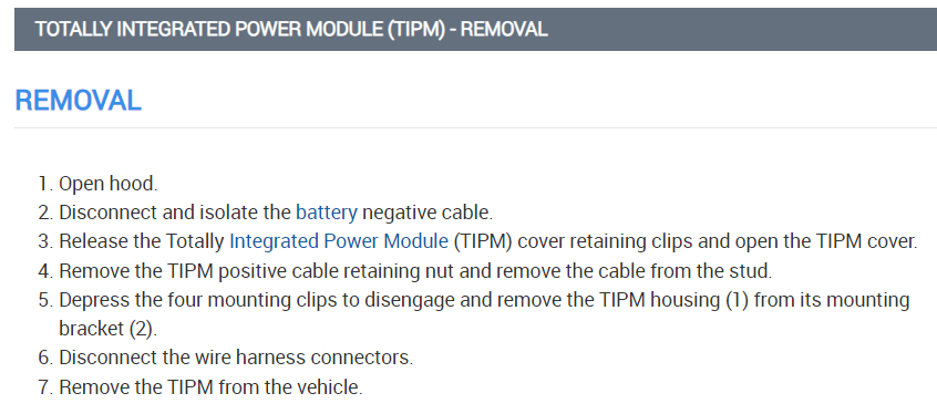

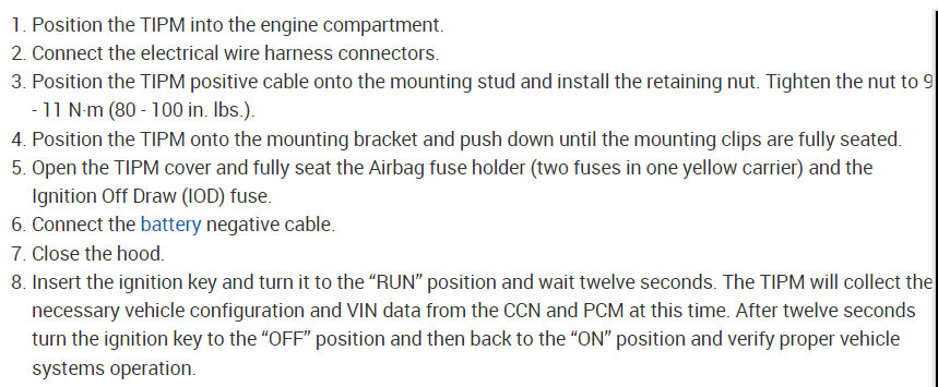

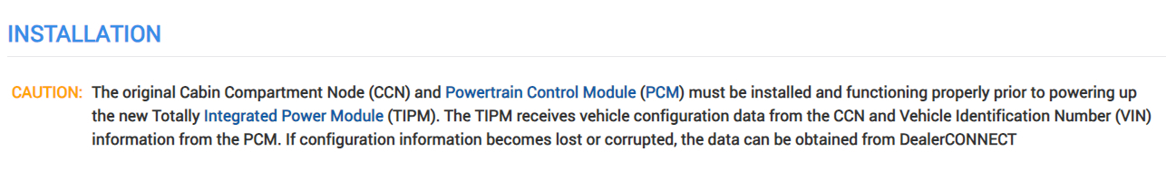

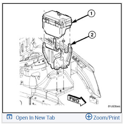

Yep, this is a common problem with these vans, the TIPM is probably going out, but I would check the battery terminals to make sure they are clean and tight. The system may have a trouble code that can help confirm the problem, you will need to do a CAN scan. You can get a CAN scanner (Controller Area Network) which will work on most cars from Amazon.
https://youtu.be/u-4syLc-ifQ
Here is how to do the TIPM replacement which I would get new from the dealer, it is easy to replace because itself learns. Check out the images (below). Please let us know what happens.
