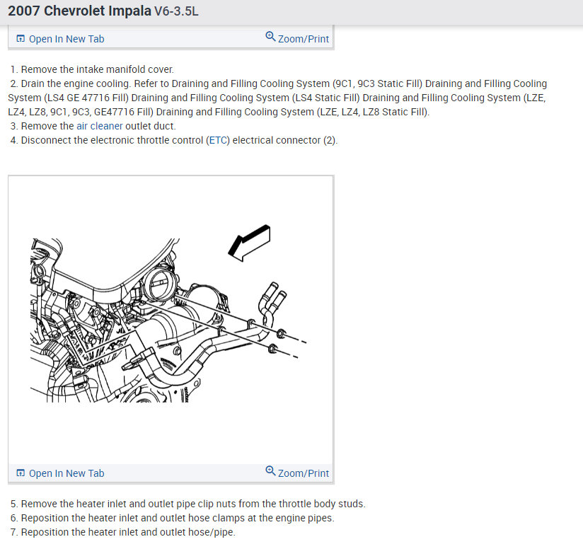

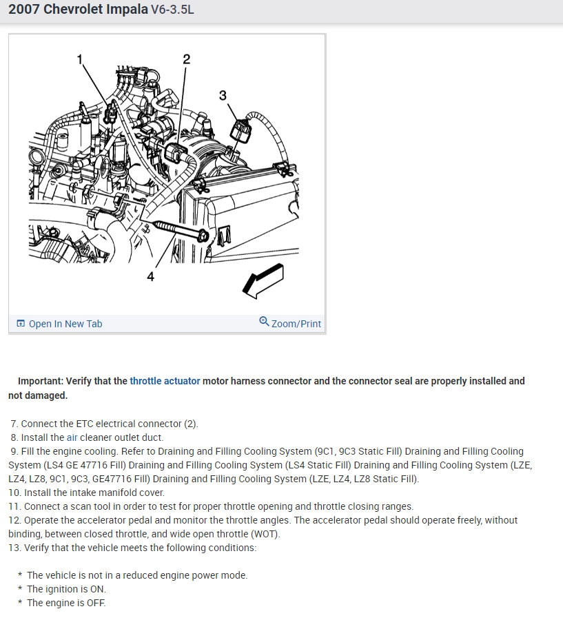

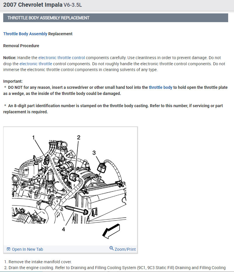

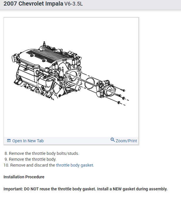

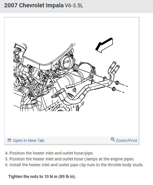

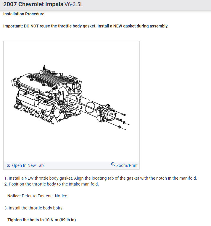

The vehicle can go to the low power mode when it there is an issue with the engine management system.
The most common reason for a lower power mode to be triggered is a dirty throttle actuator.
Inspect the actuator and clean if necessary. Typically cleaning it out will fix the issue.
https://www.2carpros.com/articles/reduced-power-limp-mode
You mentioned that AutoZone cannot pull any codes. However is your check engine light on?
Here is a guide of how to clean the actuator:

The butterfly part seems to have a crack in it. Does it need a new one? Or will this one still work?
Sep 21, 2021 at 10:57 PM
SQM
  • 6,383 POSTS
It is a good chance that is the issue. Can you upload picture?
