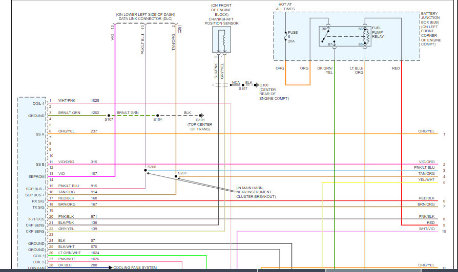

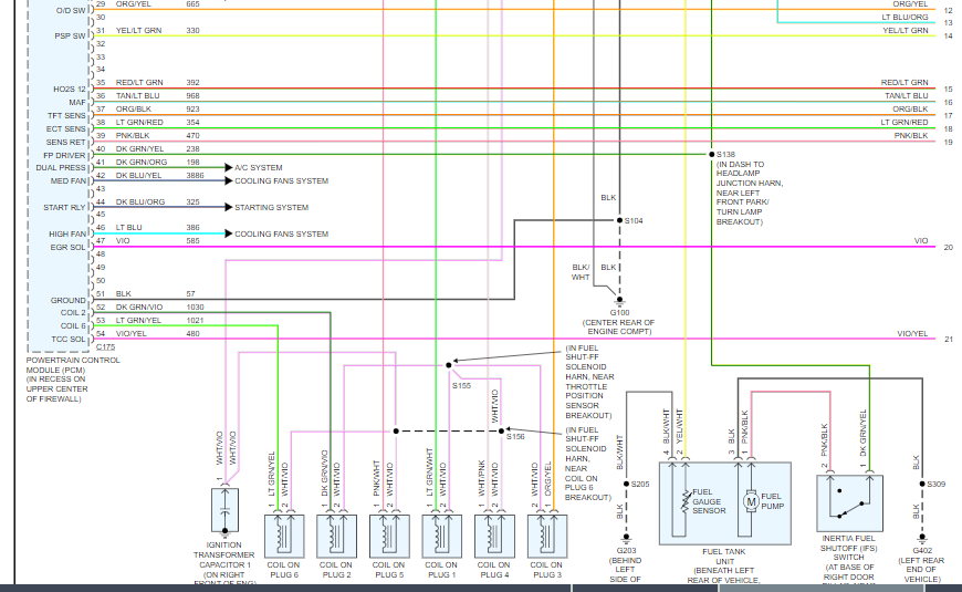

I am trying to determine if there is an open circuit on the ground from HO2 sensor (bank1 sensor 1) to the PCM.
Saturday, November 2nd, 2019 AT 12:29 PM

What I am looking for is a pinout chart to identify the correct pin connecting the ground from the harness connector for the HO2 sensor, bank1, sensor 1 to the PCM.

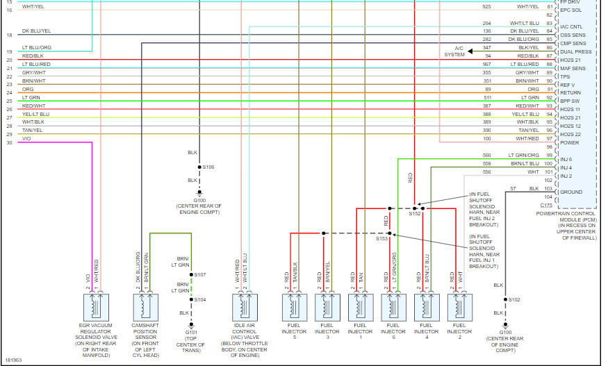

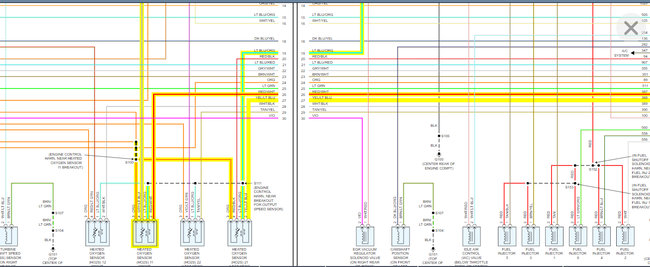

Good afternoon,
I attached the diagram for the sensor. There is not external ground. The PCM is what controls the returns.
There is a power wire from the fuse box for the heater. The light blue/orange wire is the 12 volt feed.
+1
Saturday, November 2nd, 2019 AT 1:35 PM
  • 52,797 POSTS

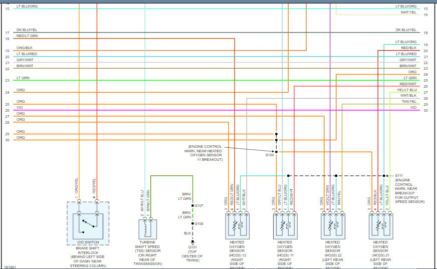

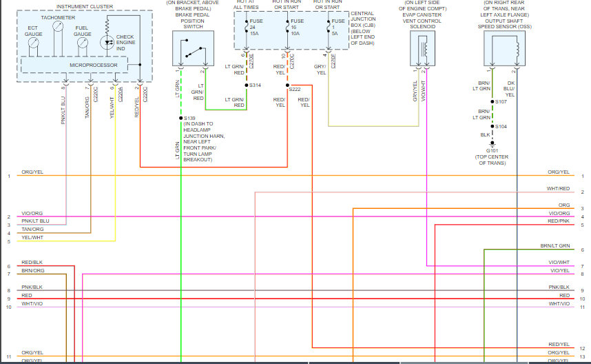

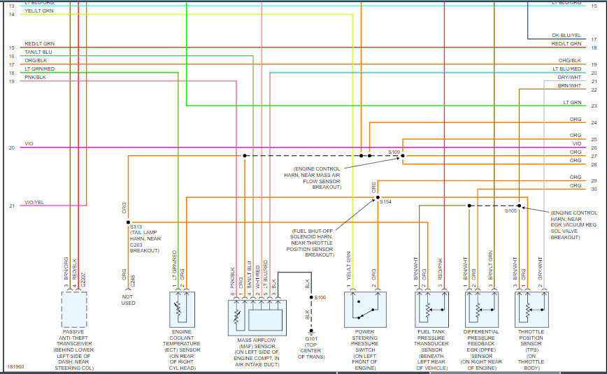

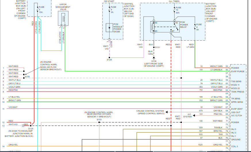

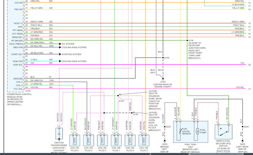

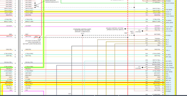

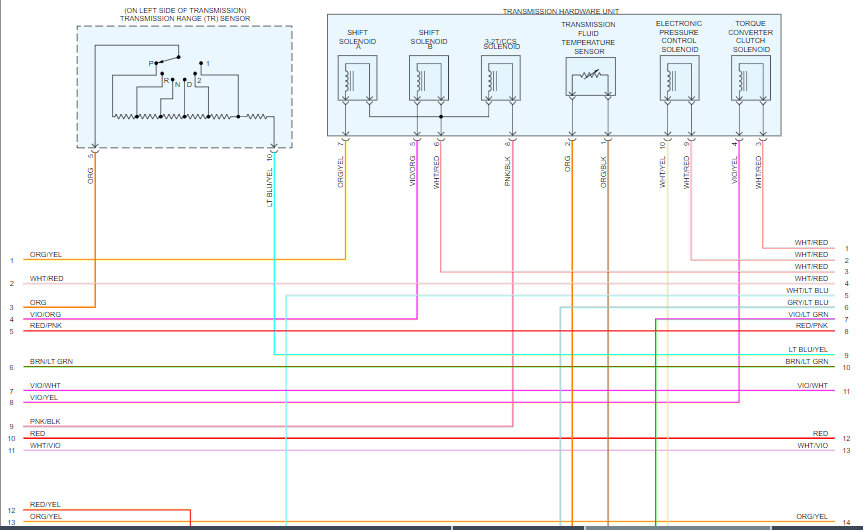

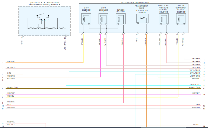

The rest of the diagrams.

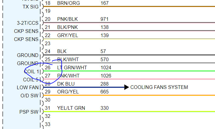

This was very helpful, although what I was looking for was a pin diagram where the harness connection to the PCM is located so I can identify the pin no.26.
-1
Saturday, November 2nd, 2019 AT 2:00 PM
  • 52,797 POSTS
Pin 26 is for the ignition coil, not the O2 sensor.
Can we start with the original issue and the code?
Saturday, November 2nd, 2019 AT 2:03 PM
DMCMULLIN
  • 10 POSTS

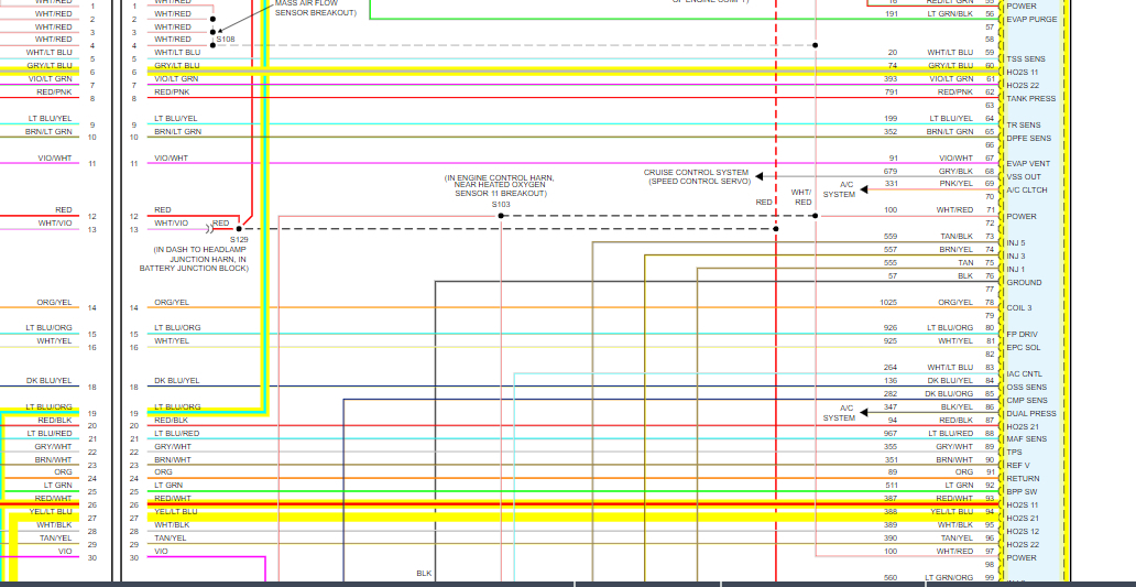

I am trying to determine if the ground (red/white wire) from the HO2-11 sensor to the PCM is an open circuit. To do this, I need to know where the pin location (or socket hole) on the harness is located. From your diagrams, I have determined the pin as no. 26.
Saturday, November 2nd, 2019 AT 2:22 PM
  • 52,797 POSTS
In the response with the 2 diagrams, The red/white wire goes to pin 93. It does not go to pin 26.

You are correct. The no. 26 must be at a junction. So, is there a chart showing the pin locations on either the harness connection or the PCM?
Saturday, November 2nd, 2019 AT 2:32 PM
  • 52,797 POSTS
All the pins are in the diagrams I sent you.
26 has nothing to do with your checks.

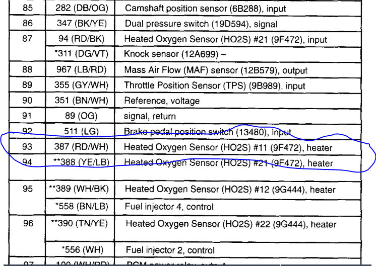

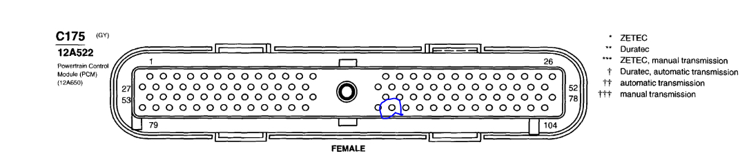

Can you help me physically locate pin no.93? I would be looking at either the harness (pin holes) or the PCM (pins)?
Saturday, November 2nd, 2019 AT 2:45 PM
  • 52,797 POSTS
Take a look at these.

Thank you very much. I assume "female" is looking at the PCM (pins).
Saturday, November 2nd, 2019 AT 3:08 PM
  • 52,797 POSTS
That is the harness side.

I have checked both the power side and ground side of the heater sensor. I have power but, no ground. I checked for continuity of the wire (red/white) from the sensor to the PCM and it is good. It seems that the PCM is not providing the ground. Does this mean that I need to replace the PCM?
Tuesday, November 5th, 2019 AT 8:50 AM
  • 52,797 POSTS
That is exactly what it sounds like.
