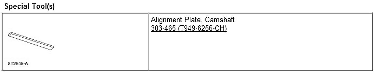

Special Tools

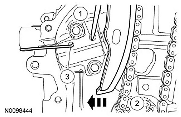

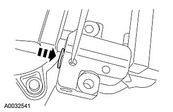

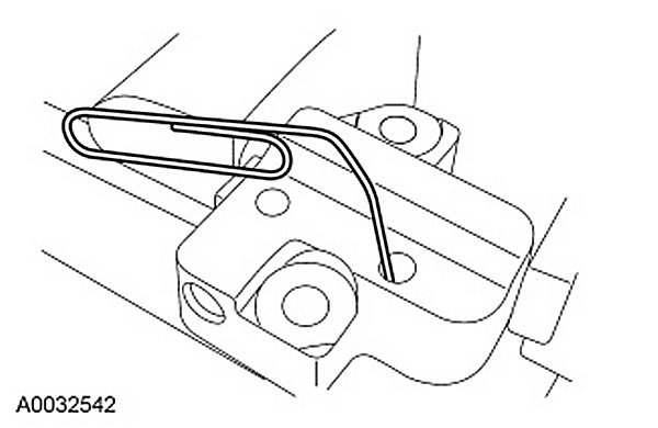

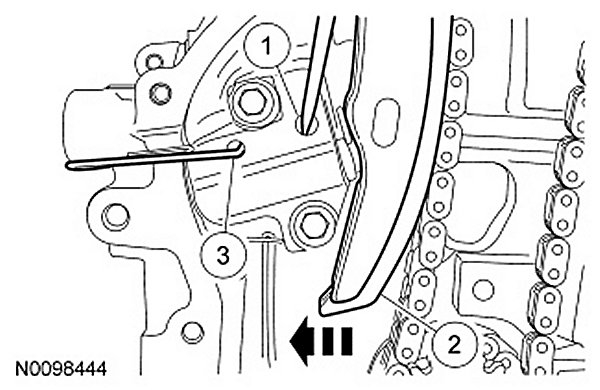

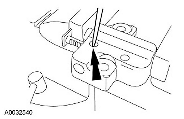

2. Compress the timing chain tensioner in the following sequence.
1. Using a small pick, release and hold the ratchet mechanism.
2. While holding the ratchet mechanism in the released position, compress the tensioner by pushing the timing chain arm toward the tensioner.
3. Insert a paper clip into the hole to retain the tensioner.
pic 3

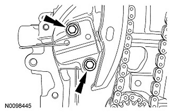

3. Remove the 2 bolts and the timing chain tensioner.

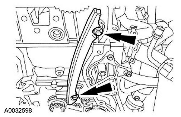

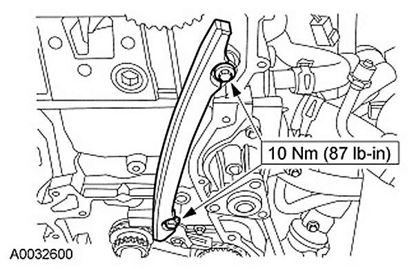

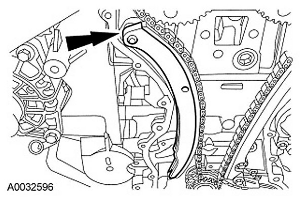

4. Remove the RH timing chain guide.
pic 5

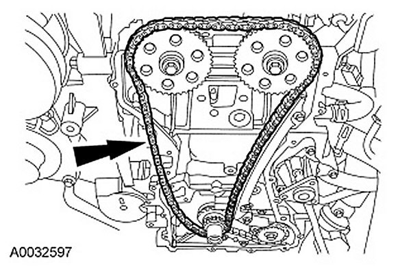

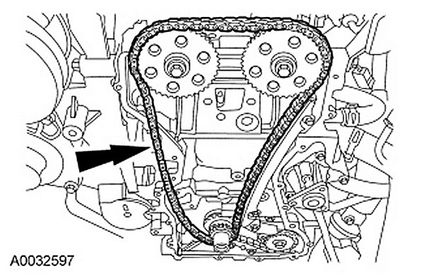

5. Remove the timing chain.
pic 6

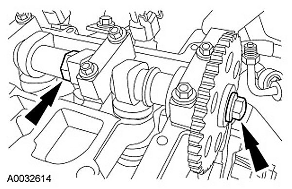

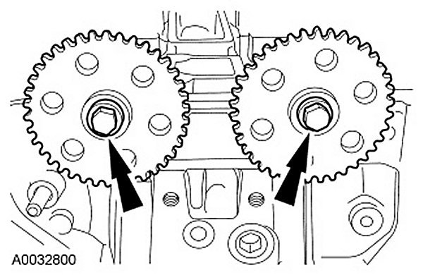

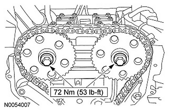

7. NOTICE: Do not rely on the Camshaft Alignment Plate to prevent camshaft rotation. Damage to the tool or the camshaft can occur.
If necessary, remove the bolts and the camshaft sprockets.
^ Use the flats on the camshaft to prevent camshaft rotation.

1. Remove the special tool.

2. NOTICE: Do not rotate the camshafts. Damage to the valves and pistons can occur.
If the camshaft sprockets were not removed, use the flats on the camshafts to prevent camshaft rotation and loosen the sprocket bolts.
pic 10
3. If removed, install the camshaft sprockets and the bolts. Do not tighten the bolts at this time.

5. Install the timing chain.

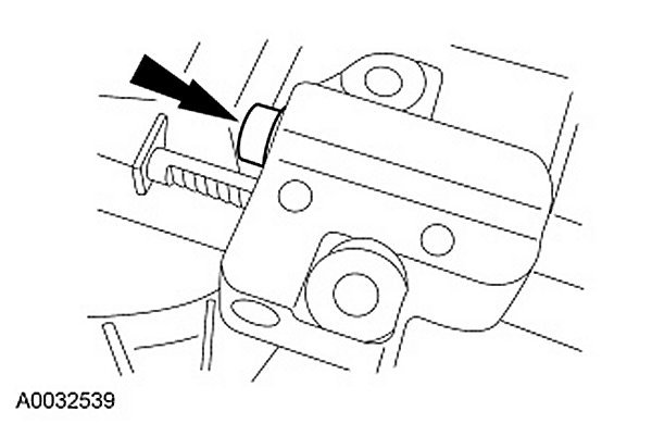

NOTE: If the timing chain plunger and ratchet assembly are not pinned in the compressed position, follow the next 4 steps.
pic 14
7. NOTICE: Do not compress the ratchet assembly. This will damage the ratchet assembly.
Using the edge of a vise, compress the timing chain tensioner plunger.
pic 15
8. Using a small pick, push back and hold the ratchet mechanism.
pic 16
9. While holding the ratchet mechanism, push the ratchet arm back into the tensioner housing.
pic 17
10. Install a paper clip into the hole in the tensioner housing to hold the ratchet assembly and the plunger in during installation.
pic 18

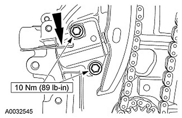

11. Install the timing chain tension and the bolts. Remove the paper clip to release the piston.

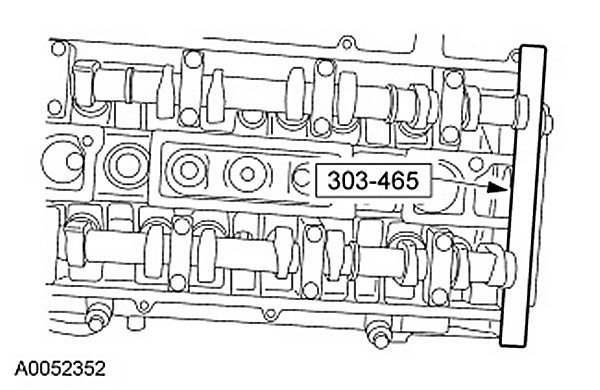

12. Install the special tool.
pic 20
