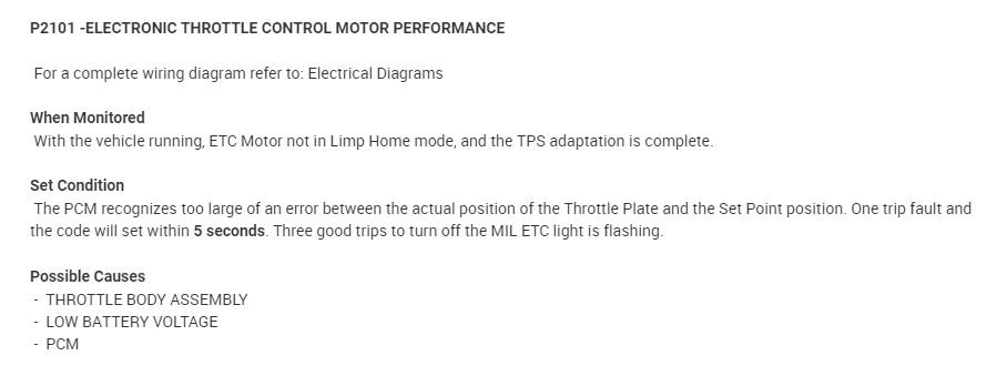

Okay, I attached the information for the codes below. You should have more information on the 2101 from previous posts.

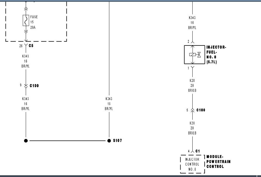

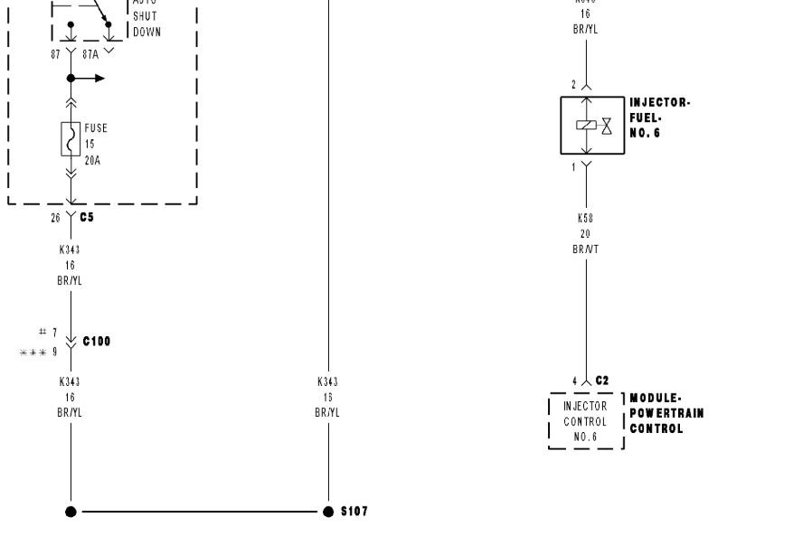

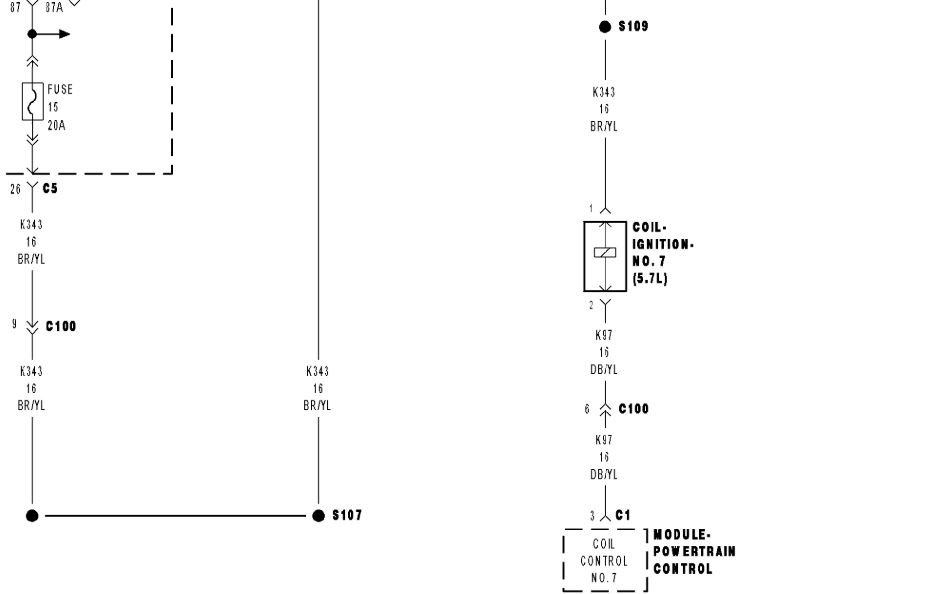

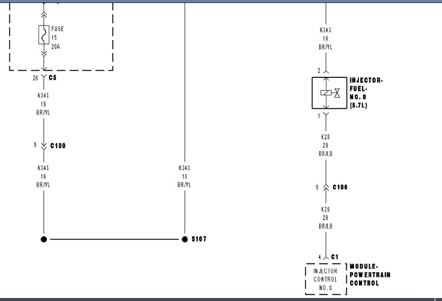

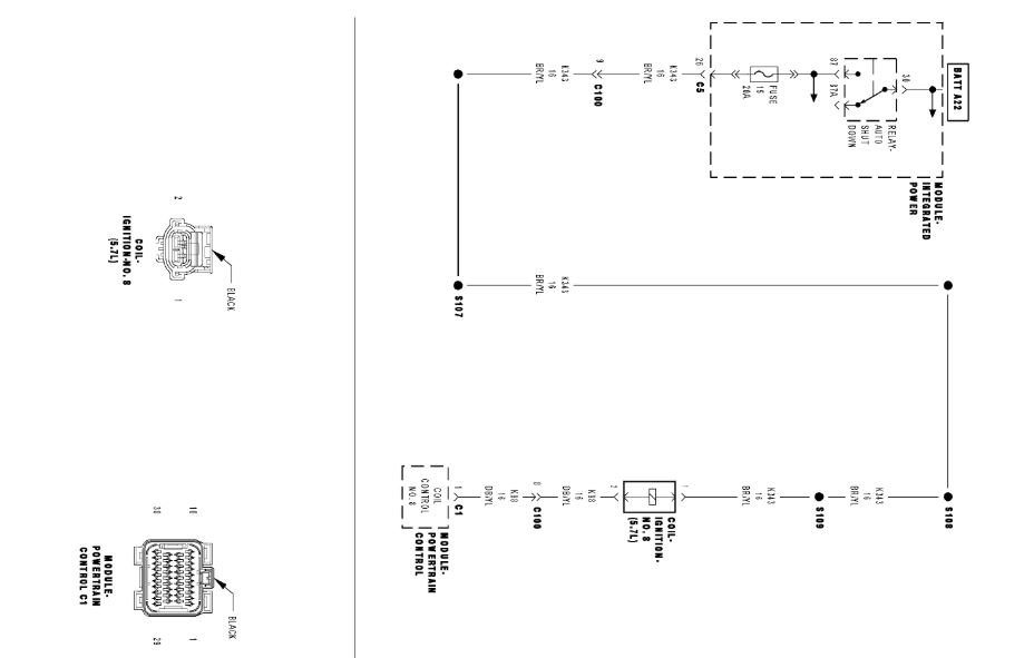

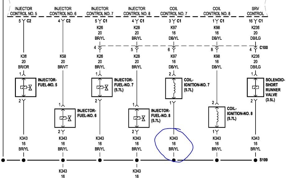

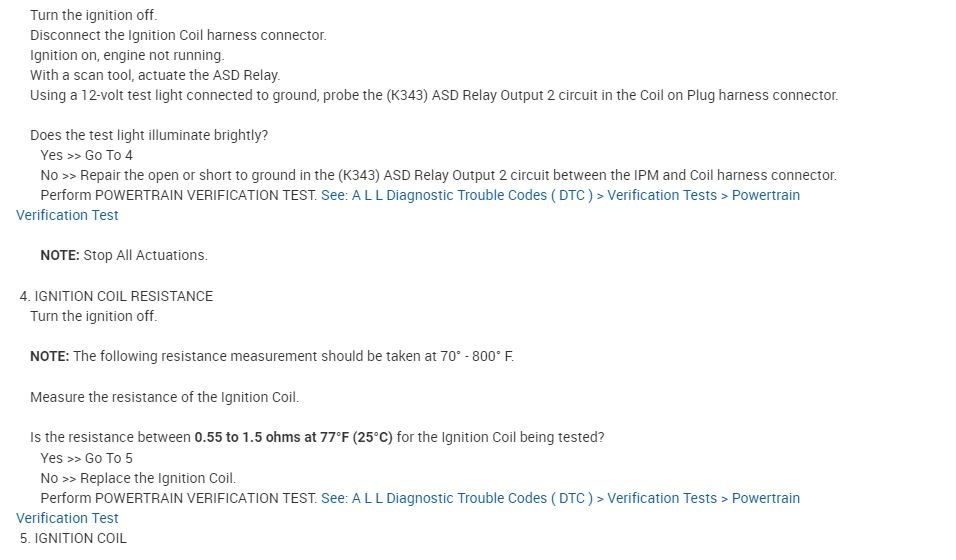

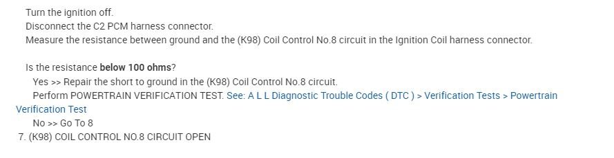

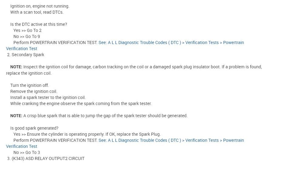

I'm back well number 5 coil pack has no juice ??
Mar 19, 2020 at 2:31 PM
Do all the other coils have power to the same color wire?
Mar 19, 2020 at 9:34 PM
AGNUS
  • 37 POSTS
They all work but that 1.
Mar 20, 2020 at 5:40 AM
You have a wiring issue at that 1 coil. One wire feeds all the coils there power. they each have a return voltage to the PCM.
Take a close look at the harness.
Mar 20, 2020 at 5:42 AM
AGNUS
  • 37 POSTS
One is brown/yellow and black/yellow each pig Tail has only 1 brown/yellow and 1 black/yellow except the black pig tail it has 3 or 4 I believe.
Mar 20, 2020 at 6:43 AM
Look at another coil and see which one has voltage with the connector disconnected.
Mar 20, 2020 at 7:07 AM
I attached another diagram that is clearer. I circled the wire that should have battery voltage with the key on.
Mar 20, 2020 at 7:10 AM
