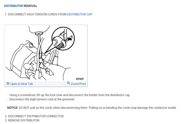

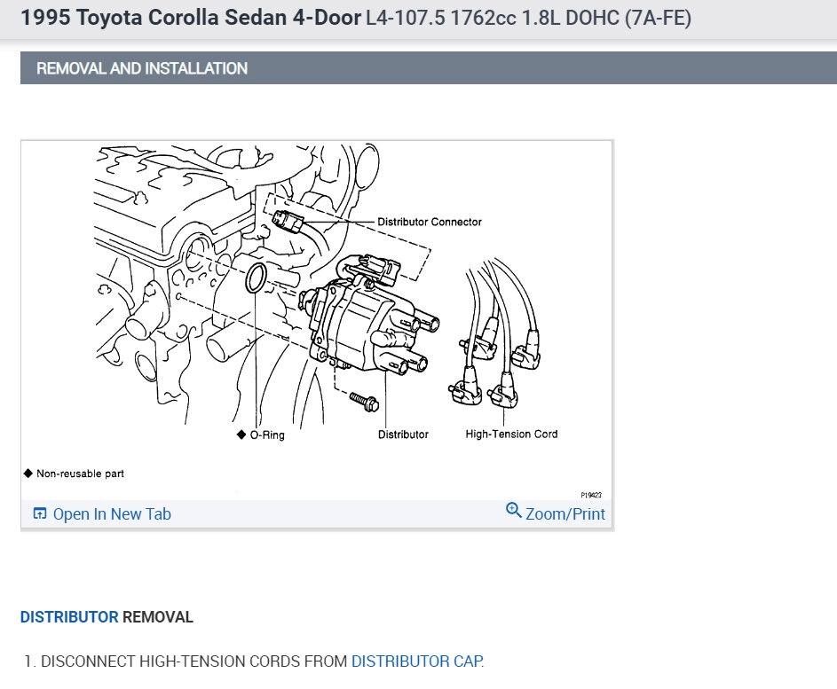

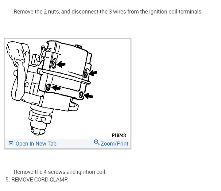

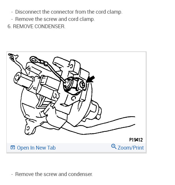

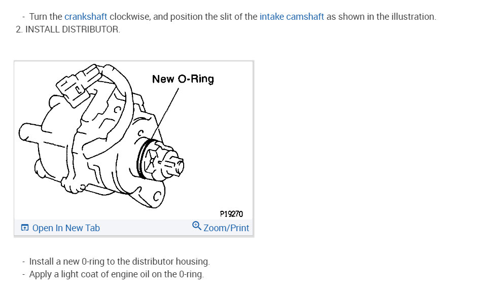

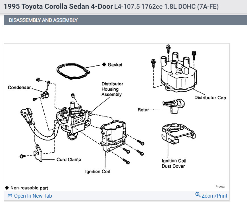

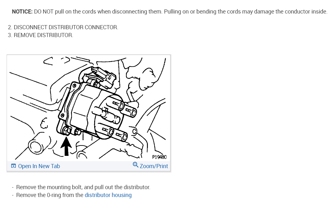

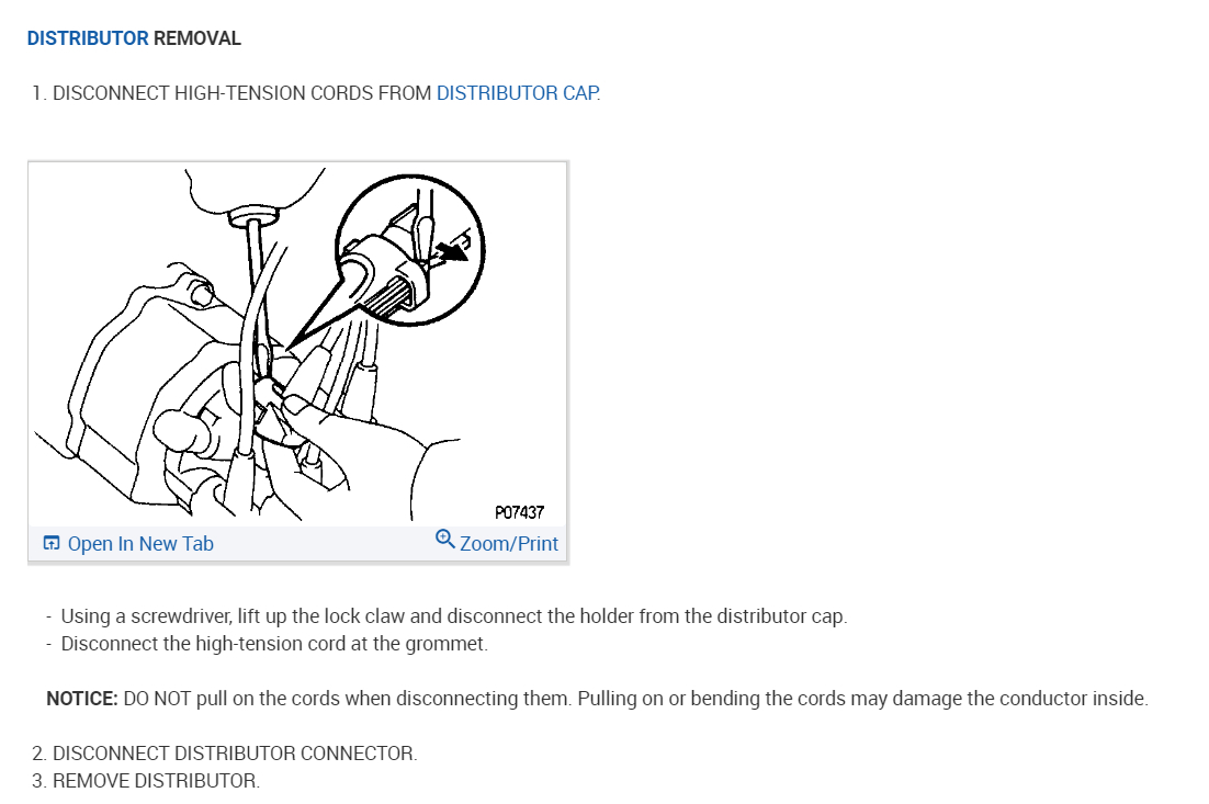

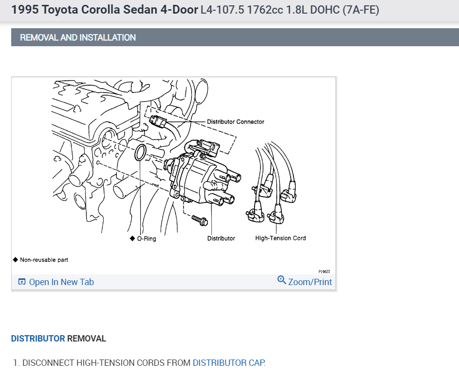

So, I had to replace the condenser. When I put the distributor together and started it up, I could hear a noise. Took it apart and found loose copper wire from the pick-up coil. I'm trying to get a new one and the part does not match up to the old one. I'm thinking someone put a different distributor in my car.
Jun 16, 2023 at 9:25 AM
  • 54,832 POSTS

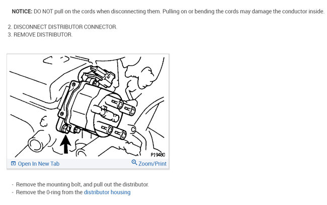

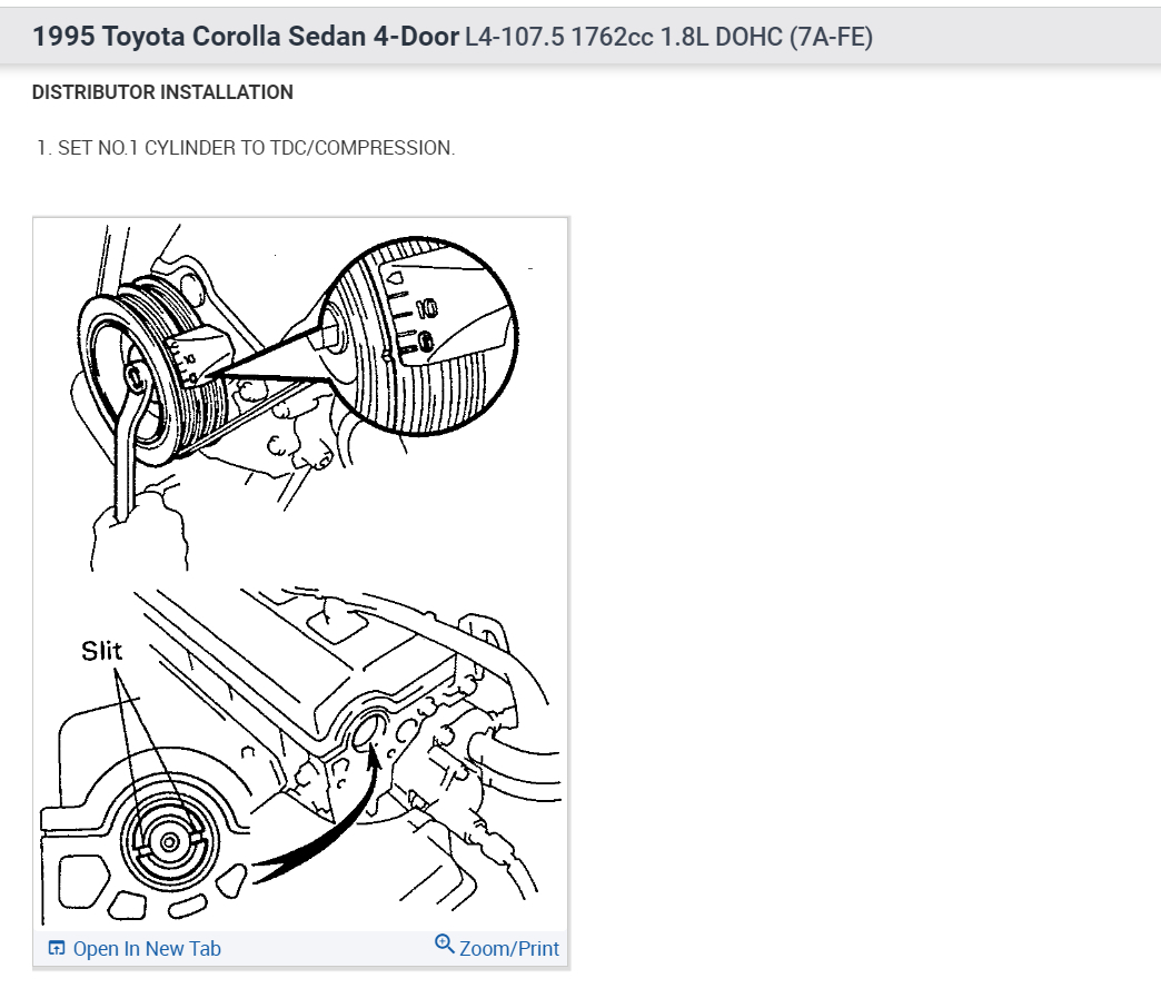

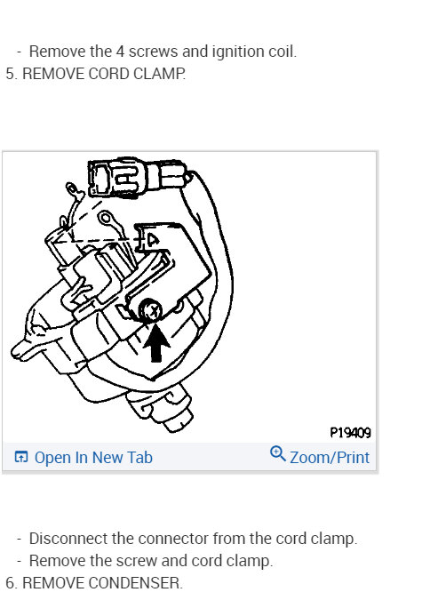

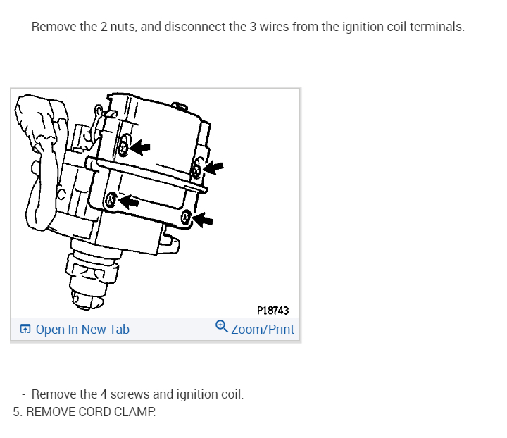

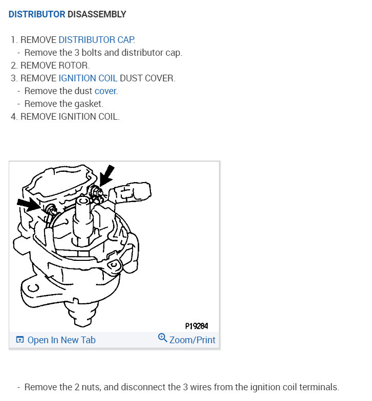

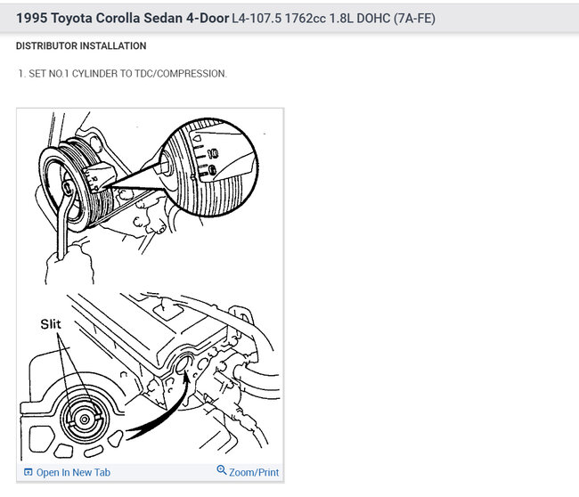

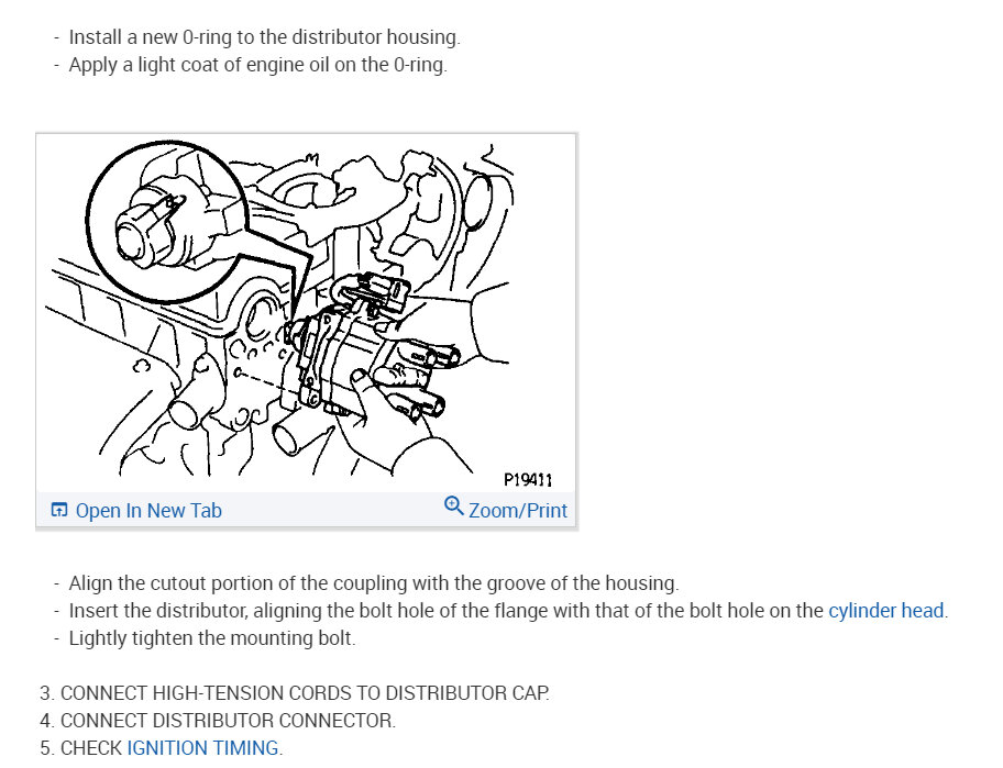

It sounds like you need a rebuilt distributor for your car. Here are the instructions and part number needed for a correct installation.
Distributor Assembly 1905016030
Here is the unit you need on Amazon:
https://amzn.to/3N739f0
Check out the images (below). Please let us know if you need anything else to get the problem fixed.

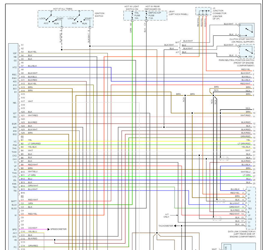

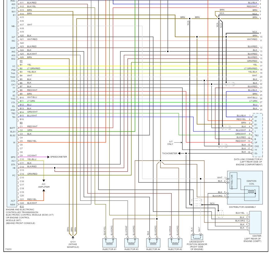

DUGGAN88
Igniter is external.
Jun 17, 2023 at 10:59 AM
  • 54,832 POSTS

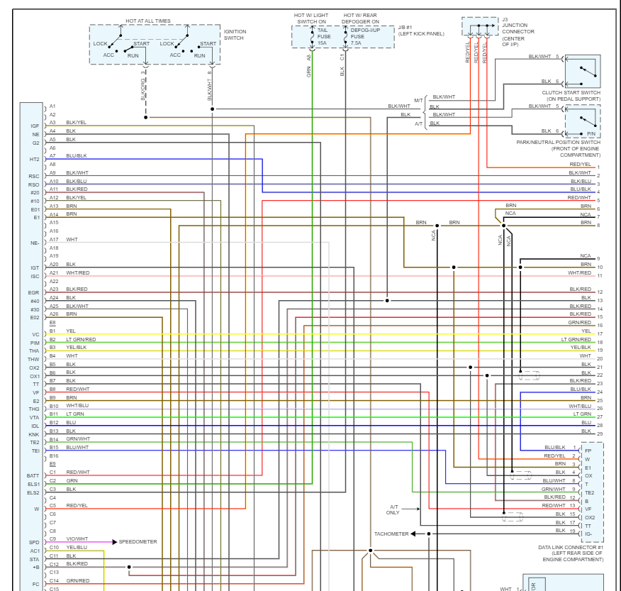

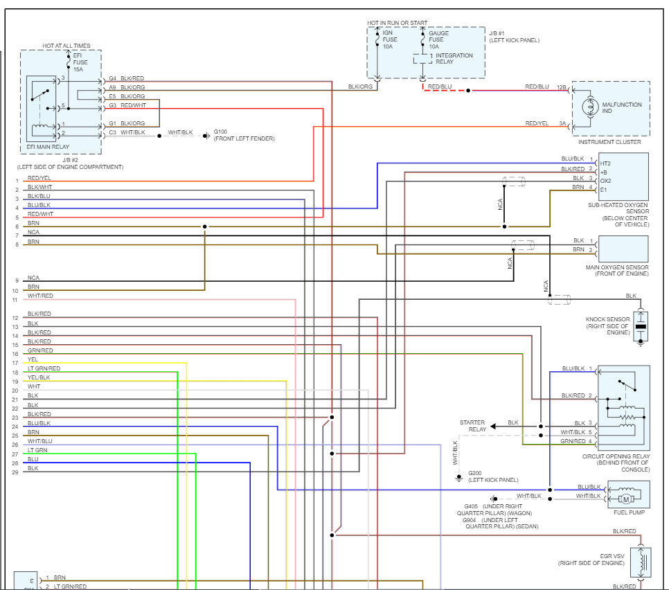

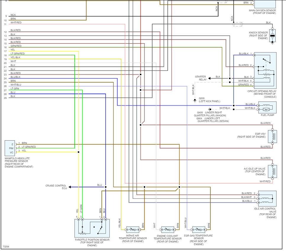

They don't show the ignition module, but I found the engine wiring diagrams which have the ignition ignitor. Check out the images (below). Please let us know how it goes
