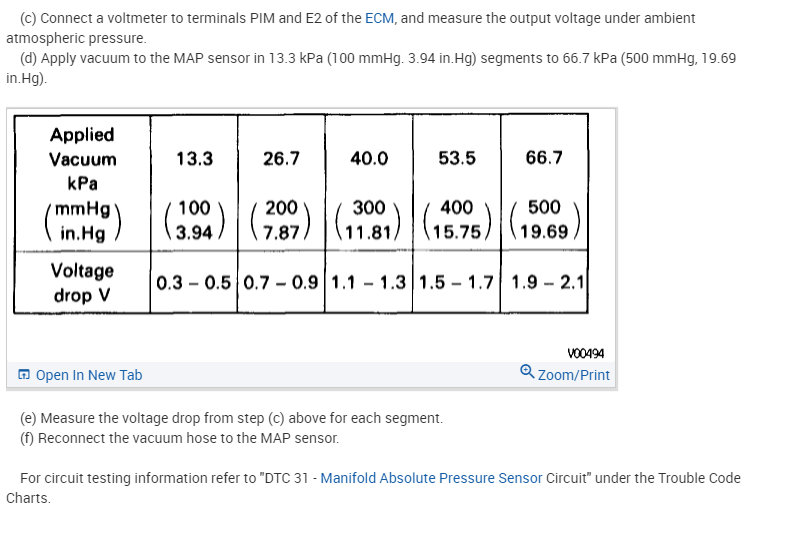

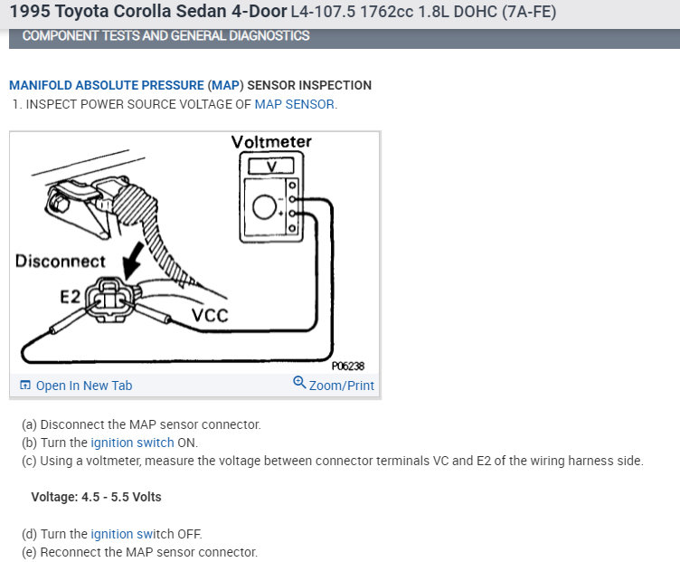

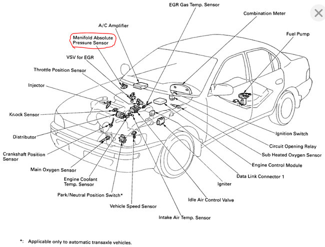

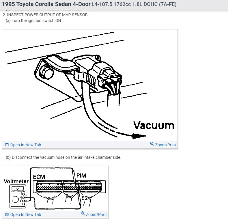

Another possibility is a bad manifold absolute pressure (MAP) sensor. Faulty MAP sensor can lead to poor acceleration, rich air fuel ratio, rough idle.
