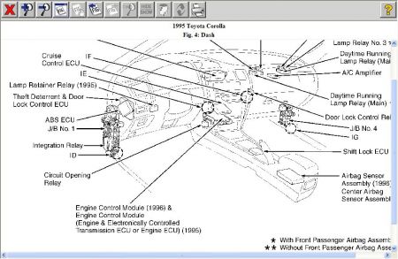

Still just cranks, is it possible the computer needs to be reset after replacing parts?
Where is the computer located/

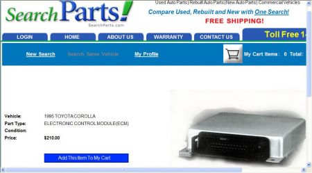

You need to check for open and short on the wires between the distributor and computer-if okay change out the computer-
https://images.2carpros.com/forum/automotive_pictures/12900_ecm1_1.jpg
Estimate price below
https://images.2carpros.com/forum/automotive_pictures/12900_ecm_2.jpg
