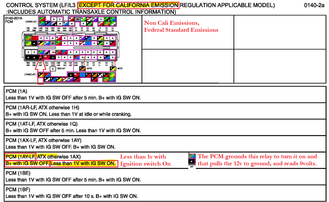

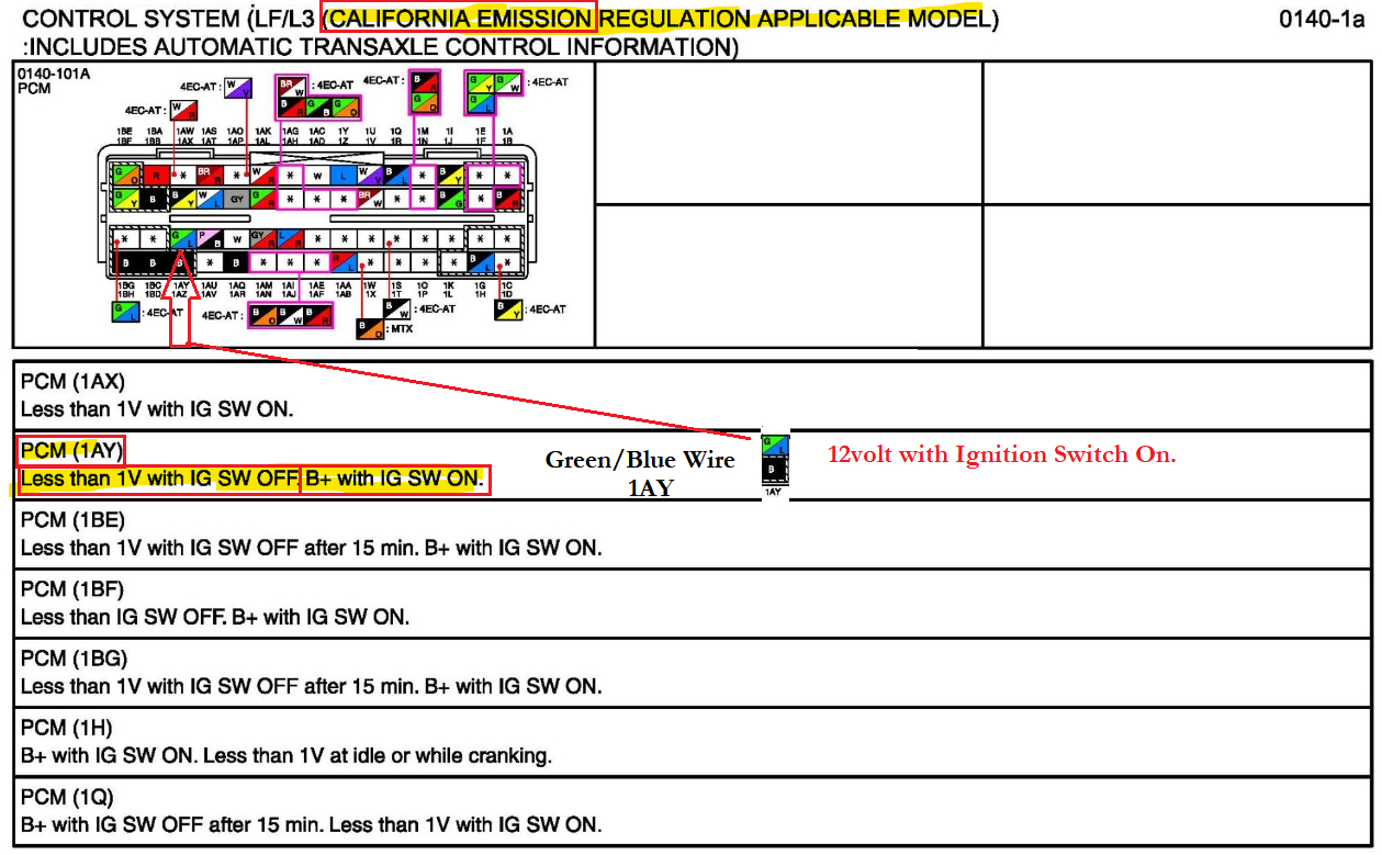

No, I wasnt saying it was a throttle body issue, sorry I should have been more clear. I was just showing the difference between the California and Federal emissions standards for this vehicle. In the first case (Cali Emissions) that PCM wire (PCM pin 1AY) is power coming from the Ignition switch to the PCM.
In the 2nd case, (Federal Emissions) that same PCM wire (1AY) is Grounding the relay that powers the Drive by wire system.
So the difference is that with the key On, the California emissions vehicle will have battery power on 1AY. The other Fed emissions, with the key On, should be Grounding that circuit and therefore read 0volts.

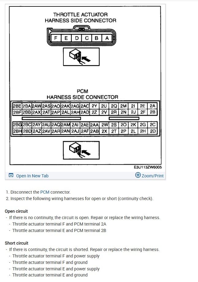

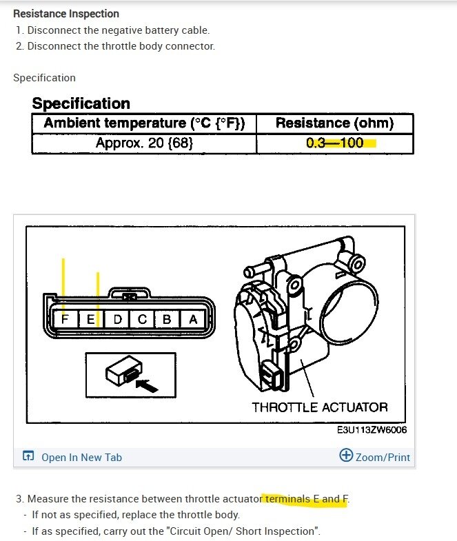

Here is the resistance test for the throttle body (1st diagram) if you want to verify that.
And the 2nd diagram is for checking for an Open or Short circuit from the throttle body to the PCM connector.
It might be that the throttle body is shorting out, or going open circuit when it gets hot. Circuit board issues will usually show themselves under different temperatures. Since you have already tried different PCMs with the same fault.
Does the vehicle have a sticker under the hood that reads either California or Federal Emissions on it? So we can figure out what you should be reading on that PCM wire.

It is federal emission. Checks have been made and no voltage drop, it is around 13v.

Okay, some of these wiring diagrams are incorrect, you're getting power on the green/blue wire, correct? The OEM wiring diagrams show different wire locations, the 1st diagram below is labelled as "Except Cali Emissions" and has 1AY stating Less than 1volt with IG Switch On. And the 2nd diagram is the opposite. So, I think they have them incorrect or some other option might be available, but since you have tried different PCMs, and still have the fault, it's obviously not the PCM.

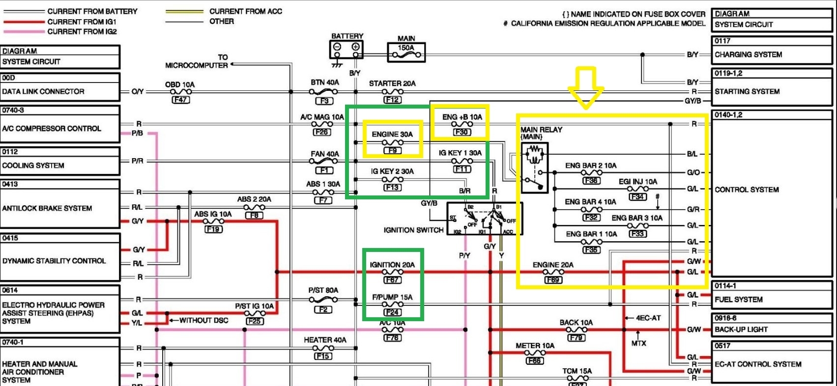

Check the fuses that I have marked in the yellow squares for any corrosion or signs of the fuse having darker tabs on it, those fuses feed the PCM to and from the Main Relay. The P0606 code is mainly caused by a loss or lower voltage to the PCM. A fuse doesn't have to be blown to have voltage drop on it.
+1

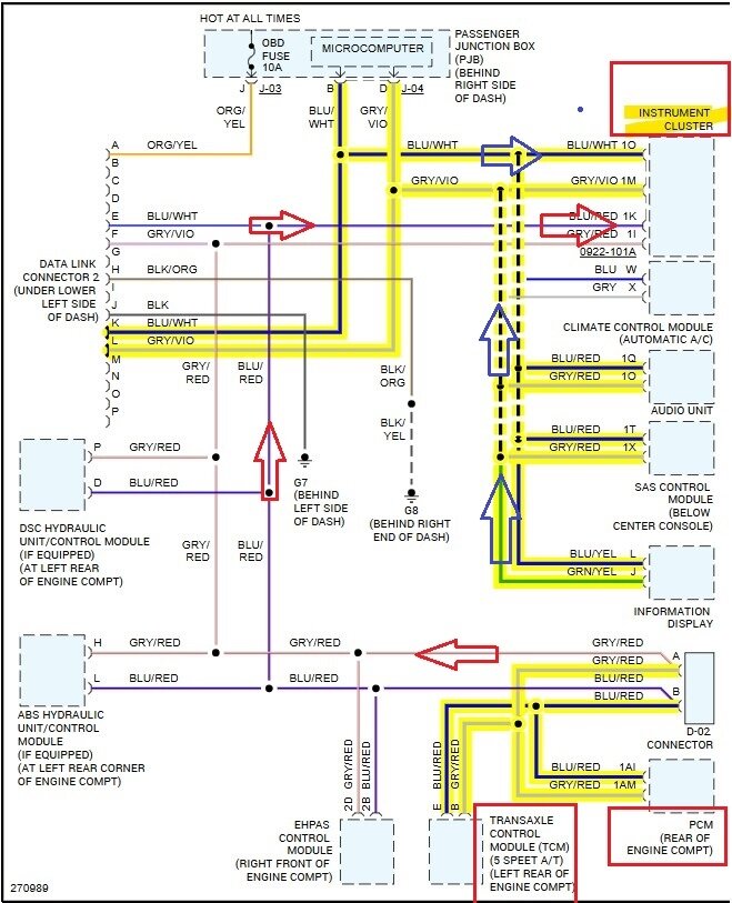

Okay, so the issue is now showing up when you turn the Radio on, that's very interesting because it looks like the Radio is on the Medium Speed Canbus network, and module faults from either shorting out the network, or sending out corrupt data packets can cause other modules to malfunction. Especially if you have a display that the radio is tied into, and possibly a navigation system, these will all talk to each other on the vehicles communications networks, High Speed, Medium Speed canbus, etc.

So, it looks like the Instrument Cluster is the Gateway type module where the 2 different networks will communicate with each other through, the PCM (engine computer, TCM trans computer) are on the High Speed network, and the Radio, Climate controls, information display are on the Medium Speed network, so the radio might be interfering with the entire data bus in the vehicle. I've marked the High Speed with Red arrows and the medium speed with blue arrows to show how they meet up. The Passenger Junction Box is also on the medium speed network, so it's possible the Radio is taking down the Junction Box which houses all the fuses and relays inside the vehicle.

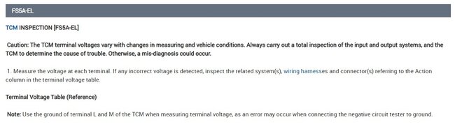

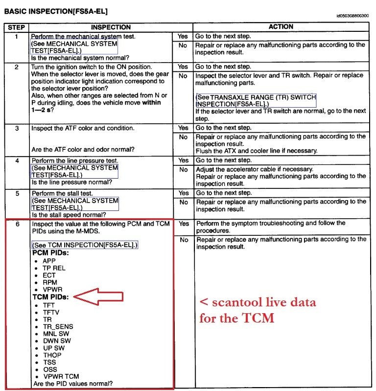

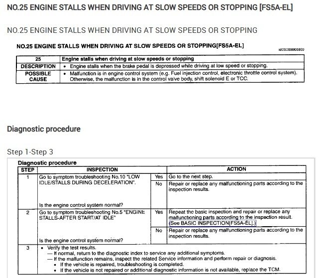

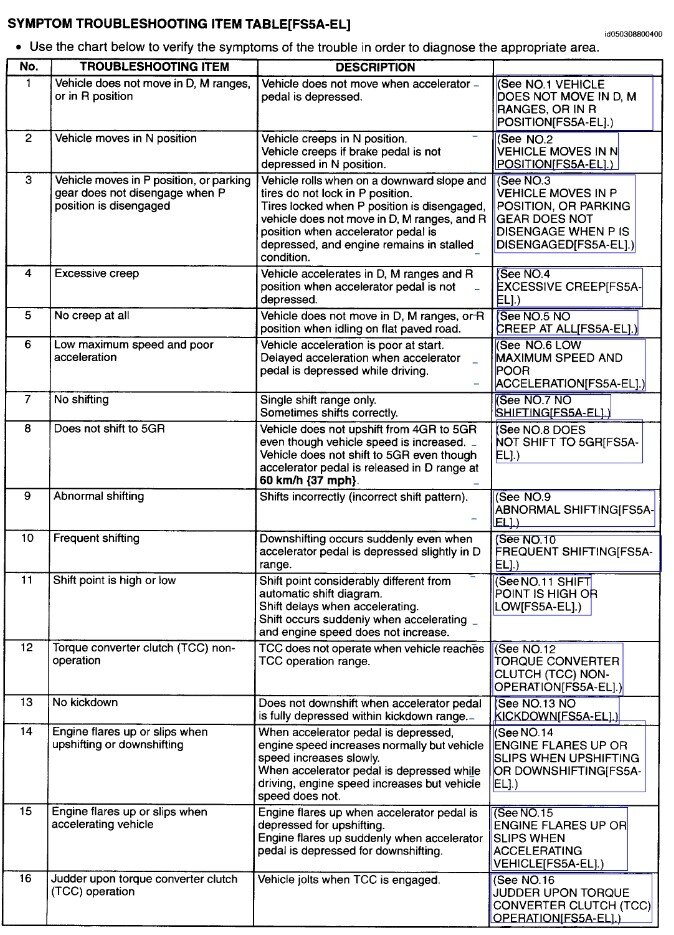

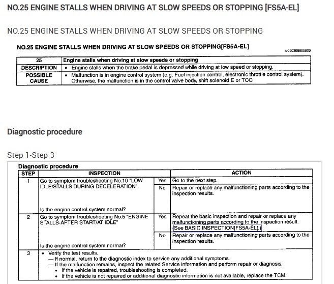

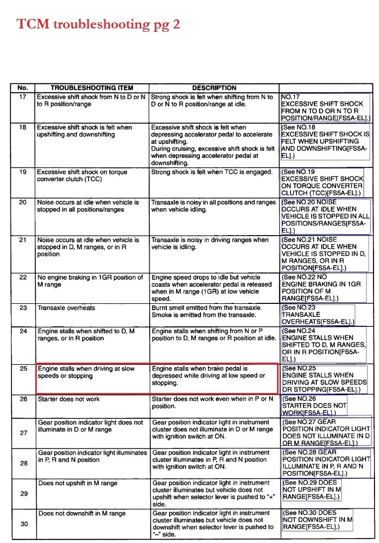

If the AT warning lamp was on, it should have a trouble code stored in the Transmission control module. You will just need a scan tool that is capable of scanning other modules besides just the engine computer. So a full system scan with the Cluster plugged in, might give you other codes to give some direction as to what is faulting,
Since know that all these issues started when the battery was hooked up backwards, its pretty safe to assume that this is an electrical/module issue, a lot of damage can occur when a battery is accidently hooked up in reverse. Theres some info on "Stalling when stopped/ with AT warning lamp on" and service info actually gives the voltage values of what you should see on each wire of the Transmission Control module, Ill post this for you if you want to go through and check the voltage readings at the TCM.

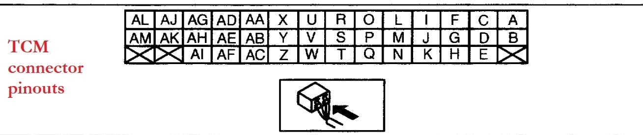

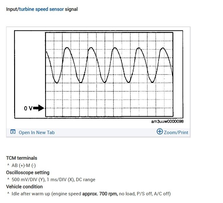

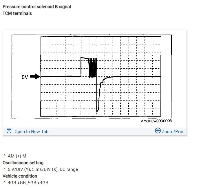

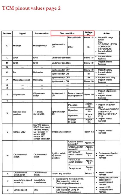

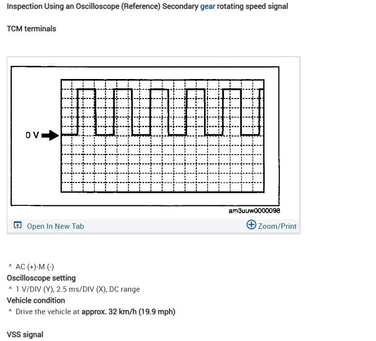

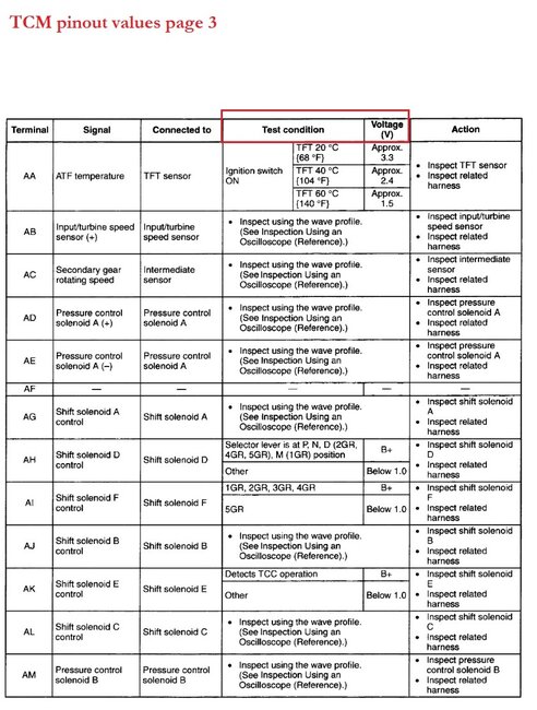

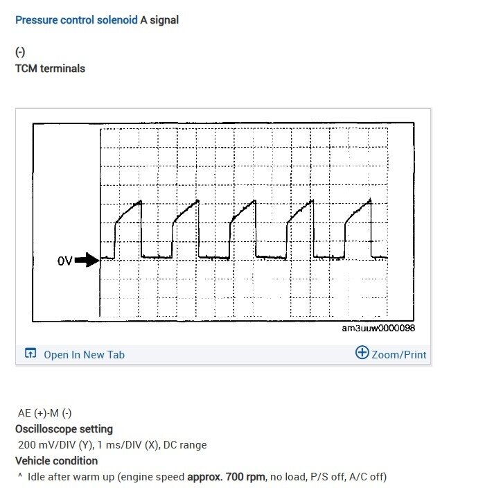

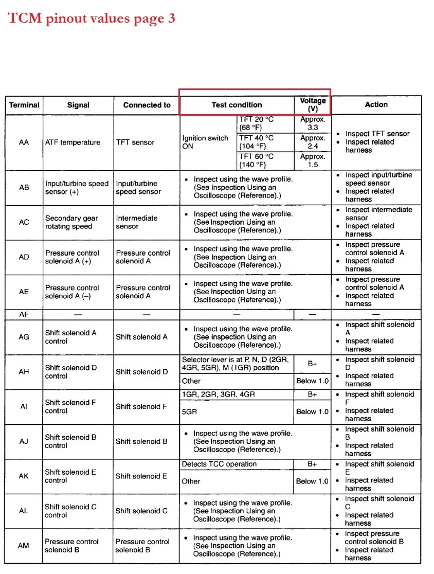

These are some of the diagnostic steps for checking the voltage values of each transmission control module wires at its connector. The rest of the troubleshooting section of this is all oscilloscope waveforms, and gets pretty technical if you don't have any experience using a scope. 10-14 are some examples of scope waveforms that certain sensors inside the transmission should be inputting into the TCM.
But if you want to check the voltage values with a multimeter, it will be DC volts using the Signal labelled "GND" for your Ground connection.

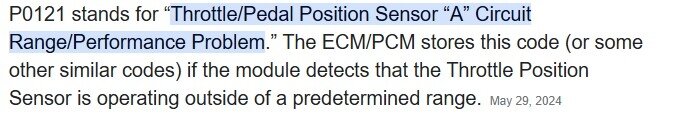

I really appreciate you sir, this last checks is honestly beyond my scope, I think I will keep on managing the car like this, whenever it stalls with an AT light, I will turn off the key and wait for a minute or two, start again and I will drive smoothly, when it stalls with no AT, I start again instantly and continue the smooth ride.

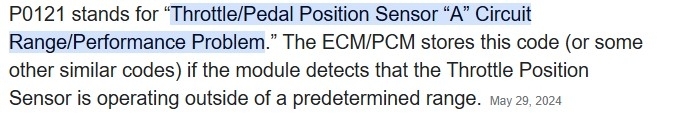

The codes sets when AT comes up are usually related to lost communication, U0100 P0121
P0606 etc.

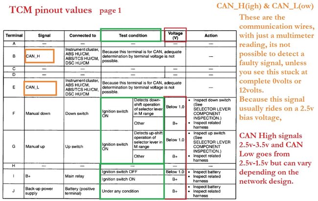

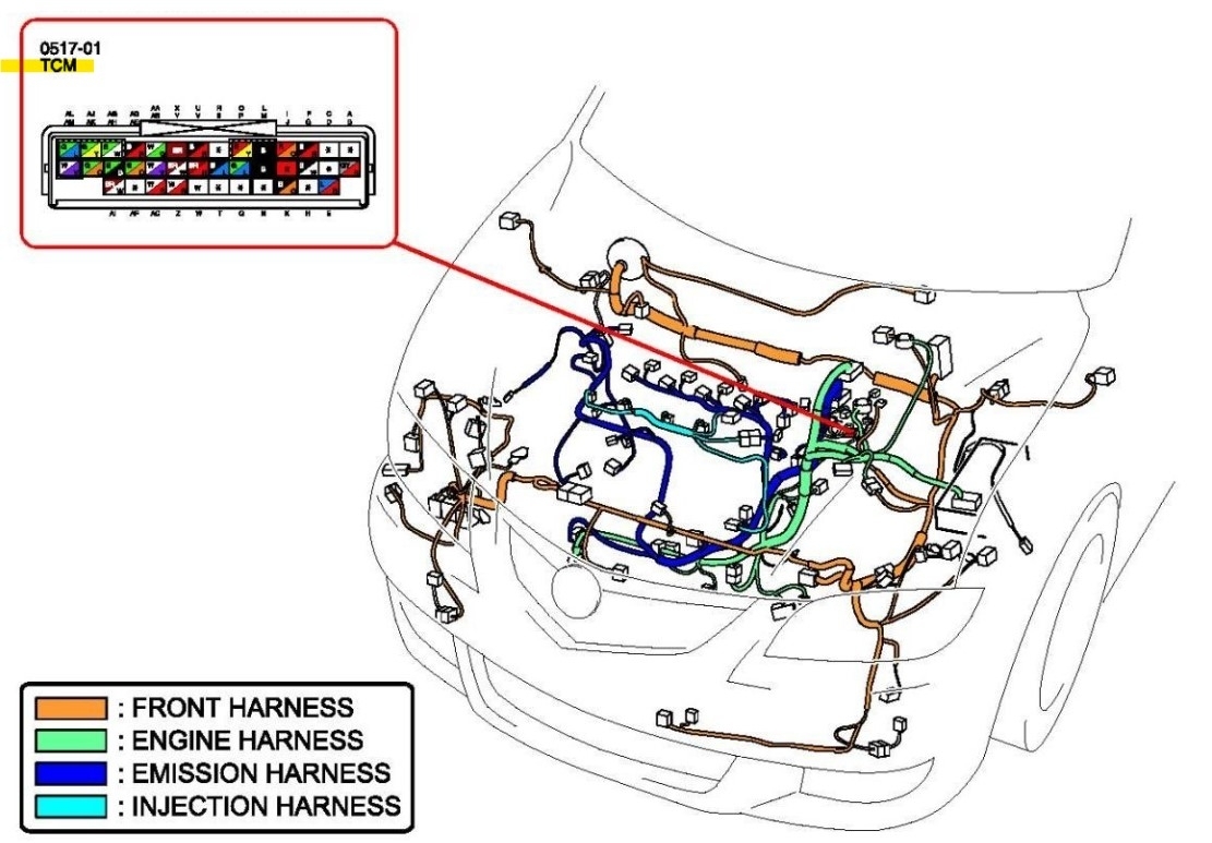

The voltage testing at the TCM connector is not as difficult as it looks, you're really just probing the back of the connector with a multimeter and looking for the voltage level specified under the "value" column. But with this P0606 code popping up again, the vehicle might be losing its learned value for the throttle body (idle relearn) if theres a voltage loss occurring somewhere.

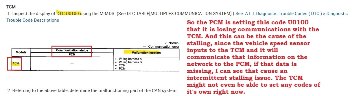

Because the U0100 code is a communications error with the TCM that looks to be coming from the PCM, so it's having an issue with talking to the transmission control module. And if the TCM is either losing power (which is usually the cause of a P0606 error) that means the throttle body relearn may also be lost and that is causing your stalling issue.
Since you have tried multiple PCMs with the same result, my thinking is now heading towards a damaged TCM due to the battery accident, in many cases the TCM will also use the throttle position data from the PCM to control the pressure in the transmission for different shift points.
Some times I like to power up a module on the bench and check for any communications voltage coming out, since it will be disconnected from the rest of the vehicle's network. Because it can be difficult to de-pin the Canbus wires from module connectors if you're not used to doing it, the TCM looks to have 3 power inputs (12v) and 3 Grounds. So let me know if I can do anything else to help here. Id really like to see you get this thing fixed, so you dont have to deal with these issues anymore.
What type of scan tool are you using currently?
The TCM is located right next to the PCM in the engine compartment, are you located in an area where getting parts is a challenge?
