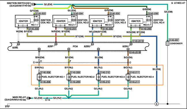

Hello, with all the injectors unplugged, key off, none of the injector control wires should have any continuity to ground at all. If they do, unplug the PCM connector and retest the injector control circuits for shorts to ground with all the injectors unplugged. There should be no paths to ground at all. I'll post a wiring diagram for you, where did you get the new PCM?
Are you sure you're testing the correct wire, it sounds like you're checking continuity on the power feed with the one injector plugged in.

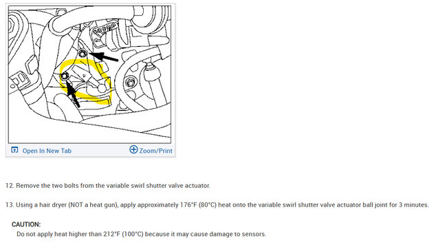

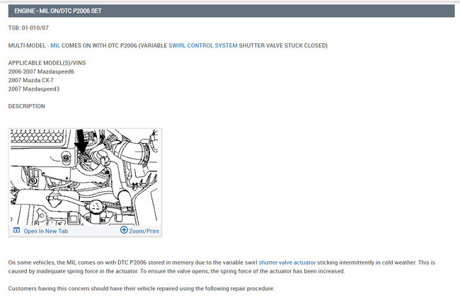

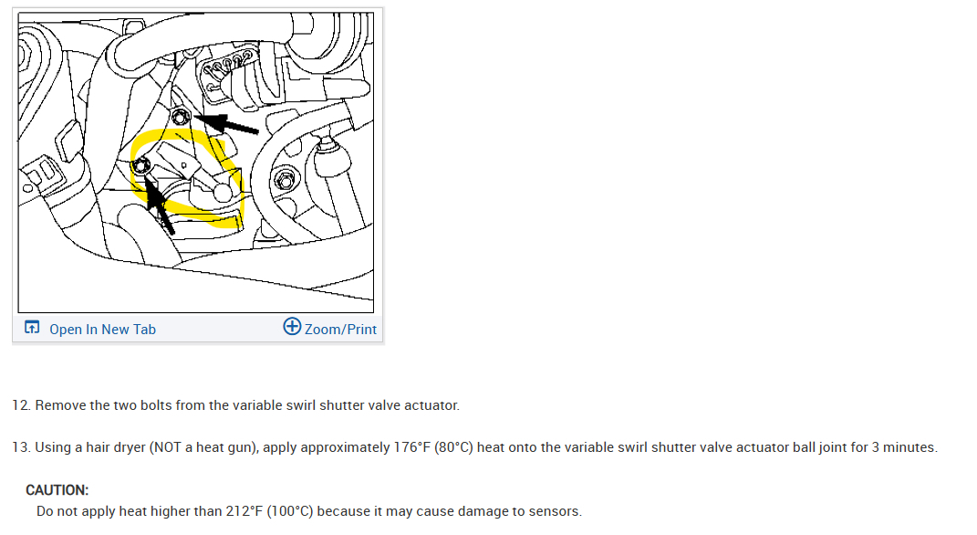

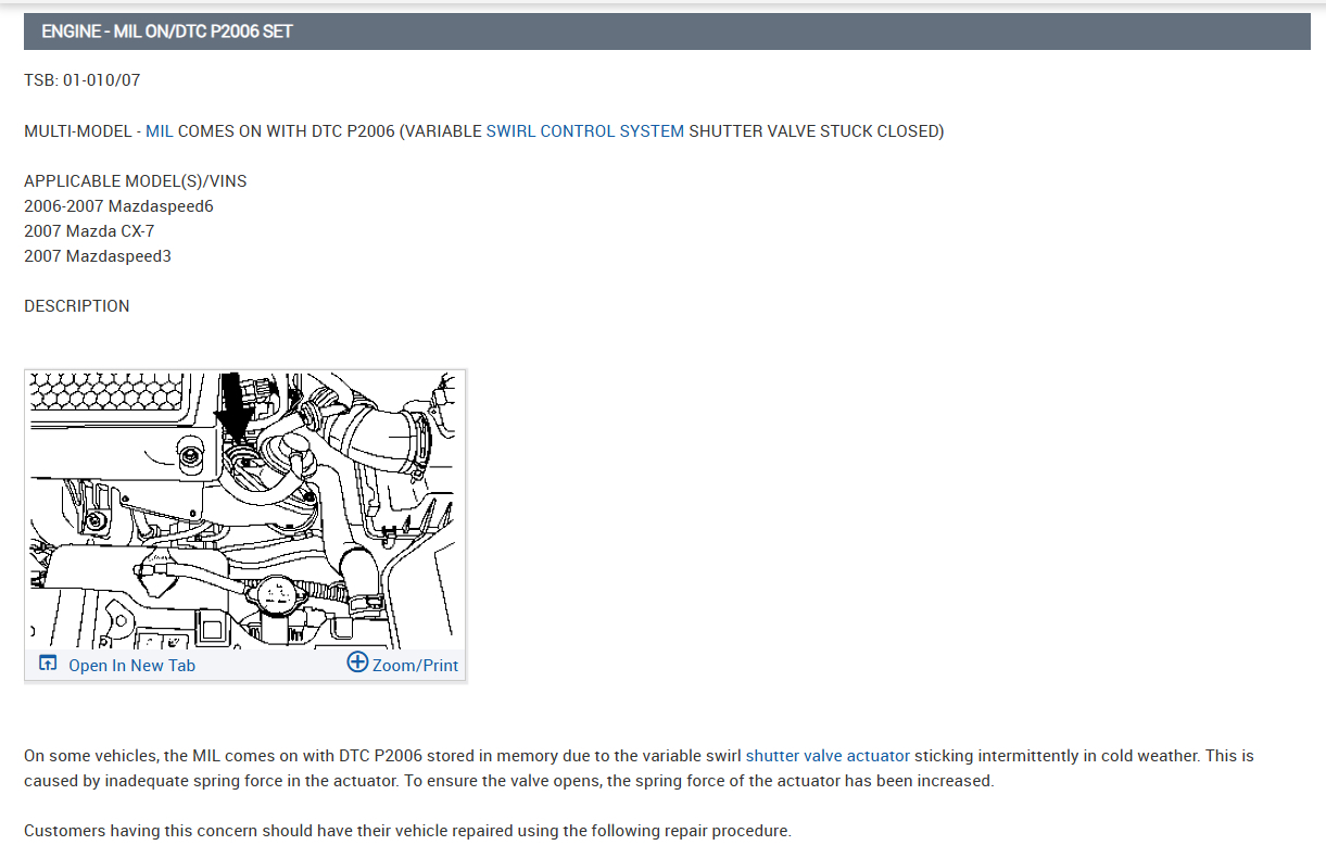

There is a variable intake manifold variable swirl shutter valve which will vary the air turbulence coming into the intake manifold under different engine loads, the idea is to improve the horsepower under different engine loads. This is the TSB about it sticking in colder weather but will set a code P2006. There are some PCM updates having to do with that issue. I'm trying to find a decent picture of it, it looks like there is a rod that moves the shutter valve (2nd diagram). But usually what happens with these variable intake runner type designs, is because they are made of plastic like the intake manifold is, they eventually warp due to heat, and that causes them to stick in one position or another.
I don't know if it would affect the manifold enough to stall the engine or not. Sometimes I find that they are causing a vacuum leak, because the rod is external to the intake manifold, I find some leaking when doing a smoke test on the intake manifold.
If they can show you exactly why they think the intake manifold is causing the stall, that's a different story, but does the engine stall out even if try to give it some throttle?
In a case like this I would try to watch for whatever the engine is losing, such a fuel pressure, spark, or some voltage loss to the electrical system, instead of just replacing parts and hoping that solves the issue. That code (P0606) is an indication of what might really be happening. Does that code still set after the stall out? Because you could setup a multimeter somewhere and see if a voltage loss is causing the stall.

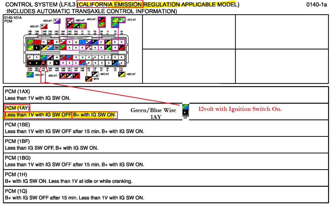

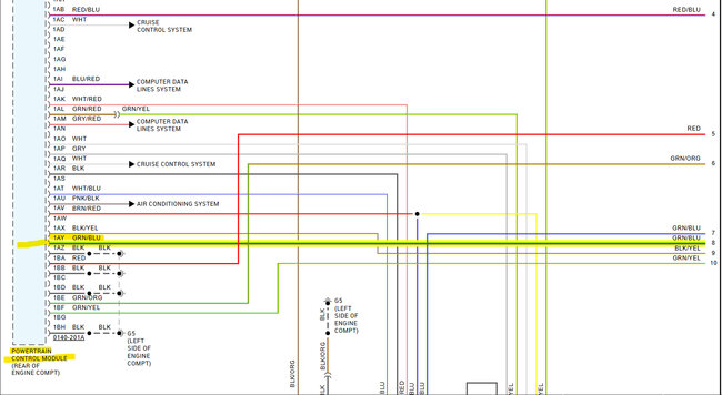

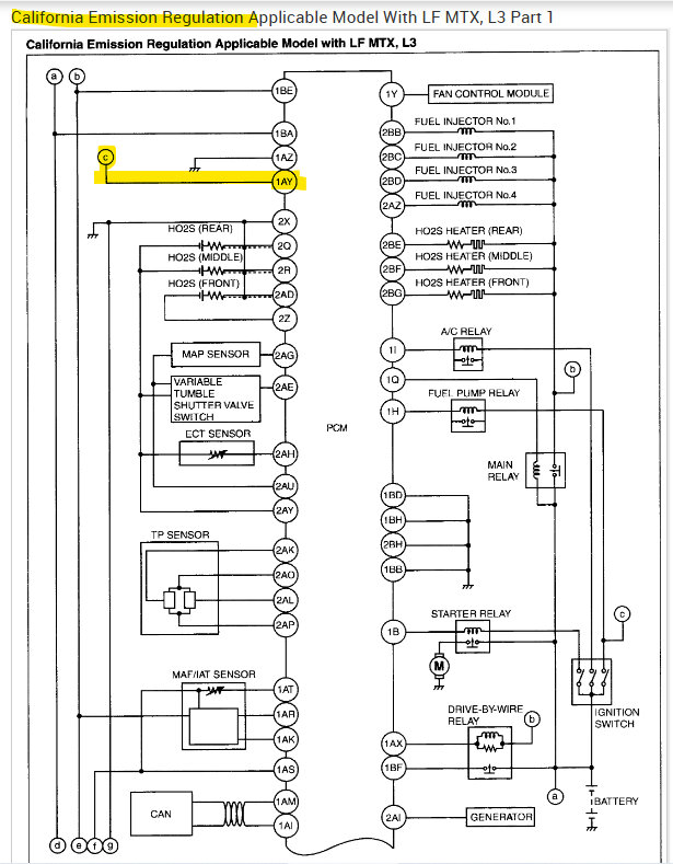

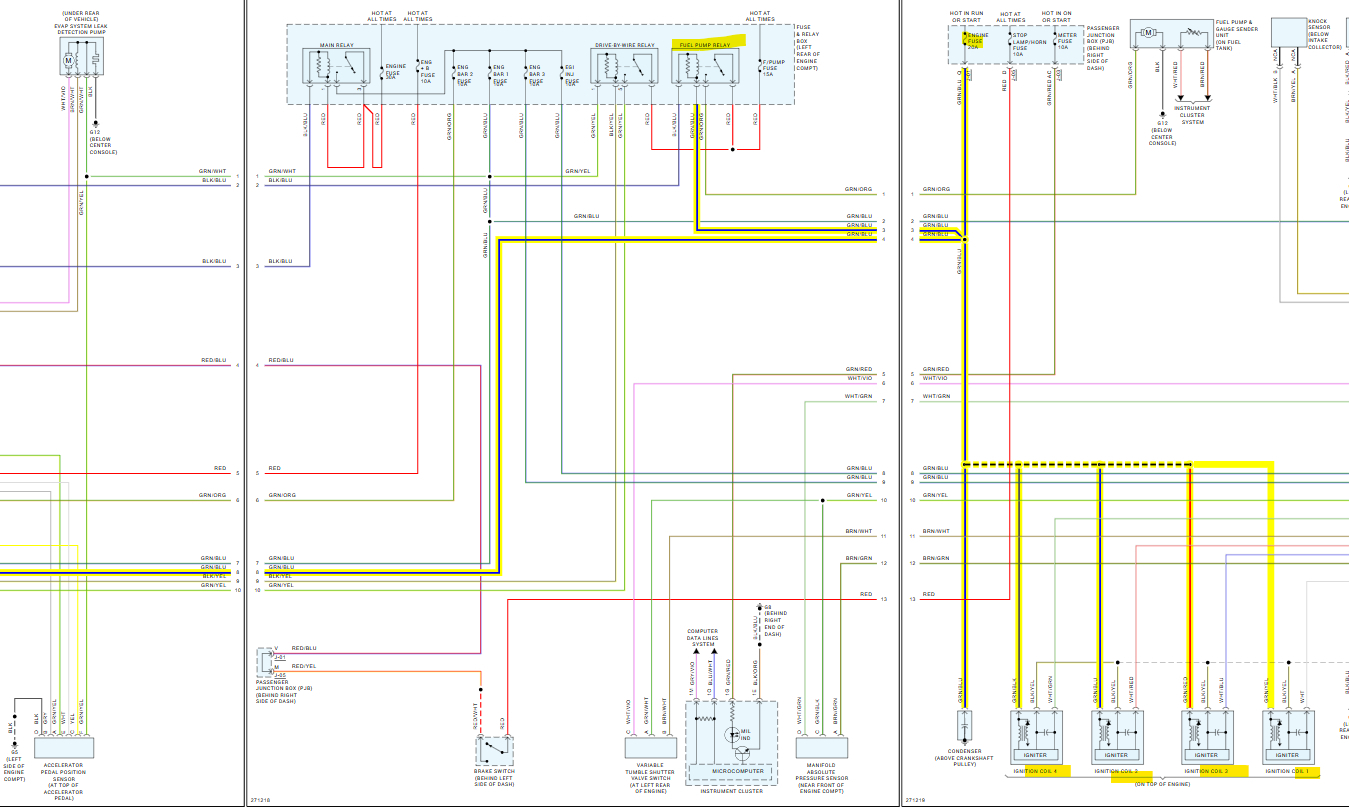

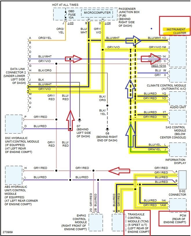

This is the circuit going to the PCM that's setting the P0606 code. Pin 1AY Green/Blue wire, it comes from that Engine Fuse 20Amp. If this circuit loses voltage, it throws off the PCMs operation. So, you could monitor that wire, it should be 12v while running. And see if it drops out during the stall. The fact that you can restart the engine right away tells me the PCM is most likely glitching out, I would not like to see you replace the intake manifold and still have the same issue.
May 18, 2024 at 9:05 AM
AL514
  • 5,668 POSTS
Is this a California Emissions vehicle or Federal Emissions? It should say on the tag under the hood. There's some differences with the PCM wiring depending on the emissions specs.
May 18, 2024 at 9:13 AM
AL514
  • 5,668 POSTS

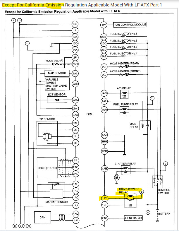

The first diagram is the California emissions with auto trans, with circuit 1AY being fed power from the Ignition Switch, the 2nd diagram is non Cali emissions auto trans with circuit 1AY is the Drive by Wire relay control wire, so it will not read 12volts when the ignition is on, whereas the Cali emissions vehicle will have 12volts on 1AY when the ignition switch is On. So that's the difference in circuit design.

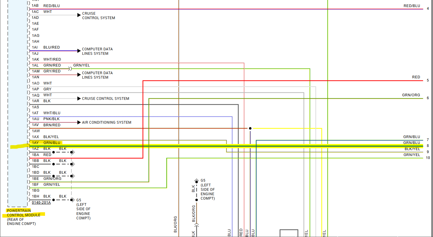

AL514
  • 5,668 POSTS

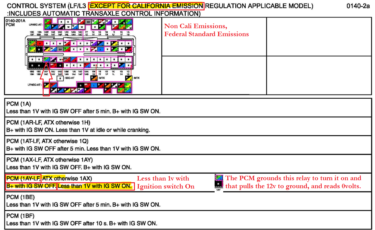

These are the two different PCM connectors depending on the emissions regulations, and the pin 1AY to monitor the voltage level during the stall/fault condition. The 1AY pin is located in the same location either way with the green/blue wire.

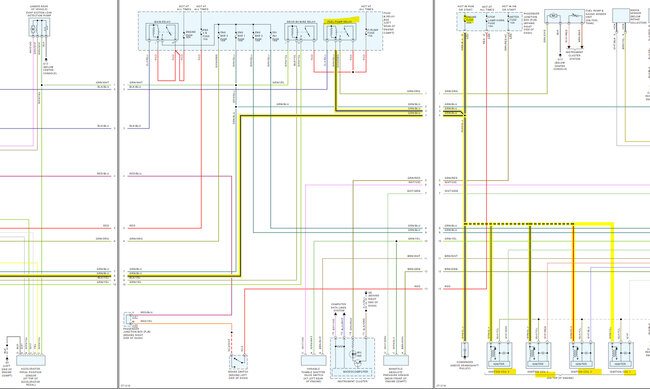

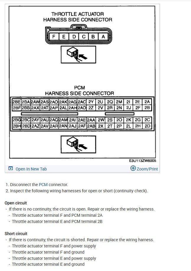

No, I wasnt saying it was a throttle body issue, sorry I should have been more clear. I was just showing the difference between the California and Federal emissions standards for this vehicle. In the first case (Cali Emissions) that PCM wire (PCM pin 1AY) is power coming from the Ignition switch to the PCM.
In the 2nd case, (Federal Emissions) that same PCM wire (1AY) is Grounding the relay that powers the Drive by wire system.
So the difference is that with the key On, the California emissions vehicle will have battery power on 1AY. The other Fed emissions, with the key On, should be Grounding that circuit and therefore read 0volts.
Putting on a different throttle body will most likely require an idle relearn procedure to be done.

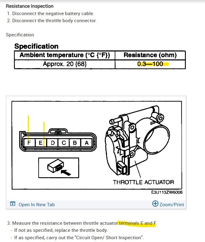

Here is the resistance test for the throttle body (1st diagram) if you want to verify that.
And the 2nd diagram is for checking for an Open or Short circuit from the throttle body to the PCM connector.
It might be that the throttle body is shorting out, or going open circuit when it gets hot. Circuit board issues will usually show themselves under different temperatures. Since you have already tried different PCMs with the same fault.
Does the vehicle have a sticker under the hood that reads either California or Federal Emissions on it? So we can figure out what you should be reading on that PCM wire.

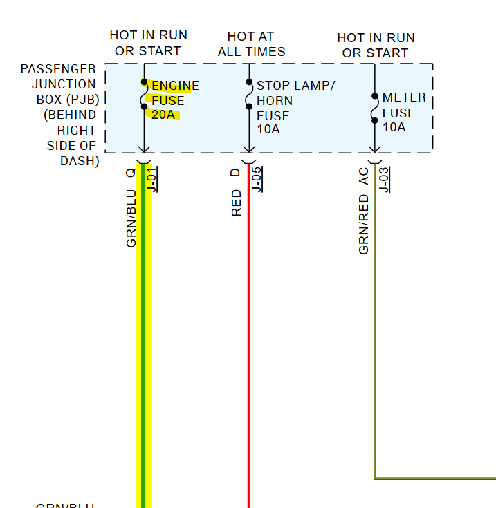

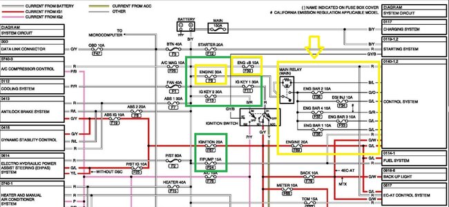

Okay, some of these wiring diagrams are incorrect, you're getting power on the green/blue wire, correct? The OEM wiring diagrams show different wire locations, the 1st diagram below is labelled as "Except Cali Emissions" and has 1AY stating Less than 1volt with IG Switch On. And the 2nd diagram is the opposite. So, I think they have them incorrect or some other option might be available, but since you have tried different PCMs, and still have the fault, it's obviously not the PCM.
But the other throttle body does not respond if you put the vehicle in Drive? but no longer stalling out? Is it setting any different codes with the other throttle body?
May 28, 2024 at 7:39 AM
AL514
  • 5,668 POSTS
Check the fuses that I have marked in the yellow squares for any corrosion or signs of the fuse having darker tabs on it, those fuses feed the PCM to and from the Main Relay. The P0606 code is mainly caused by a loss or lower voltage to the PCM. A fuse doesn't have to be blown to have voltage drop on it.
May 28, 2024 at 7:58 AM
HUDUMASAUD
  • 45 POSTS
Okay sir, i had the throttle changed and problem worsen with AT light always on, so i abandon the vehicle to get some rest, today i picked the vehicle up and replaced the throttle Socket, new battery and alternator , the problem with P0122 and P0606 and other codes were fixed but stalling continues at idle with no codes , so i decided to go for a drive and there was no AT light until when i turn on the radio, AT appears, i turned off the car and start again with radio off, there was no stall again till i got home and scan but no codes were set.
I will do an overhaul for the fuses and get back to you. The stalling at idle is very important for me to fix it because my city is always with heavy traffic.

Okay, so the issue is now showing up when you turn the Radio on, that's very interesting because it looks like the Radio is on the Medium Speed Canbus network, and module faults from either shorting out the network, or sending out corrupt data packets can cause other modules to malfunction. Especially if you have a display that the radio is tied into, and possibly a navigation system, these will all talk to each other on the vehicles communications networks, High Speed, Medium Speed canbus, etc.
Jun 26, 2024 at 8:16 AM
AL514
  • 5,668 POSTS
So, it looks like the Instrument Cluster is the Gateway type module where the 2 different networks will communicate with each other through, the PCM (engine computer, TCM trans computer) are on the High Speed network, and the Radio, Climate controls, information display are on the Medium Speed network, so the radio might be interfering with the entire data bus in the vehicle. I've marked the High Speed with Red arrows and the medium speed with blue arrows to show how they meet up. The Passenger Junction Box is also on the medium speed network, so it's possible the Radio is taking down the Junction Box which houses all the fuses and relays inside the vehicle.

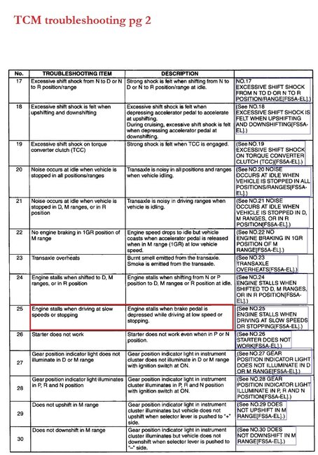

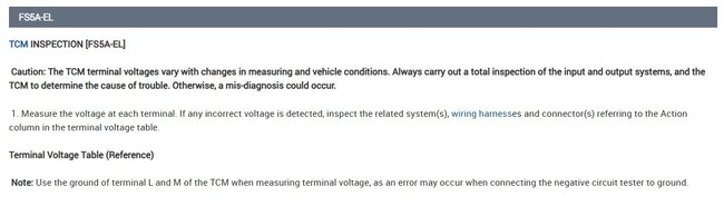

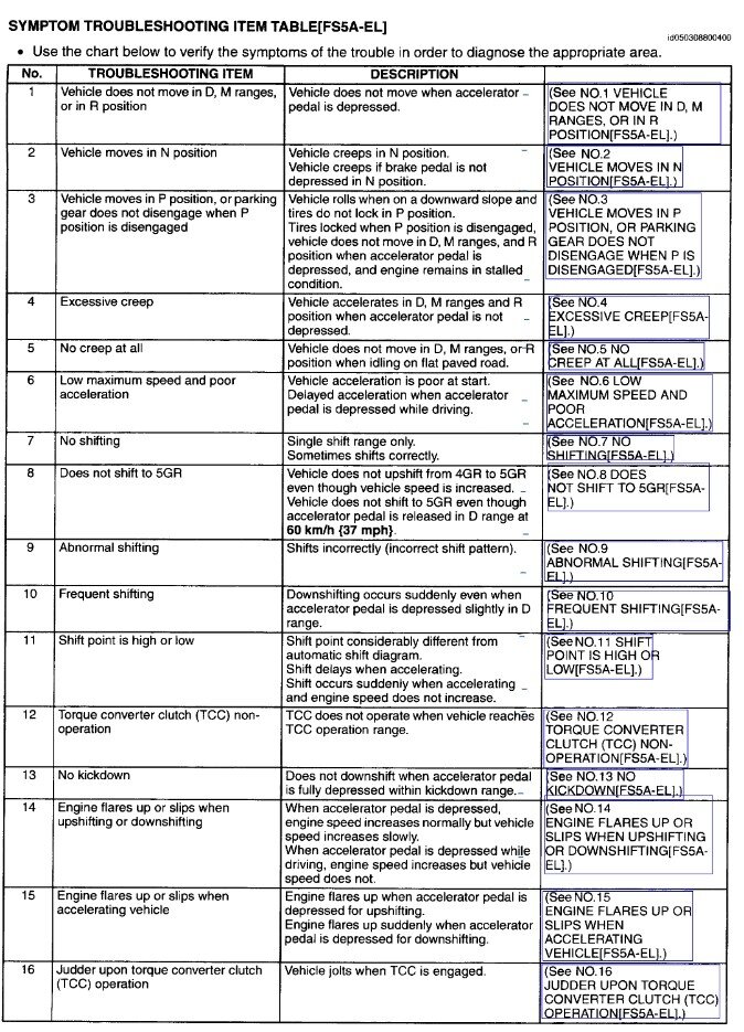

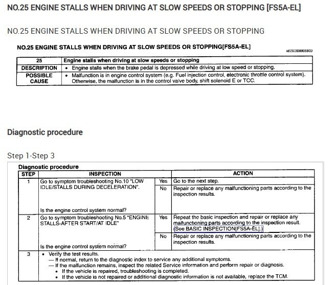

If the AT warning lamp was on, it should have a trouble code stored in the Transmission control module. You will just need a scan tool that is capable of scanning other modules besides just the engine computer. So a full system scan with the Cluster plugged in, might give you other codes to give some direction as to what is faulting,
Since know that all these issues started when the battery was hooked up backwards, its pretty safe to assume that this is an electrical/module issue, a lot of damage can occur when a battery is accidently hooked up in reverse. Theres some info on "Stalling when stopped/ with AT warning lamp on" and service info actually gives the voltage values of what you should see on each wire of the Transmission Control module, Ill post this for you if you want to go through and check the voltage readings at the TCM.
Jun 28, 2024 at 7:12 AM
AL514
  • 5,668 POSTS

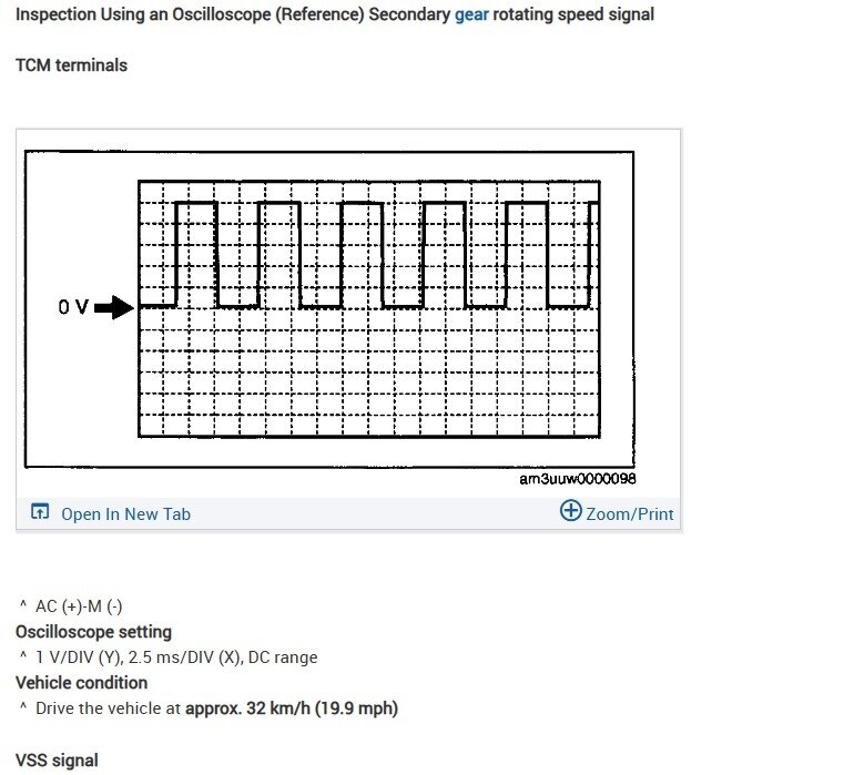

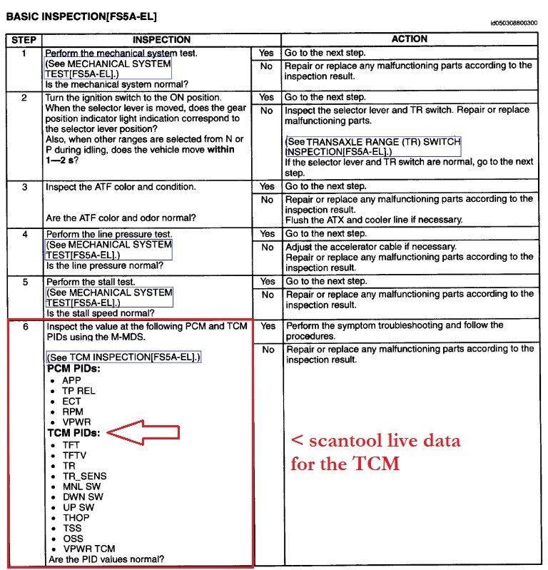

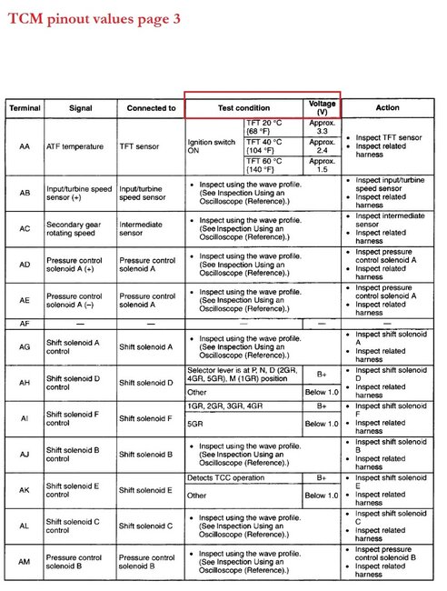

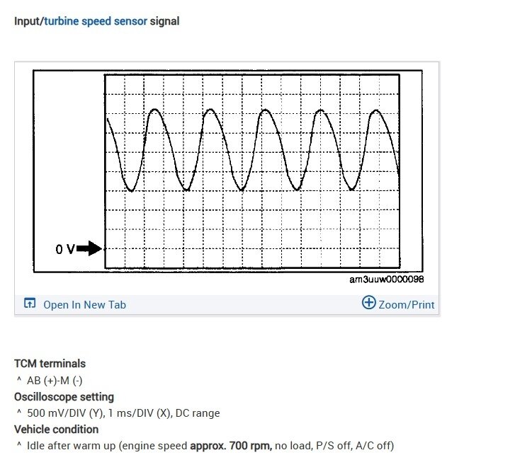

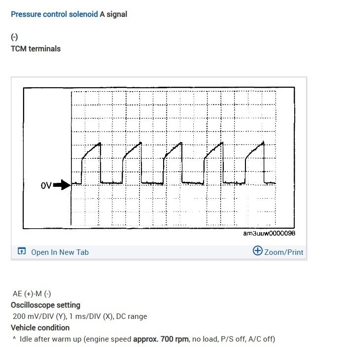

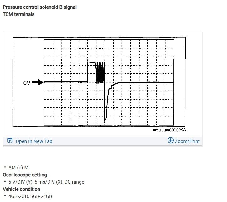

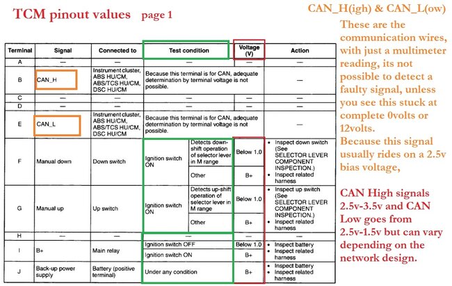

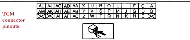

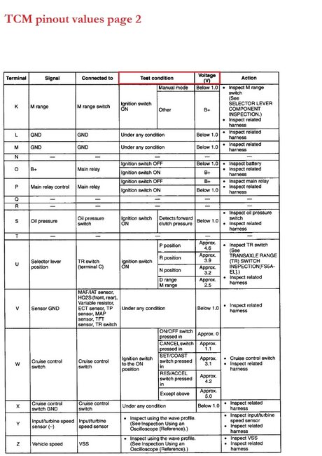

These are some of the diagnostic steps for checking the voltage values of each transmission control module wires at its connector. The rest of the troubleshooting section of this is all oscilloscope waveforms, and gets pretty technical if you don't have any experience using a scope. 10-14 are some examples of scope waveforms that certain sensors inside the transmission should be inputting into the TCM.
But if you want to check the voltage values with a multimeter, it will be DC volts using the Signal labelled "GND" for your Ground connection.
Jun 28, 2024 at 7:56 AM

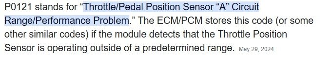

I really appreciate you sir, this last checks is honestly beyond my scope, i think i will keep on managing the car like this, whenever it stalls with an AT light, i will turn off the key and wait for a minute or two, start again and i will drive smoothly, when it stalls with no AT, i start again instantly and continue the smooth ride.

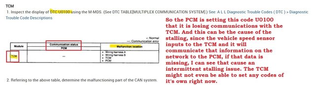

The codes sets when AT comes up are usually related to lost communication,U0100 P0121
P0606 etc.
I read an article about throttle body relearn procedure, so i did as the manual said and it really made the stalling to almost go away especially with the AC on, as the AC on use to increase the RPM.

The voltage testing at the TCM connector is not as difficult as it looks, you're really just probing the back of the connector with a multimeter and looking for the voltage level specified under the "value" column. But with this P0606 code popping up again, the vehicle might be losing its learned value for the throttle body (idle relearn) if theres a voltage loss occurring somewhere.
Because the U0100 code is a communications error with the TCM that looks to be coming from the PCM, so it's having an issue with talking to the transmission control module. And if the TCM is either losing power (which is usually the cause of a P0606 error) that means the throttle body relearn may also be lost and that is causing your stalling issue.

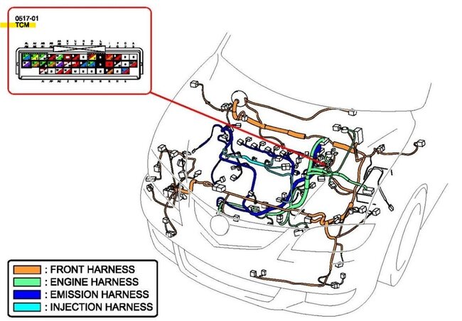

Since you have tried multiple PCMs with the same result, my thinking is now heading towards a damaged TCM due to the battery accident, in many cases the TCM will also use the throttle position data from the PCM to control the pressure in the transmission for different shift points.
Some times I like to power up a module on the bench and check for any communications voltage coming out, since it will be disconnected from the rest of the vehicle's network. Because it can be difficult to de-pin the Canbus wires from module connectors if you're not used to doing it, the TCM looks to have 3 power inputs (12v) and 3 Grounds. So let me know if I can do anything else to help here. Id really like to see you get this thing fixed, so you dont have to deal with these issues anymore.
What type of scan tool are you using currently?
The TCM is located right next to the PCM in the engine compartment, are you located in an area where getting parts is a challenge?
