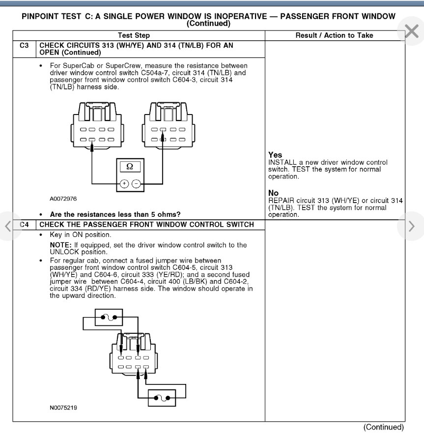

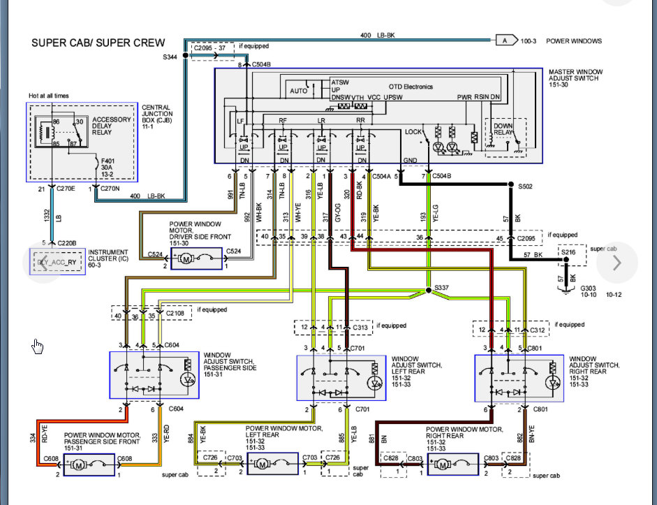

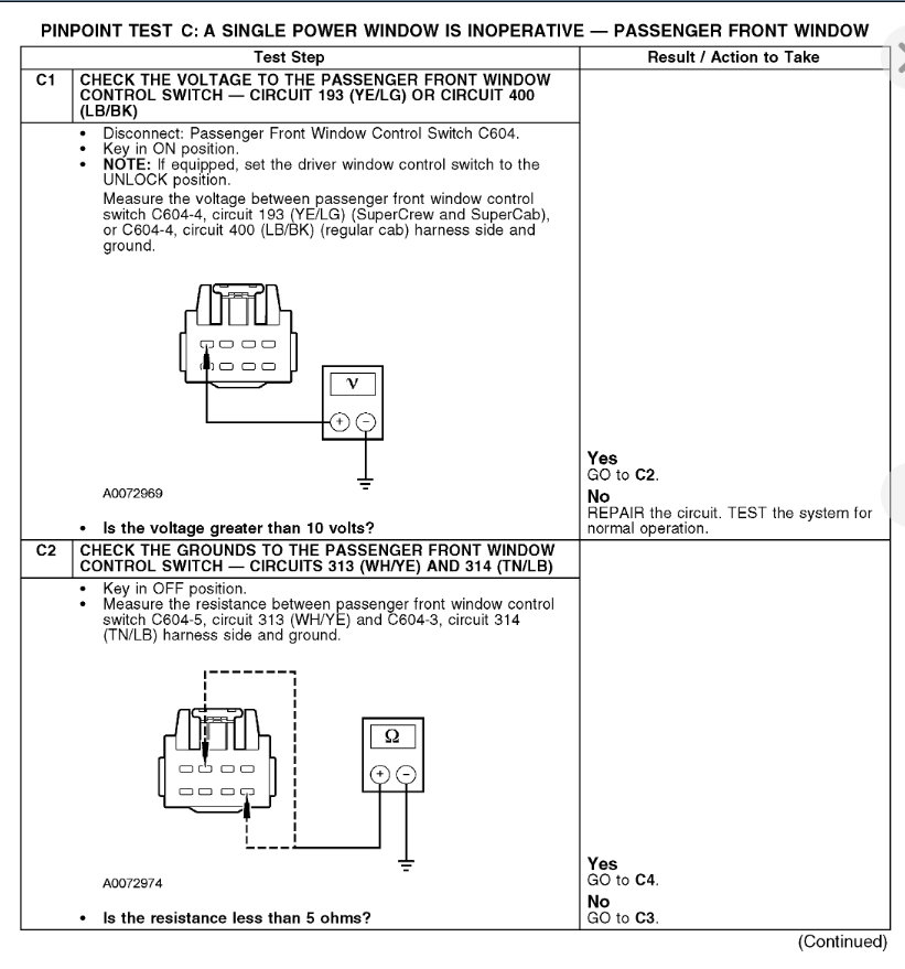

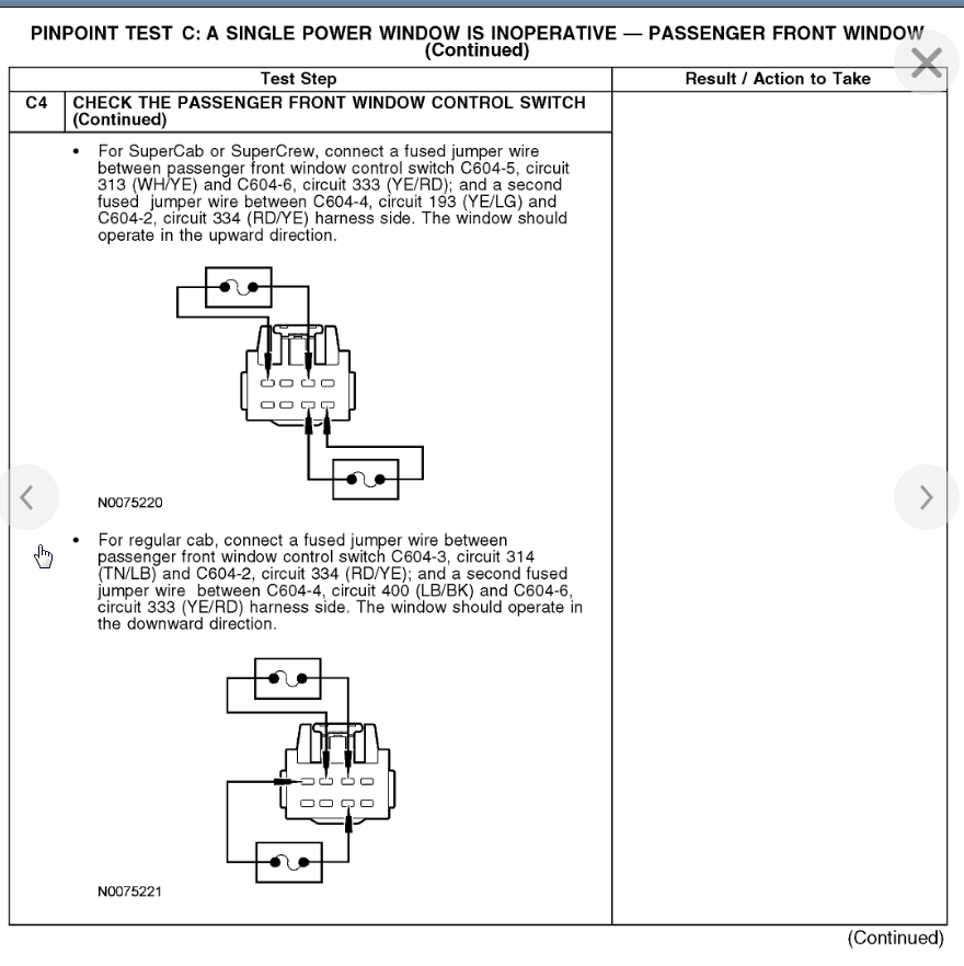

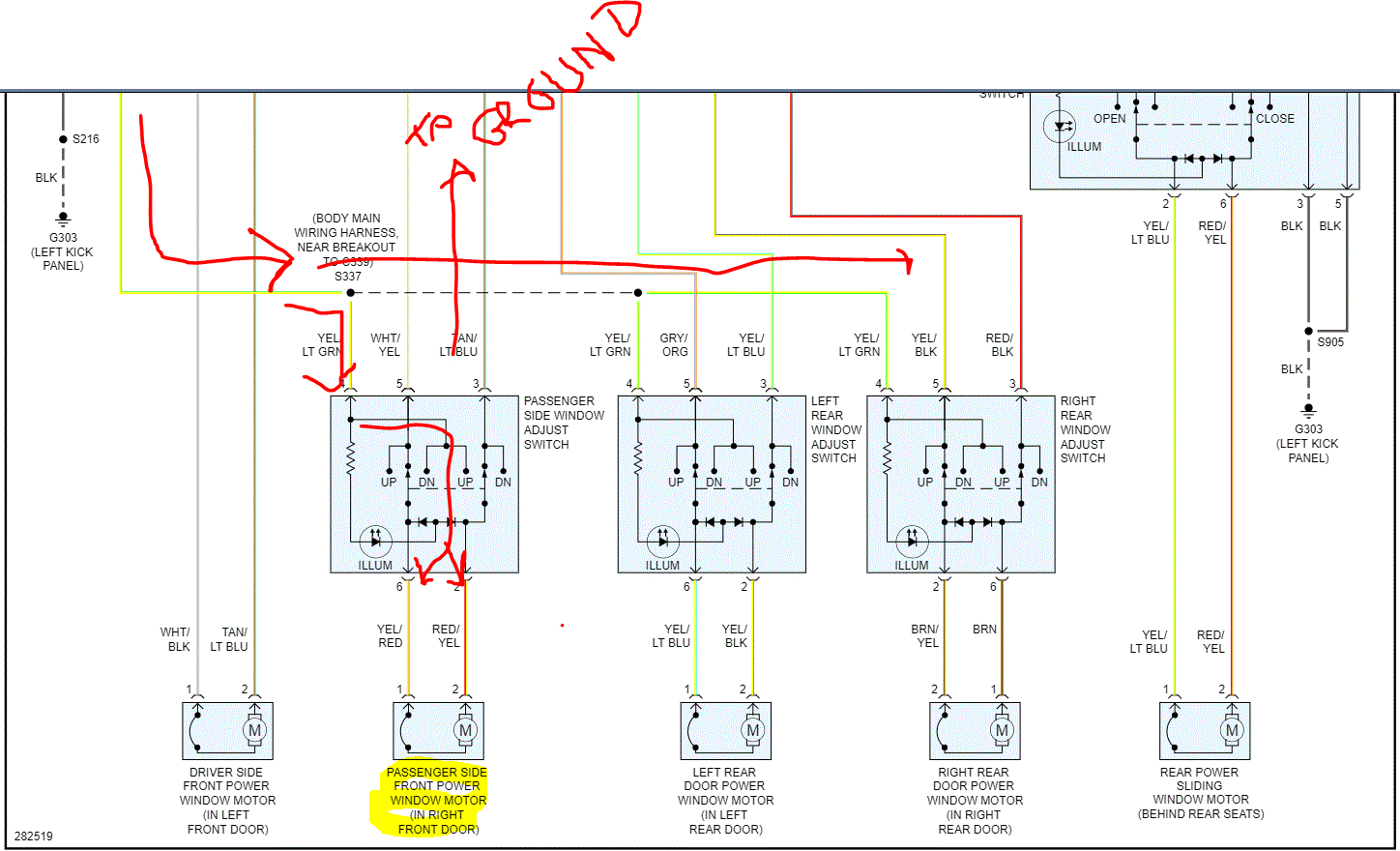

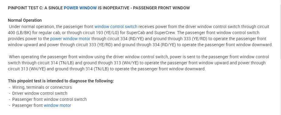

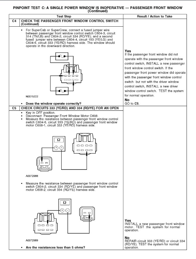

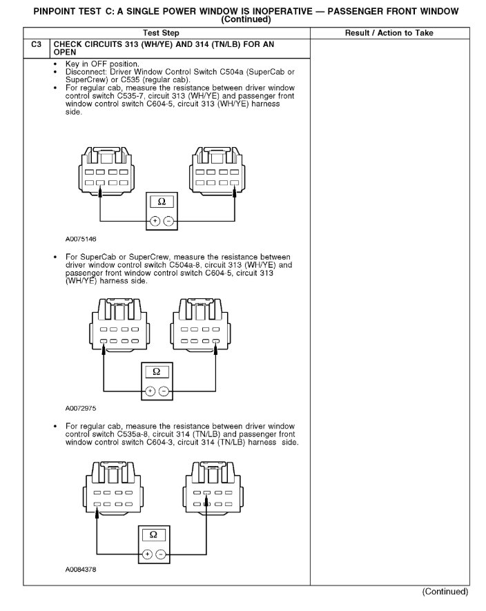

Here is the wiring diagram. They do not have a separate fuse but all the windows run through the master switch. Take a look at the testing I attached as well. The first page of it give a good description of normal operation which will help figure out what the issue is.
However, to get the window up now, jump the yellow/light green wire to the red/yellow wire. That will get the window up if you need it until you can get to it and figure out the issue.
Let me know if you have questions running through the testing. However, if the motor doesn't work when you jump it then most likely the motor is the issue.

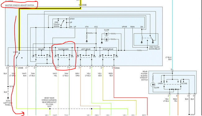

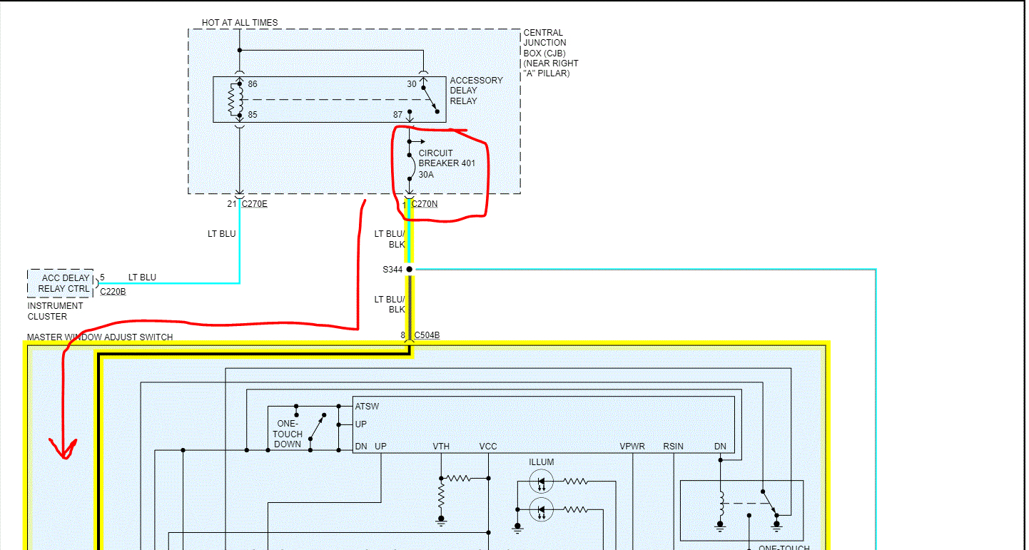

I will try my best to explain how the system works. First, if you have power to all windows but one, the fuse is good and there are no other fuses.
Now, here is where people get confused. There is power to all window switches all the time when the key is on. How they work is this. When you select up or down, the switch provides a ground allowing the motor to run.
I have attached three pics below. They are from the wiring schematic of the system. I have placed an arrow showing the direction of power flow. You will see it all starts at a circuit breaker, then to the main switch (driver's side), then through the window lock switch. If the switch is in the lock position, no power goes to the other switches. Once you unlock that switch, it sends power to the others.
Next, once power is in the switch, it is distributed to the motor. Here is where it's tricky. There are only two wires at each motor. If the switch is in the up position, power goes through one of those two wires and ground is provided through the other. If down is selected, power is provided through the opposite wire ( changing polarity ) and ground then goes through the opposite one. By changing the directions of power flow, you change the polarity in the motor causing it to run different directions.
The last pic is (and I'm sorry for the sloppy writing) shows how power is then sent to ground via the switch.
Now based on your problem, either you have a bad motor or a bad switch at that door. The only other thing I can see that could be wrong would be if the splice for power to the passenger side switch came loose. However, I suspect that would cause failure to the rear windows because power is supplied through the same wire. If it was a bad ground or wiring issue, the other windows (rear) wouldn't work either. What I will need you to do is this. Simply see if there is power to the motor when the switch is in the up or down position. If there is, replace the motor. If there isn't, replace the switch.
