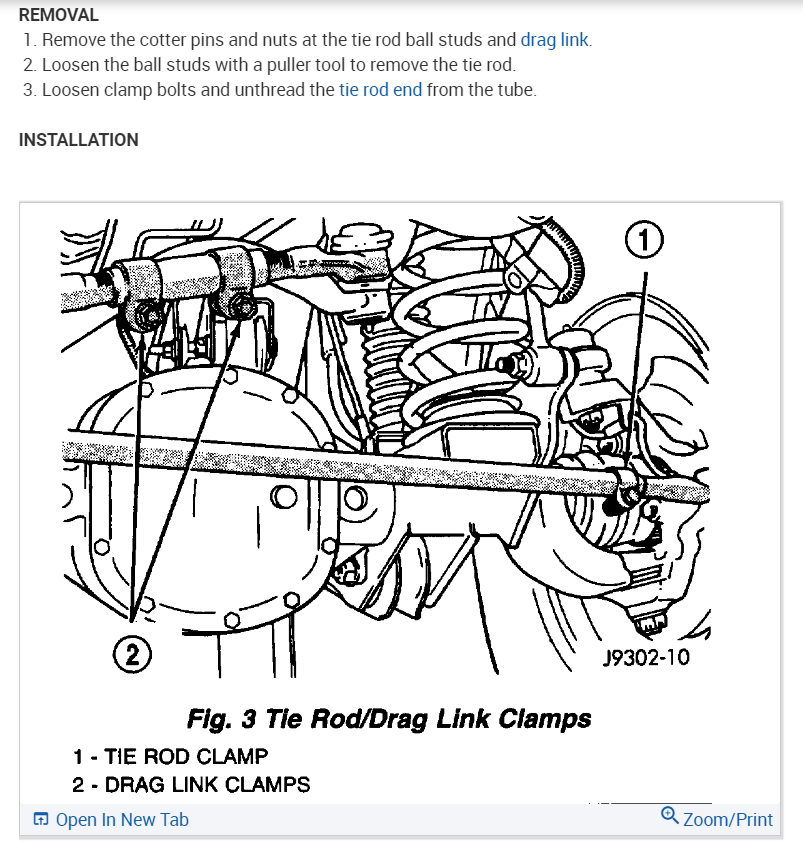

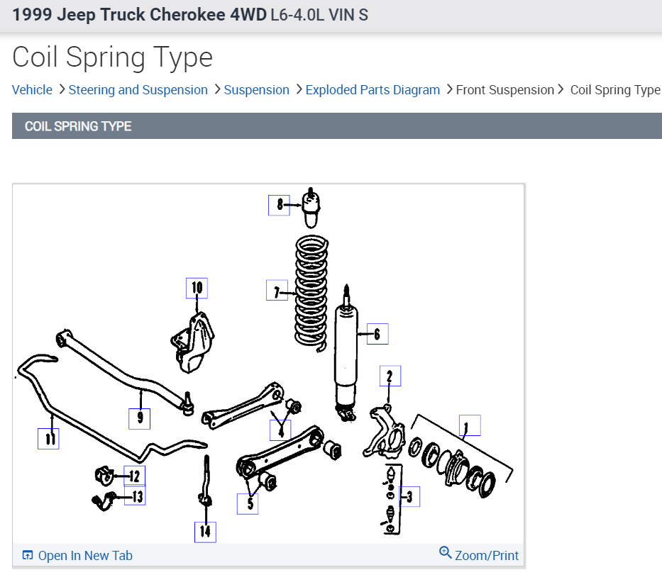

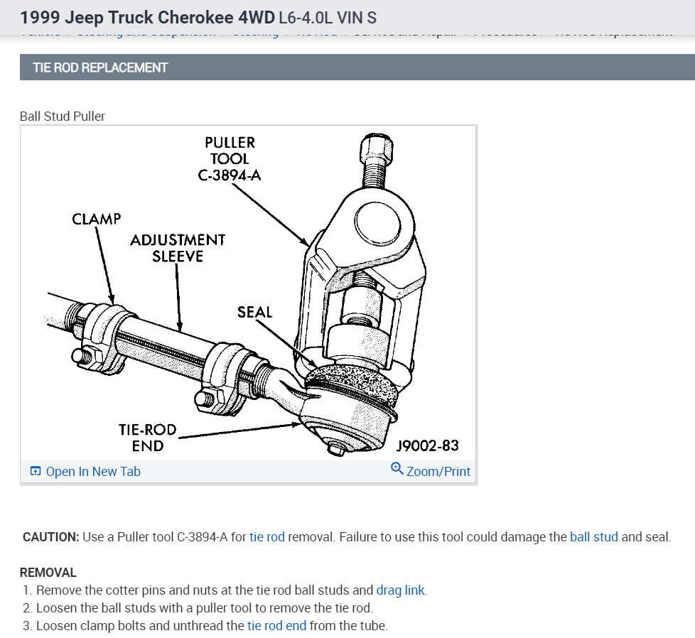

Yep, if the tire is leaning inward it sounds like a control arm got bent as well, if you can upload an image a can tell for sure. I added some images so we can look at what the problem might be. Please go over them and get back to me. Check out the images (below). Let us know what happens and please upload pictures or videos of the problem so we can see what's going on.
