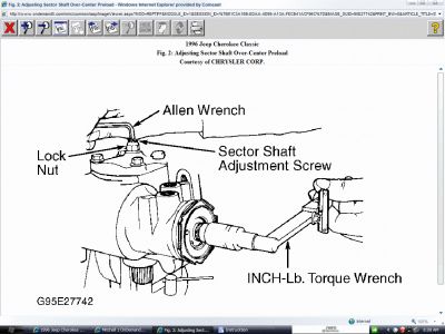

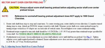

MERLIN2021
  • 17,250 POSTS
Go to an alignment specialty shop and have them adjust the steering box. Sector shaft is out of adjustment, or worn out completely.

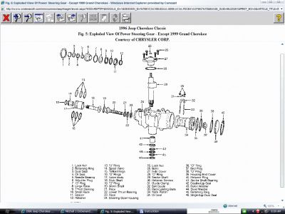

MERLIN2021
  • 17,250 POSTS
The sector shaft runs top to bottom and the steering part called the pitman arm attaches to it. An adjustment shouldnt be too expensive. A new box is! A used one may be an acceptable alternative.

MERLIN2021
  • 17,250 POSTS
Either place can do it, but you can only tighten it so much...if it's tightened too much the shaft can actually be sawed in half, at which point you loose steering! Make sure whereever you go they know thier stuff! You might want to think about a junkyard for this part...look for one that has no evidence of leaking...
