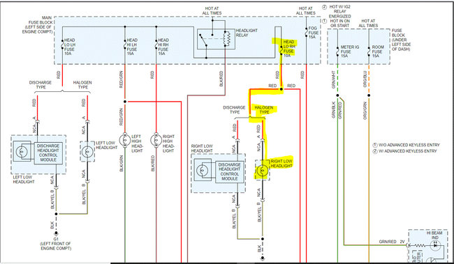

I suspect it is a poor connection at the light. You questioned the light socket, what happens if you wait until it doesn't work and then wiggle the socket and wiring? Keep in mind, a bad connection will create heat, so that could be causing it to shut off.
If you are questioning the socket, when it doesn't work, see if power is present as well as a ground. If both are present, then the socket is the likely cause. Keep in mind, where the wire enters the socket can have a poor connection as well, so check that too as well as where the fuse connects in the fuse box.

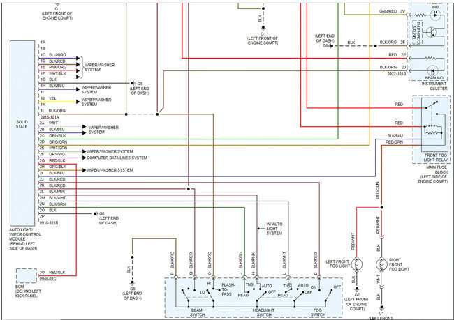

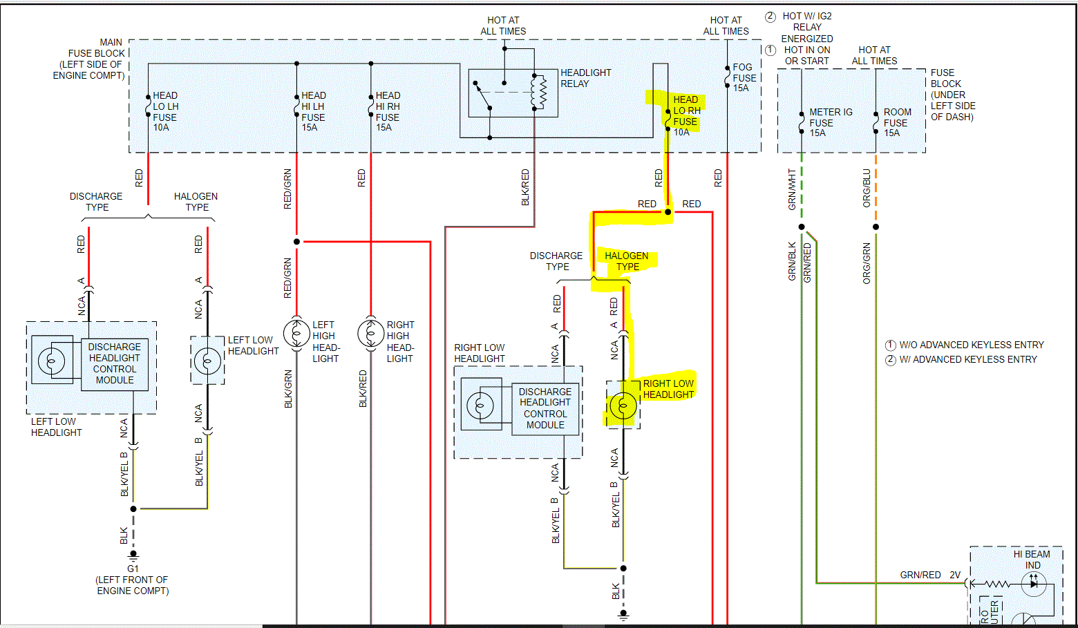

I attached the wiring schematic for the headlamps. I highlighted a few things to make it easier to find. Note that I had to cut the schematic in half to make it readable. I did overlap them so you can follow from one to the other.

You are absolutely correct. I believe there is a problem in the connector in Mazda 6 cars.
As I needed to fix the issue quickly, yesterday I took the vehicle to the nearby mechanic and he cut the connector and connected with a replacement. He did charge me $200.00 which I believe is a little high.
Thanks for diagnosing the problem correctly and mentioned that the heat is shutting the light off due to bad connection.
I am guess this will resolve the issue. If i do not post any additional reply please consider this issue as closed. Thanks a lot once again for your inputs.
