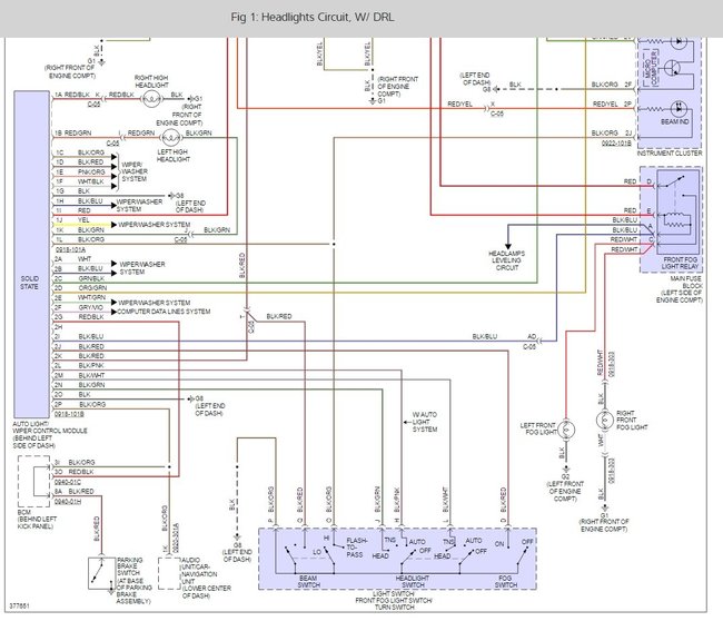

Right side low beam headlight will not work. I tried replacing bulb, then verified fuses, then swapped bulbs left to right which verified bulbs are okay, but problem on right side. Rechecked fuses with multi-meter and these are good.
This appears to be a common problem based on the internet complaints but i have not found a common remedy.
Any thoughts or suggestions would be appreciated.
Where is the ground located, to check it? Is there a relay that can be checked easily?

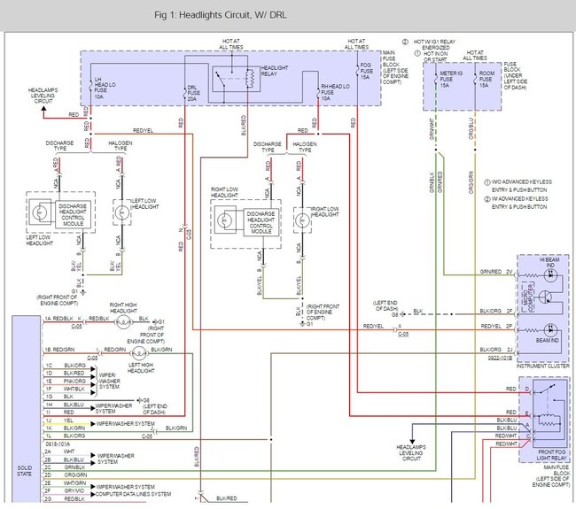

There are two separate fuses for left and right headlight. Here is a wiring diagram and a guide to help you test for power and ground for the headlights.
Best, Ken

Correct, separate fuses and all tested ok.
The ground wire appears tight and clean (assuming I found the correct one).
Thanks for the schematic, I gues I will start at the fuse box and work up or down from there.
Seems like a very common problem according to posts, thought I would find what others did to fix and start with those, but guess not.
Apr 12, 2017 at 12:06 PM
  • 55,273 POSTS
Do you have power at the fuses? You can see by the wiring diagram that the relay supplies power to both headlights.
Use a test light to see when you loose power somewhere.
Best, Ken
