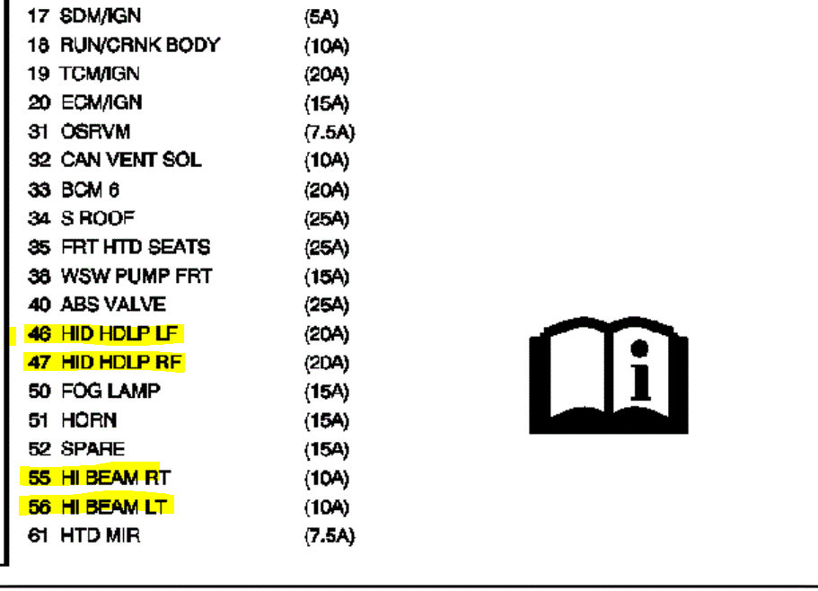

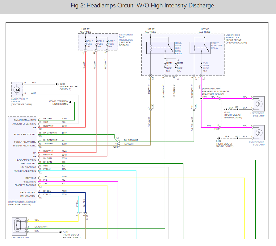

Light went out, changed it but still not working.
Apr 19, 2020 at 11:06 AM
  • 110,244 POSTS

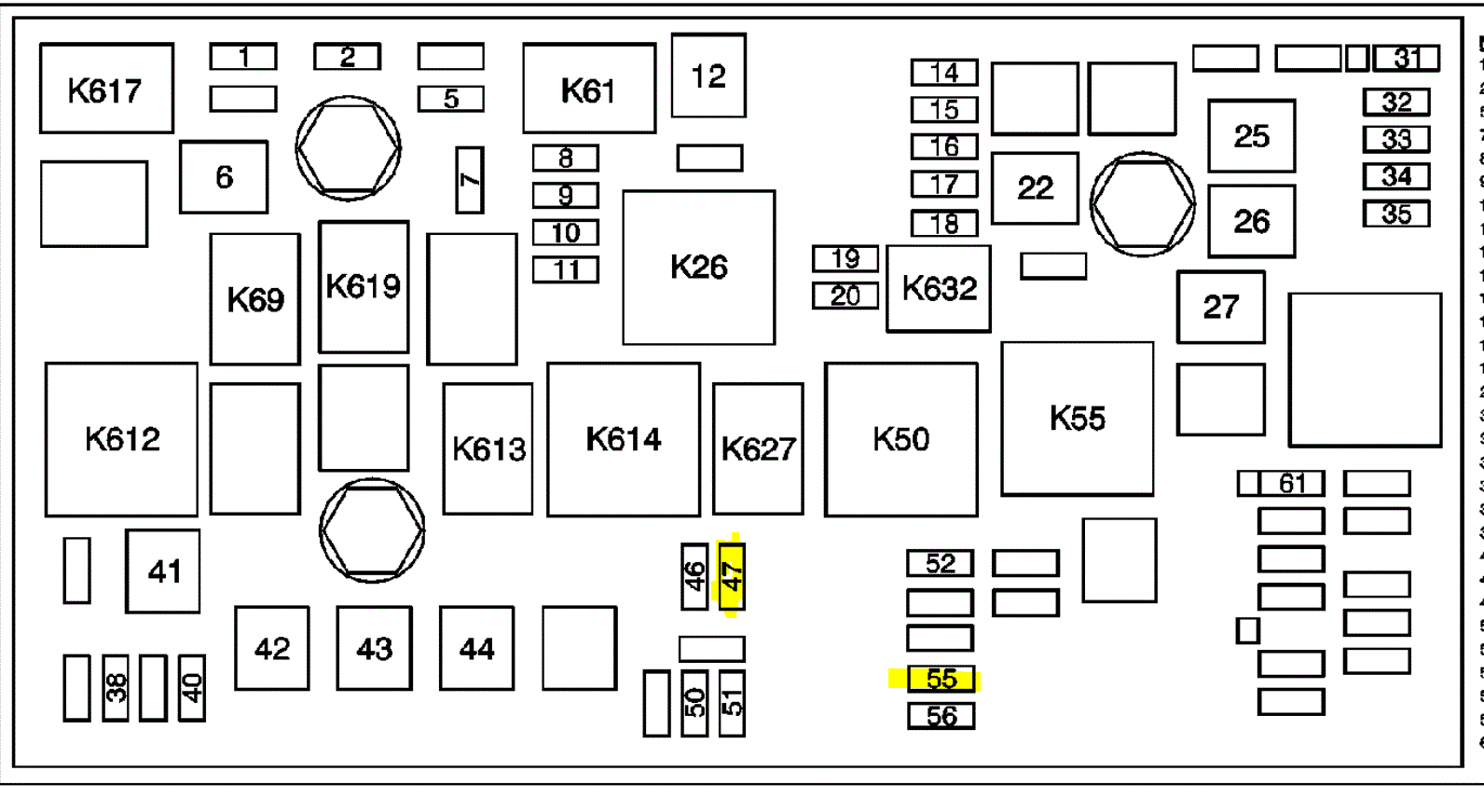

Each side and each beam selection has its own fuse. Have you checked fuses? If you look at the two pics I attached, I highlighted all four fuses for the headlamps. In pic 2, I attached a copy of the under hood fuse box and highlighted both fuses related to the right side, passenger side. If you haven't, check those first.

I have checked the fuses and also did a circuit test on it, and still doesn't work. At this point do I need to bring it into a dealership?
Apr 20, 2020 at 3:03 AM
  • 55,423 POSTS

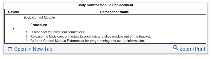

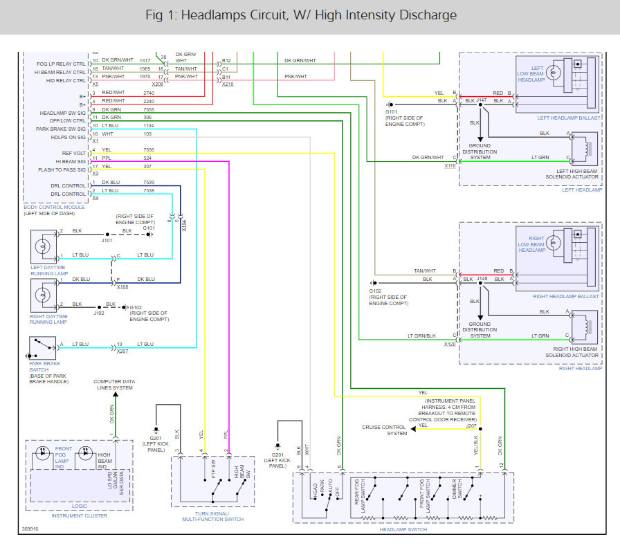

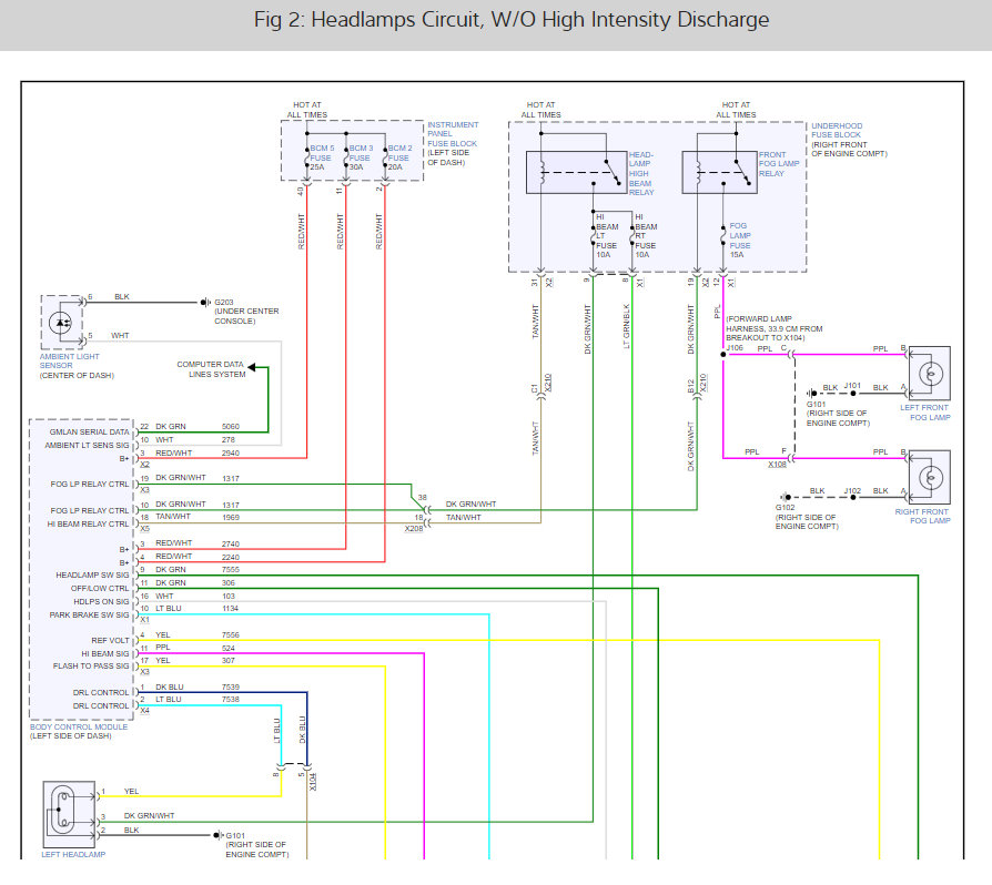

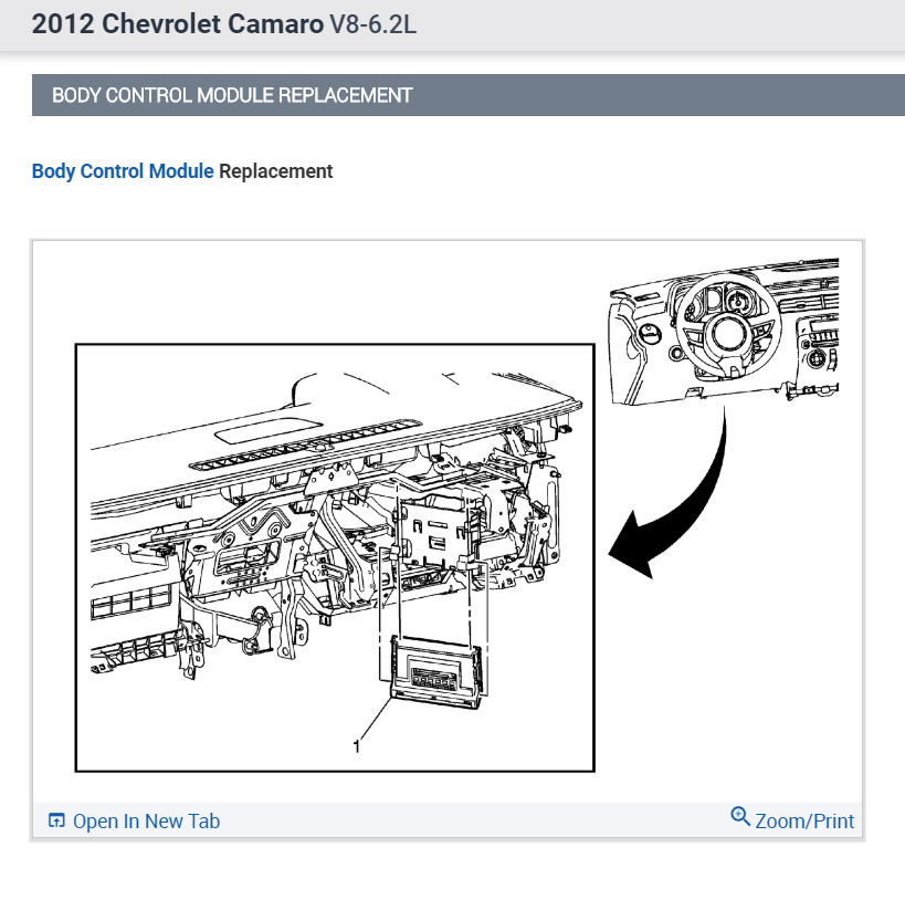

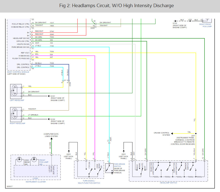

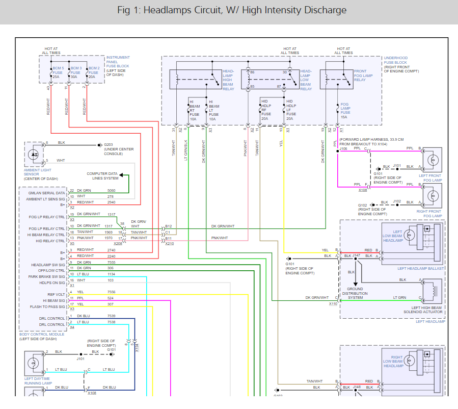

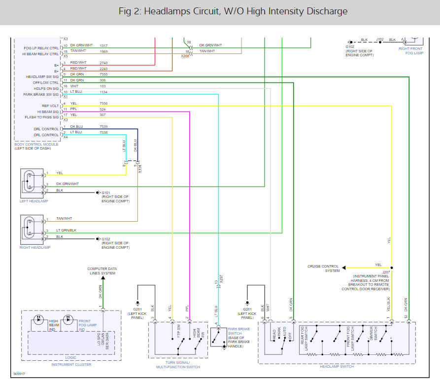

does this have high intensity headlights? if so it could be the ballast that has gone out. here is the headlight wiring diagrams so you can see how the system works. If okay the BCM has gone out here is how you can replace it.
Body Control Module Programming and Setup
