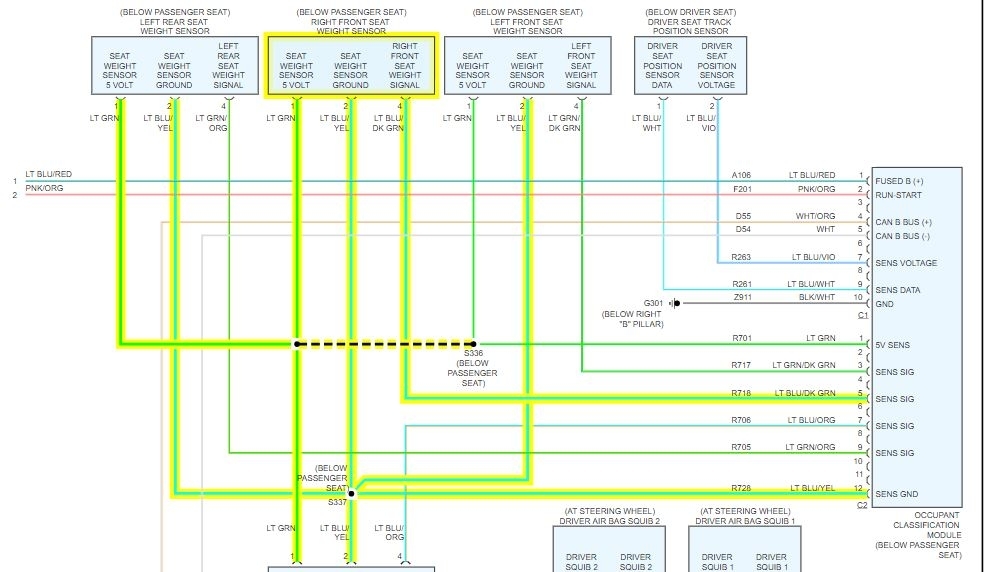

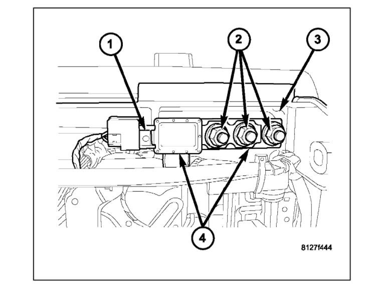

The seat weight sensors (4) are strain gauge-type units. The electronic elements of the sensor are encased in a potting material within the molded plastic sensor housing. Four sensors (4) are used in the Occupant Classification System (OCS). A sensor is located at each corner of the passenger side front seat.
The strain gauge for each sensor is secured by three screws and nuts (2) between the seat cushion frame and the seat adjusters (3). A molded connector receptacle (1) integral to each sensor housing is connected to the vehicle electrical system through a dedicated connector and take out of the passenger seat wire harness beneath the seat cushion frame.
The seat weight sensors cannot be adjusted or repaired and, if faulty or damaged, the entire sensor must be replaced.

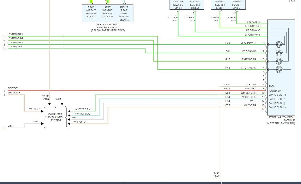

The seat weight sensor units are designed to sense the relative weight of a load applied to the passenger side front seat, which provides a logic input to the microprocessor of the Occupant Classification Module (OCM). When a load is applied to the seat, the strain gauge of each sensor is flexed causing a change of electrical resistance through the strain gauge. These changes in resistance are measured by the sensor and the internal sensor circuitry changes the sensor output voltage.
Each weight sensor receives a nominal five volts and a ground through parallel hard wired circuits from the OCM. The OCM then monitors the output voltage of each sensor on dedicated hard wired data communication circuits. The hard wired circuits between the sensors and the OCM may be diagnosed and tested using conventional diagnostic tools and procedures. However, the most reliable, efficient, and accurate means to diagnose the seat weight sensor inputs to the OCM, and the electronic message communication between the OCM and the Occupant Restraint Controller (ORC) requires the use of a diagnostic scan tool. Refer to the appropriate diagnostic information.

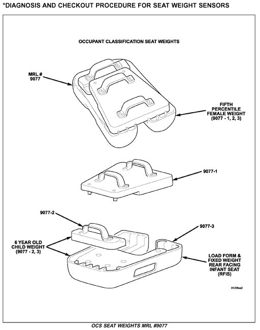

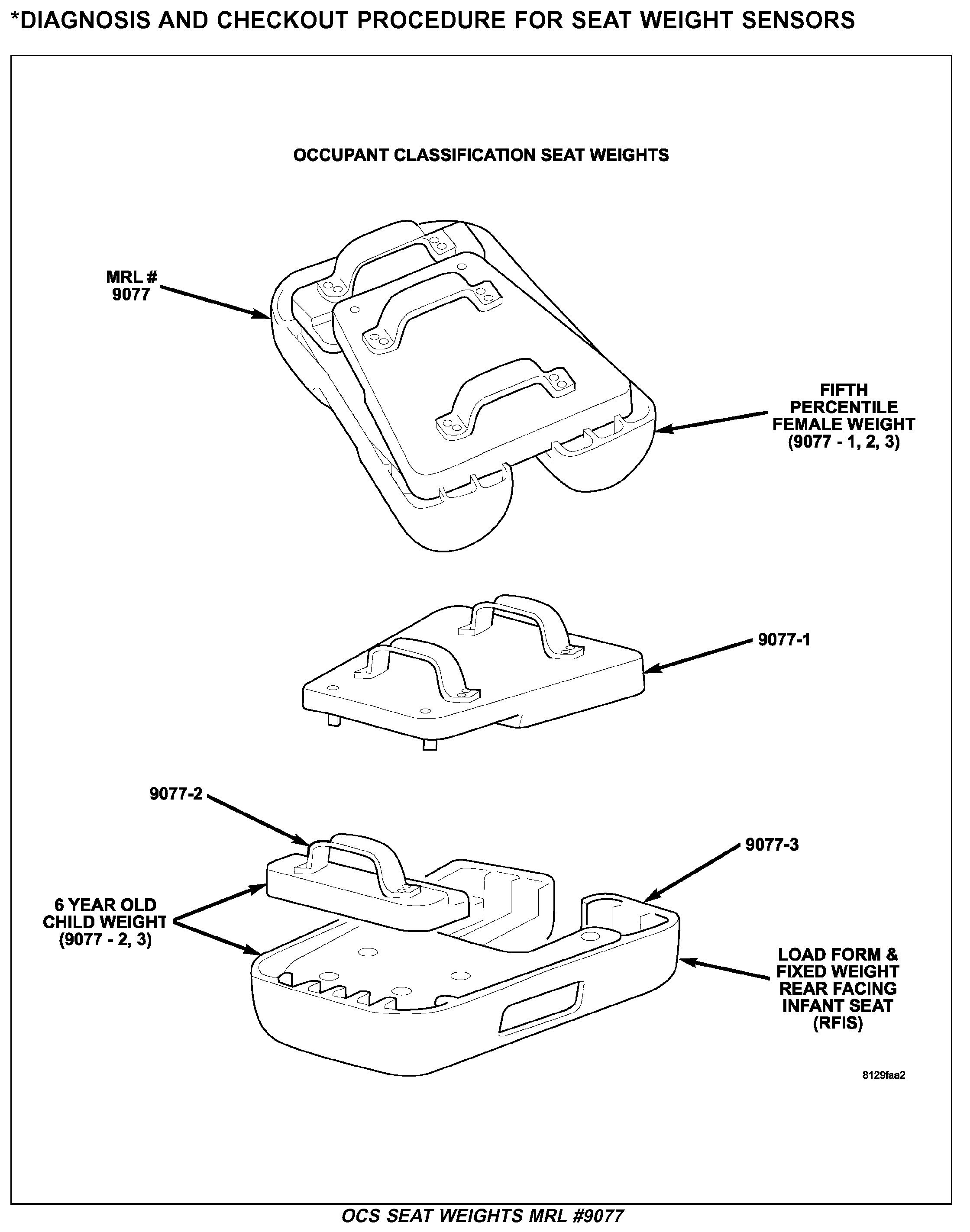

The attached pics correlate with the directions.

NOTE: Failure to follow test instructions or aborting the test will cause faults to set when performing the Occupant Classification Module System Verification Test. To prevent faults due to process errors: Verify That All Tests Steps That Led You Here Were Performed As Directed; Verify That The Ignition Is In Run; Wait 30 Seconds After Changing The Seat Weight Before Proceeding To Allow The System To Stabilize; Only Press Scan Tool Buttons When Directed To Do So; & Perform The Occupant Classification Module System Verification Test To Completion.
Reinstall the seat in the vehicle. Turn the ignition on. With the scan tool in OCM, select More Options, select System Tests, and select Occupant Classification Module System Verification Test. Run the test by following the instructions displayed by the scan tool. When the test is complete, Go To 1
