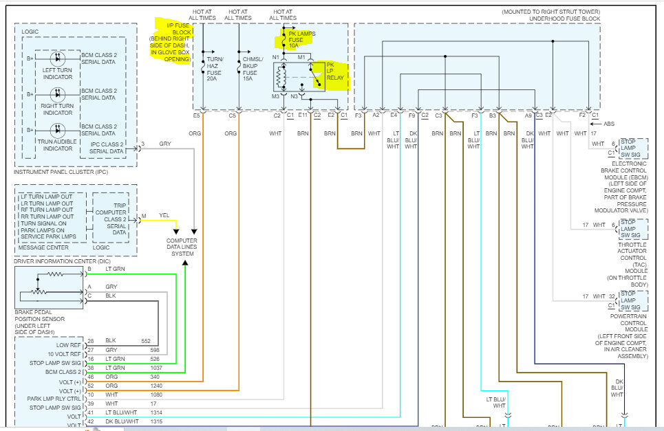

Hello, I have the car listed above GTP, and the parking lights are the only thing not working. Brake lights and turn signal lights are working. I changed all bulbs and fuse I'm just now at a lost any help where to go now we'll be great.
Sep 14, 2023 at 12:17 PM
  • 110,244 POSTS

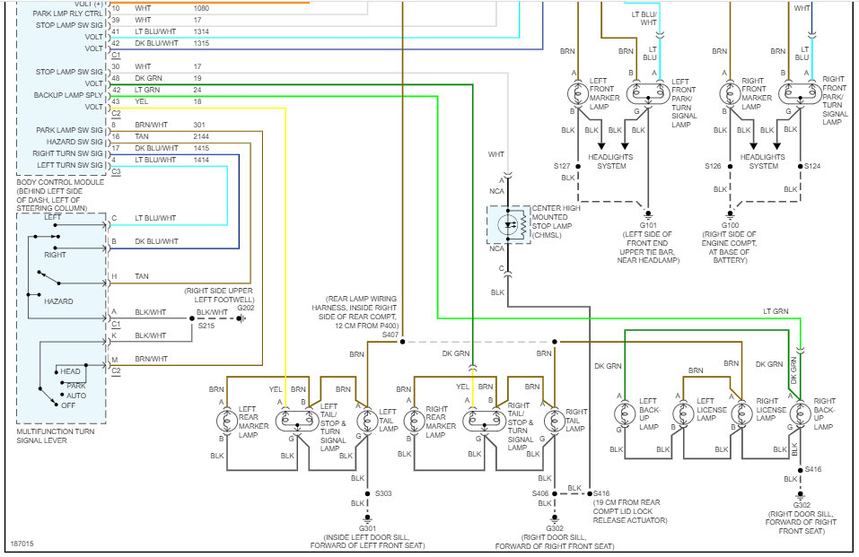

First, I attached the wiring schematic below for the exterior lighting circuits.
You mentioned the fuses are good. Did you confirm there is power to and from them? If not, check that. The fuse may be good but there is no power to transfer.
Next, there is a parking light relay. Have you checked that as well? If not, switch it with a different relay having the same part number to see if that changes it. If there is no change, we need to check the circuit.
Here is a link that explains how to test a relay and the relay circuit:
Let me know what you find.
