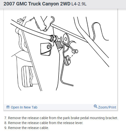

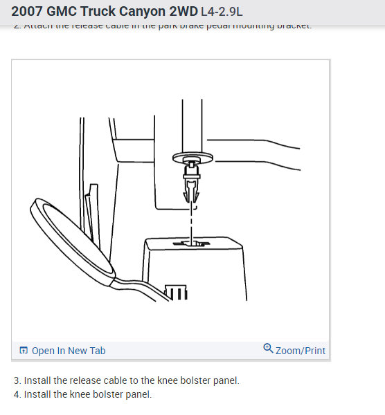

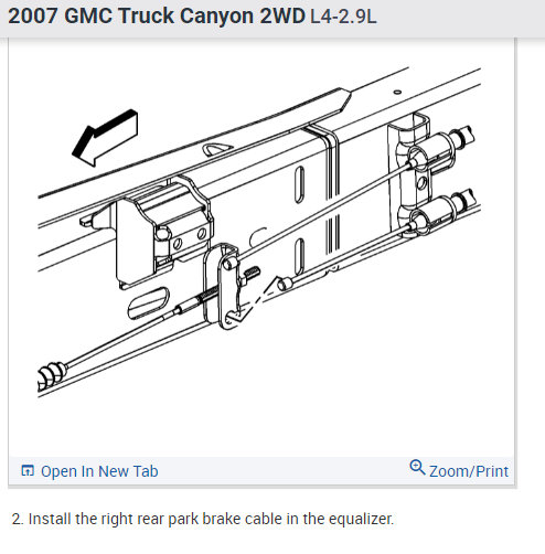

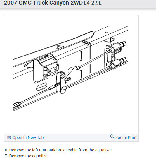

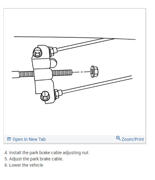

The parking brake is stuck engaged. I have tried repeatedly pushing and releasing the parking brake pedal and rocking the truck back and forth, but it will not release.
Oct 3, 2021 at 4:29 AM
SQM
  • 6,383 POSTS

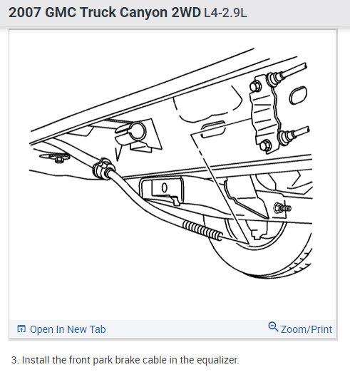

This could be due to a disconnected brake cable or a seized brake.
Frist inspect the brake cable. Make sure that it is connected securely and does not have a broken or damaged component.
If the cables checks out then the issue is likely within the brake.
https://www.2carpros.com/articles/parking-brake-shoe-replacement

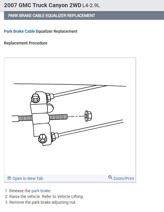

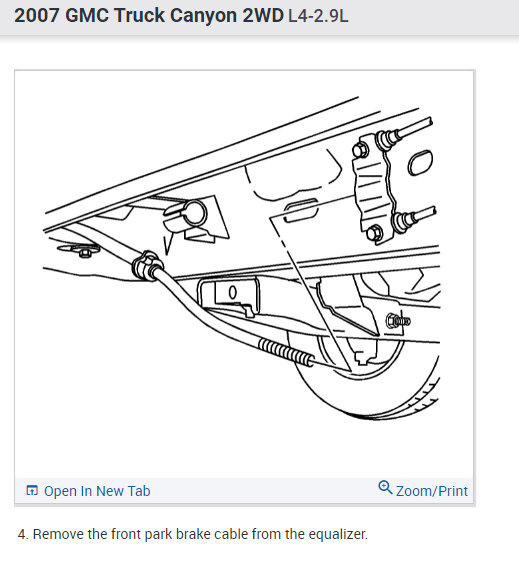

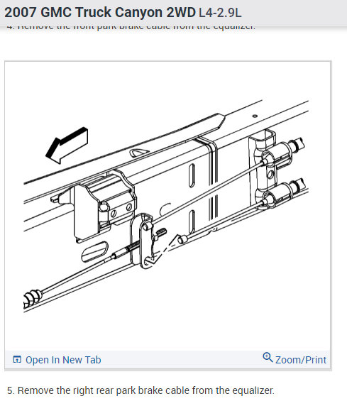

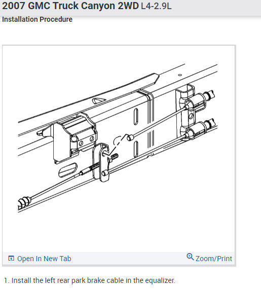

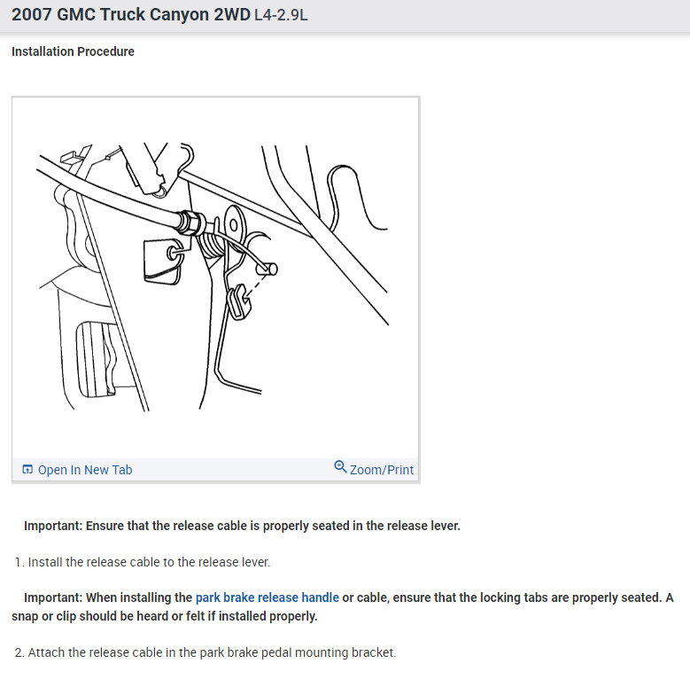

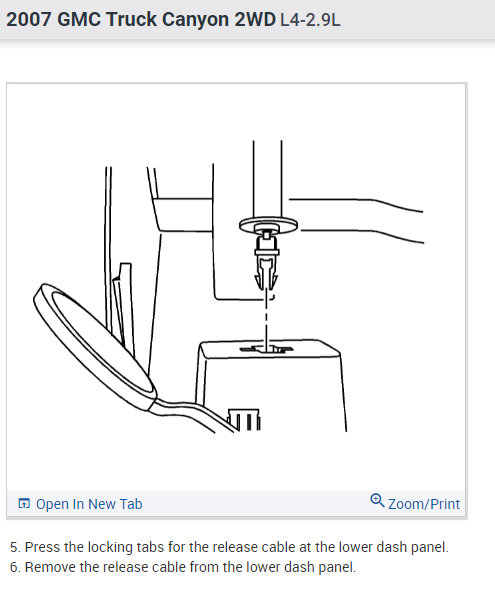

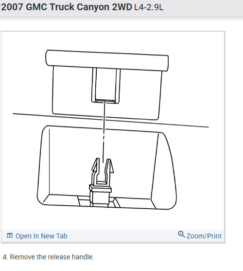

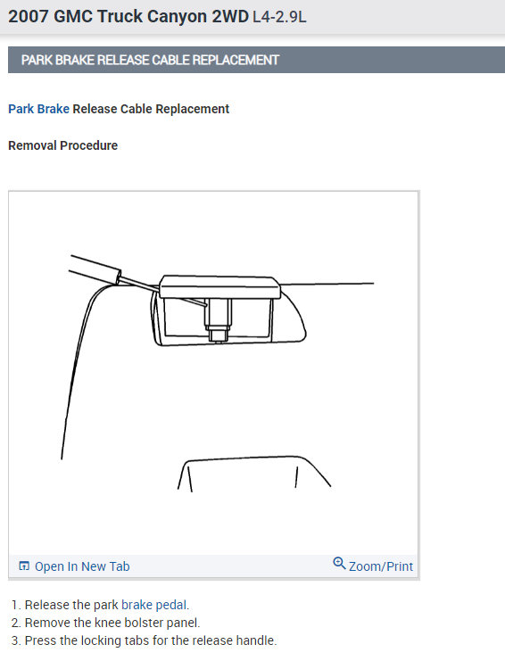

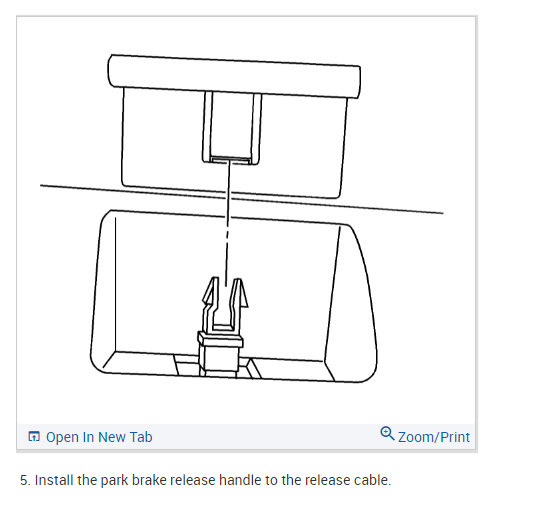

I have attached the diagrams for the brake system from the pedal to the equalizer.
Please let me know what you find.
