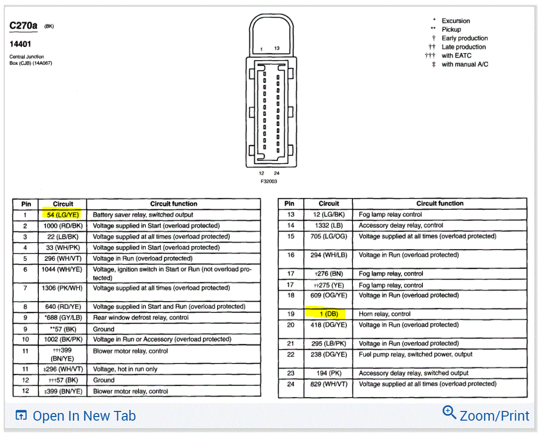

Hello again, here is a new one: I pulled instrument cluster out to look for the hidden gremlin only thing I found was on the plug that goes into instrument cluster one of the wires has been cut and spliced into another. I did a little research and found that if the radio and windows working you can cut this wire and splice into one that it is spliced to and will again have power to radio and window and they now have constant power. Could this be where my power is coming from?
Wednesday, February 23rd, 2022 AT 9:45 PM
  • 109,885 POSTS
It is very possible. What color are the wires that have been spliced?
+1
Thursday, February 24th, 2022 AT 5:59 PM
ALEX ESGATE
  • 39 POSTS
Wire colors are pin #1green and yellow is cut and spliced into pin #19 black and purple wire. Now the overdrive light flashes and my 4-wheel drive low range light is on but not in 4x4.
Monday, February 28th, 2022 AT 8:20 PM
  • 109,885 POSTS
Pin 1 is green and yellow for the battery saver. Pin 19 should be dark blue for the horn relay. See attached.
