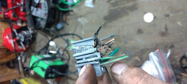

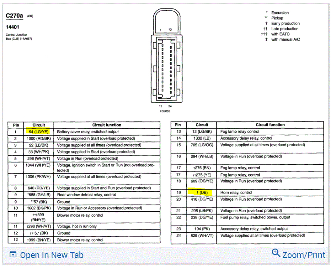

hello again, here is a new one: i pulled instrument cluster out to look for the hidden gremlin only thing i found was on the plug that goes into instrument cluster one of the wires has been cut and spliced into another. i did a little research and found that if the radio and windows working you can cut this wire and splice into one that it is spliced to and will again have power to radio and window and they now have constant power. could this be where my power is coming from?
It is very possible. What color are the wires that have been spliced?

wire colors are pin #1green and yellow is cut and spliced into pin #19 black and purple wire. Now the overdrive light flashes and my 4-wheel drive low range light is on but not in 4x4.

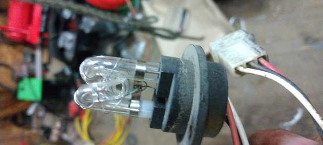

so, i just got a chance to pull the lights that are not shutting off. i forgot to pull the headlight switch so first one i pull left front marker light, they shut off and now work correctly again. Please send holy water or good booze because this thing is going to drive me nuts. What do i need to do to fix it?

PS: did i mention the marker lights have been replaced with led bulbs green led bulbs if that matters?

As far as the LED, did someone rewire a new socket for them? If you install incandescent lights, does it make a difference?

No, it still has original plug and I put factory bulbs in they wouldn't shut off again I only had tile to check the front lights tonight. I will have more time tomorrow. I super appreciate all time and effort you are putting into helping me.

Since the lights worked normally when you removed one bulb, check that light socket and determine which wire is supplying power when the lights are off.
