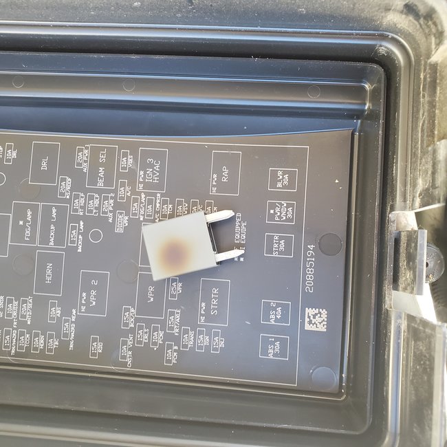

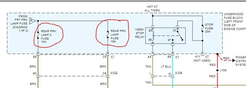

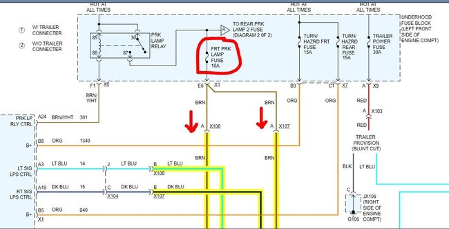

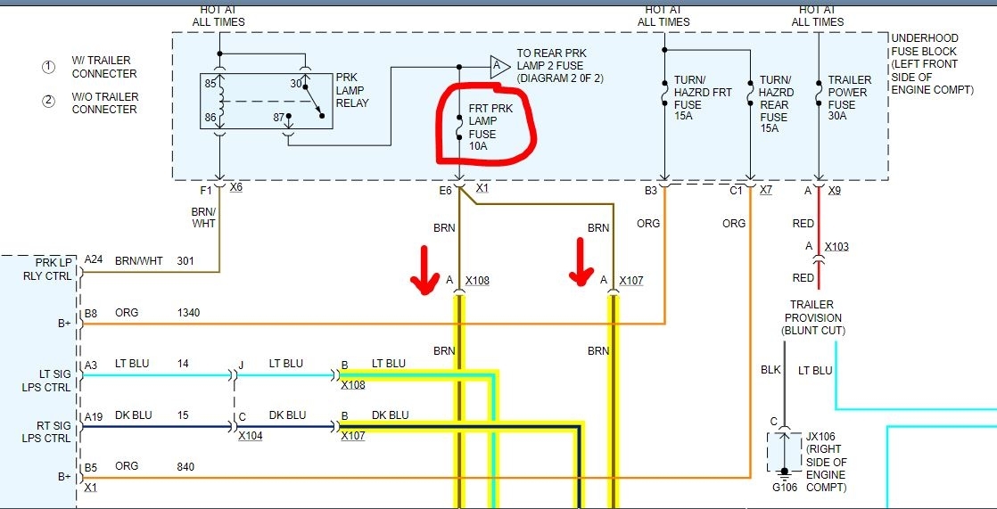

The first thing we need to check are two fuses under the hood in the power distribution box. If you look at picture 1, it shows the fuses I am referring to.

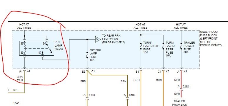

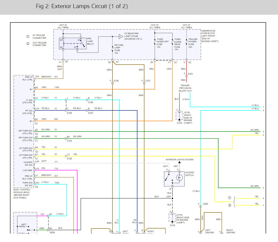

Next, I need you to check the parking light relay under the hood as well. See pic 3.
Here is a link that shows how to test a relay. However, if there is a relay in the box that has the same part number, switch them to test it.

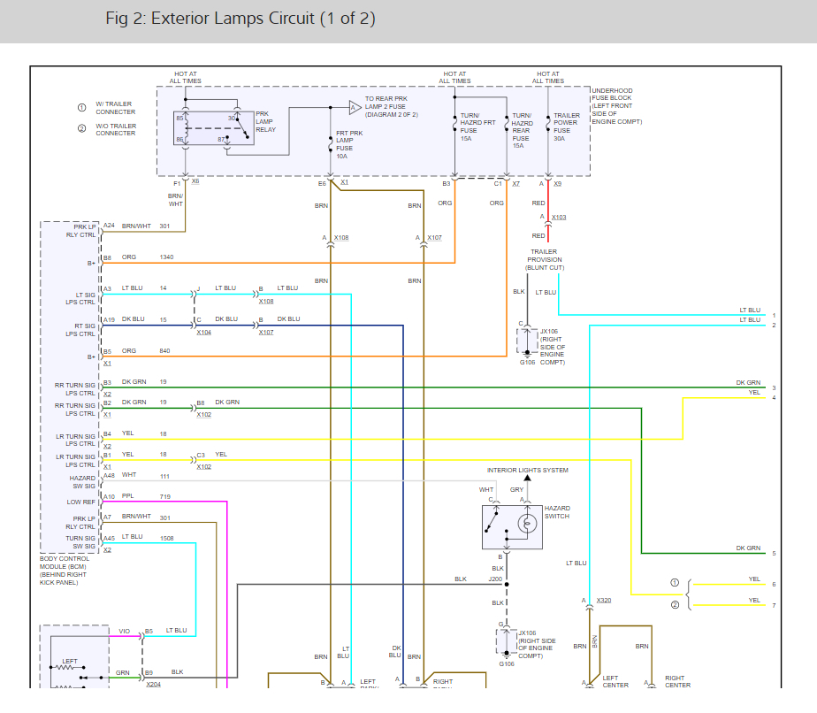

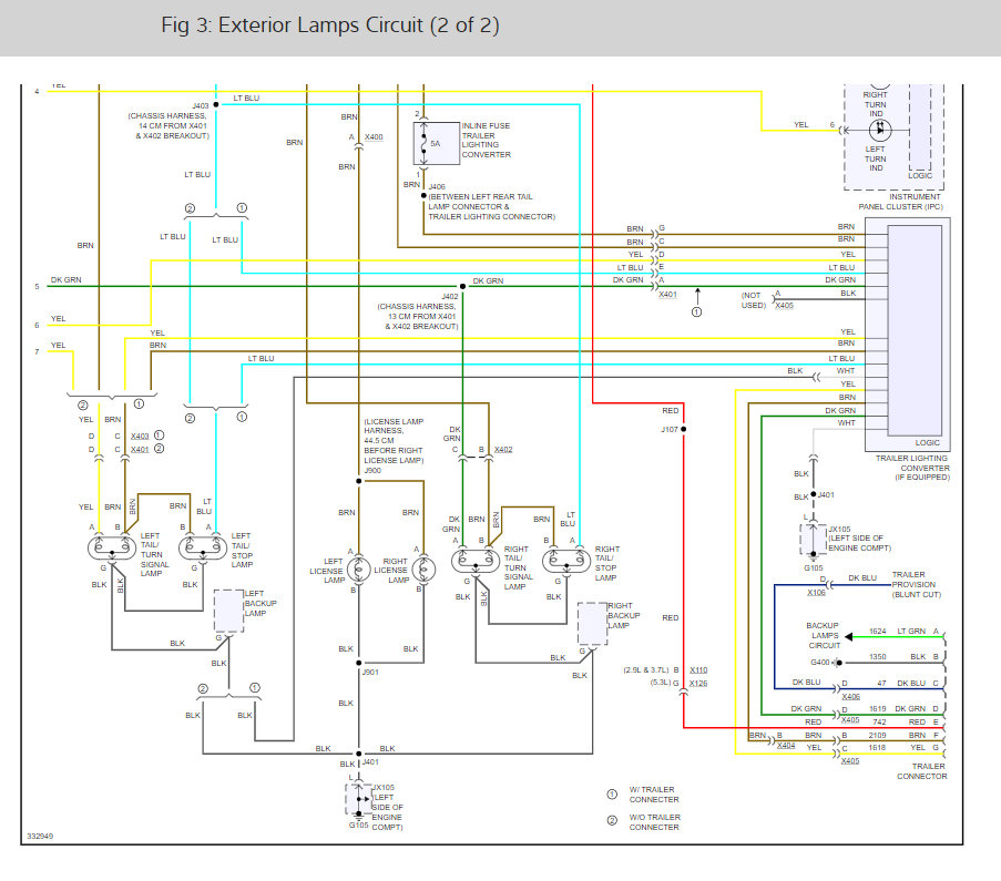

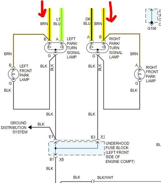

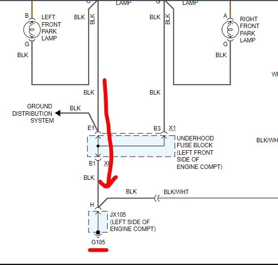

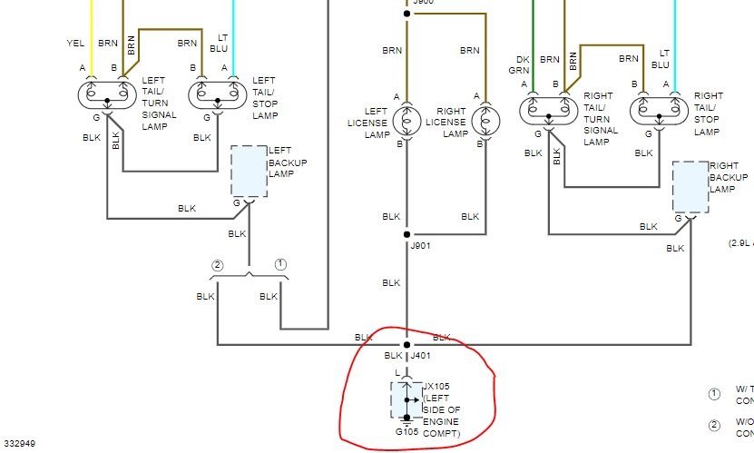

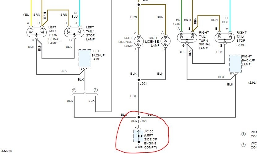

Now, if nothing works on the rear, the only common element is ground which is spliced in several places. Take a look at picture two. If that is the case, check that ground to see if it is loose, corroded, or damaged.

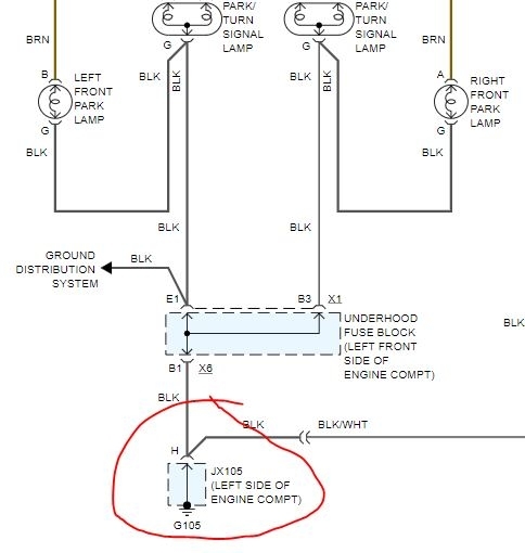

It is just the front park lights, my husband changed my battery wire connections. Could something he did wrong cause this? If so, what should I look for to determine if that's the cause?
Nov 28, 2019 at 12:32 PM
  • 110,244 POSTS

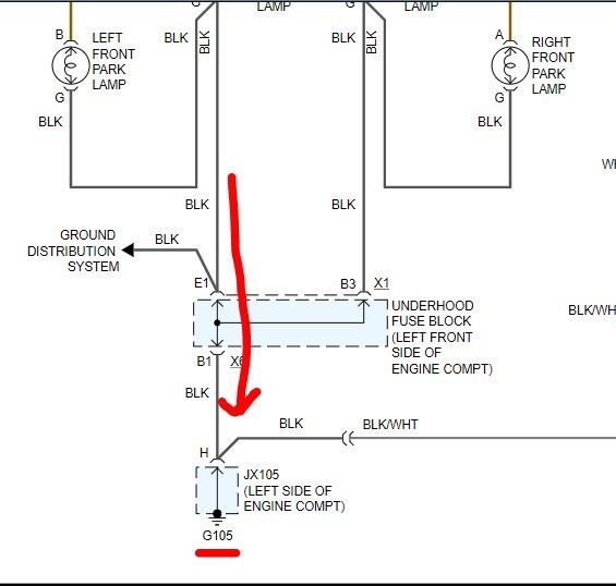

The ground for the front lights is near that area. Maybe he caused the ground to fail. See the attached picture.

I believe I found the problem this is the PRK/LAMP labeled 15328866 that I pulled out and I sent a pic for you to see.
Dec 1, 2019 at 3:36 AM
  • 110,244 POSTS
Sorry I missed your questions. I wasn't online at that time. The fuse you show in the pic looks burnt. Have you replaced it and has it fixed the problem? That appears to be the relay that I mentioned in one of the prior threads. Let me know if that took care of it for you.

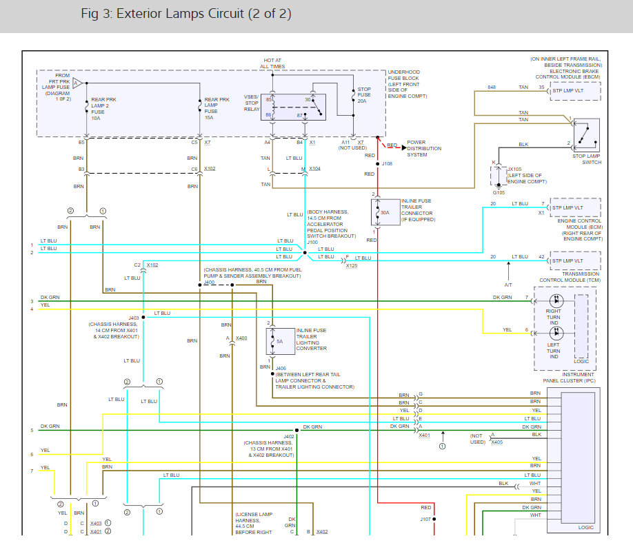

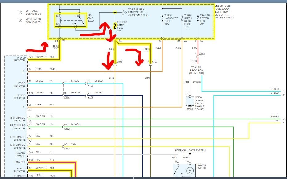

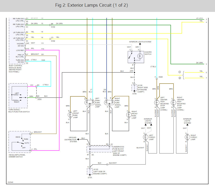

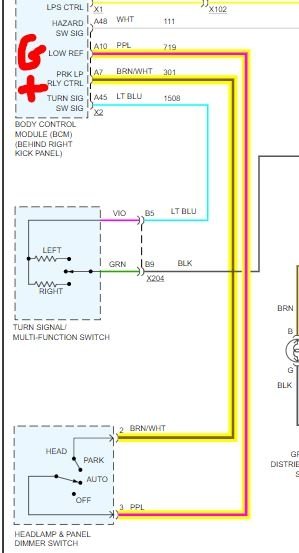

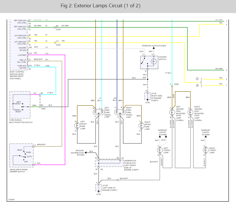

There really isn't a lot left. Have you confirmed that the ground wasn't damaged? If you look at the attached pics, (I had to break the schematic into several parts) you'll see that power goes via the switch to the body control module. When you turn the lights on, power is sent via the switch to the BCM and the out of the BCM to the park lamp relay. From there it runs to the front parking lights and finally to ground. Since you have no power at the light socket, it can't be a ground because you provide a new ground with a test light. So the problem is before. At this point, you need to work backwards. We know the fuse is good and has power, so the break has to be between the fuse and lights.
If I had your vehicle, I would start by checking and confirming that power from the fuse is present in the brown wire right at the fuse box. Note that it is provided by one pin but splits two different ways. If power is present, then you need to follow those wires all the way to the lights to determine where power is lost. Since you lost power on both sides, I would assume the problem is right at the box and no further.

Water will usually cause the bulb to fail, but they can also play havoc on connections. Have you checked the ground I provided earlier in this thread? Since they work and then don't and then do again, it has to be a loose or poor connection. Since this all started after replacing the battery, I still suspect a ground issue. I have to ask simply because I don't remember. But when they are not working and the lights are on, do you have power to the light sockets? If you do, then I really suspect it is a ground issue because when using a test light, you create a new ground.

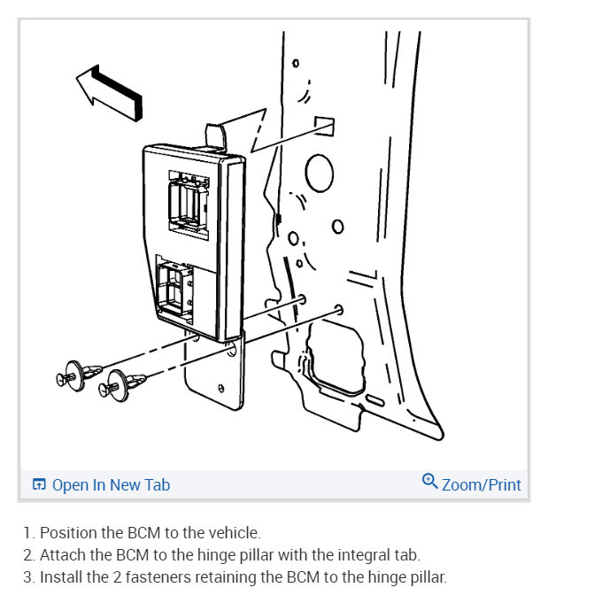

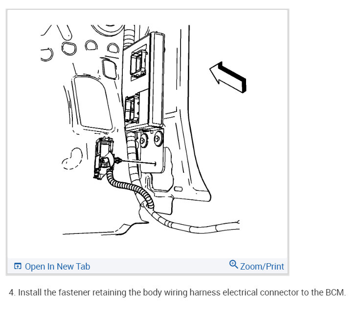

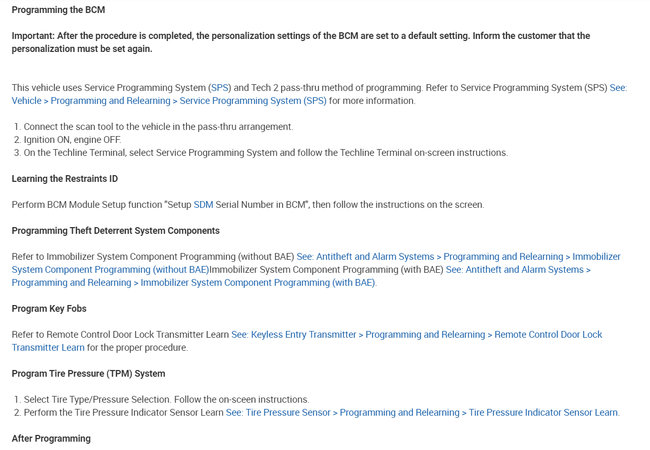

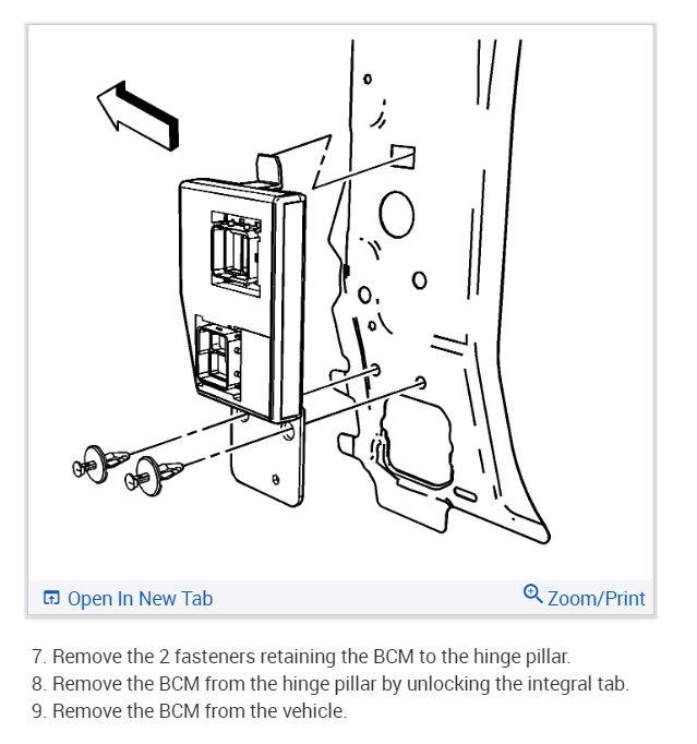

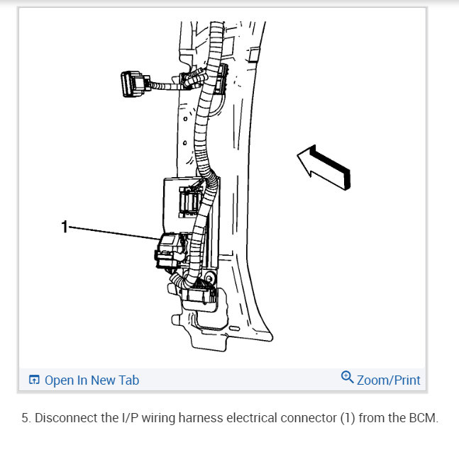

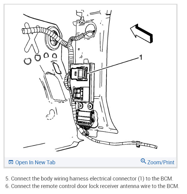

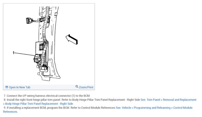

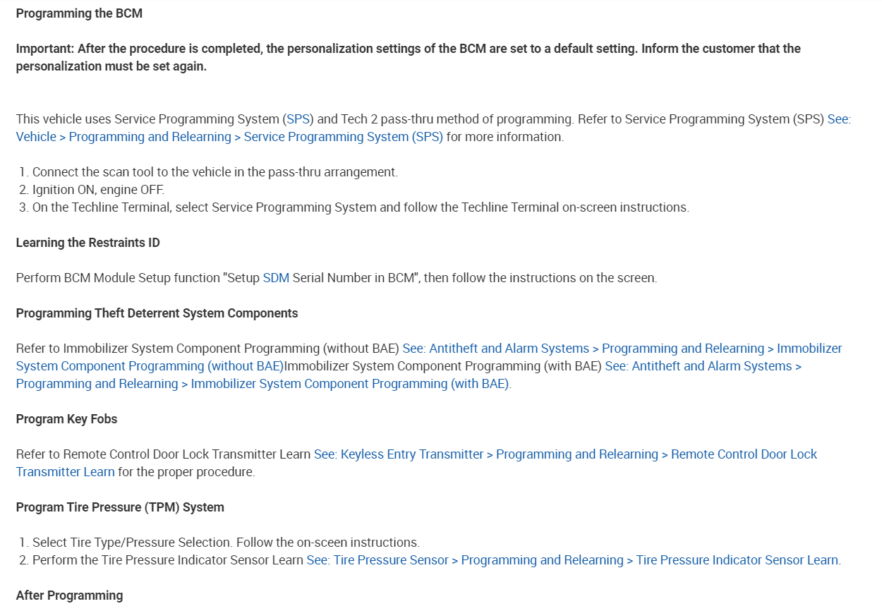

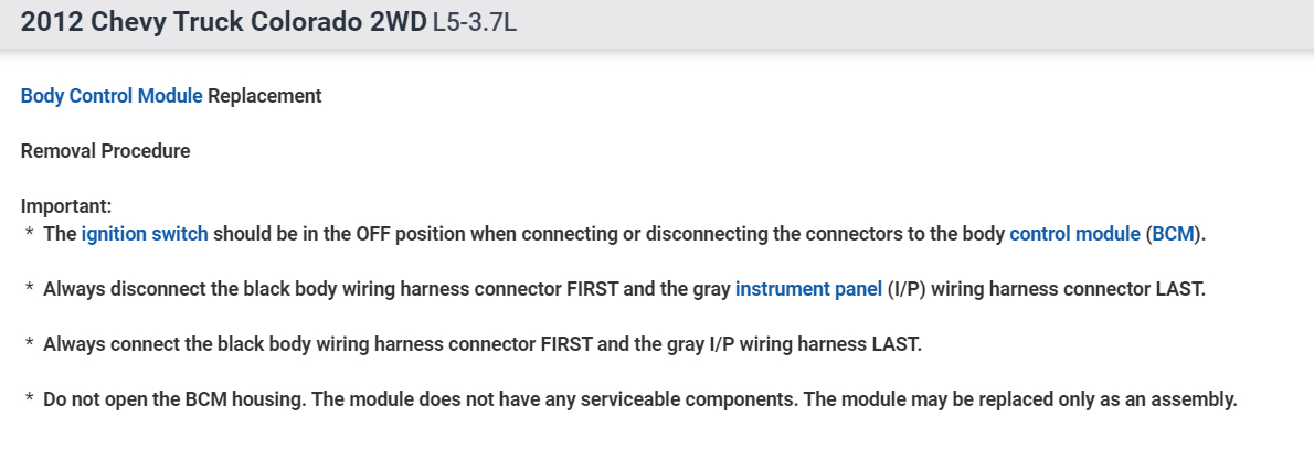

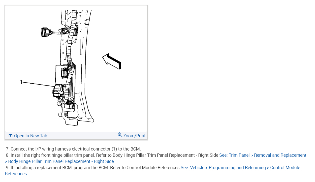

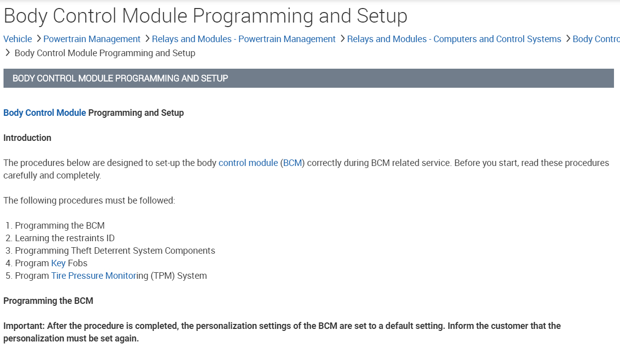

I have seen BCM go out which will cause this issue but to be sure lets do a CAN scan which is the future of car repair and it is easy to do with a scanner from Amazon for about $50.00 watch this video. New scanners do don't need a subscription for the unit.
https://youtu.be/InIlnsjOVFA

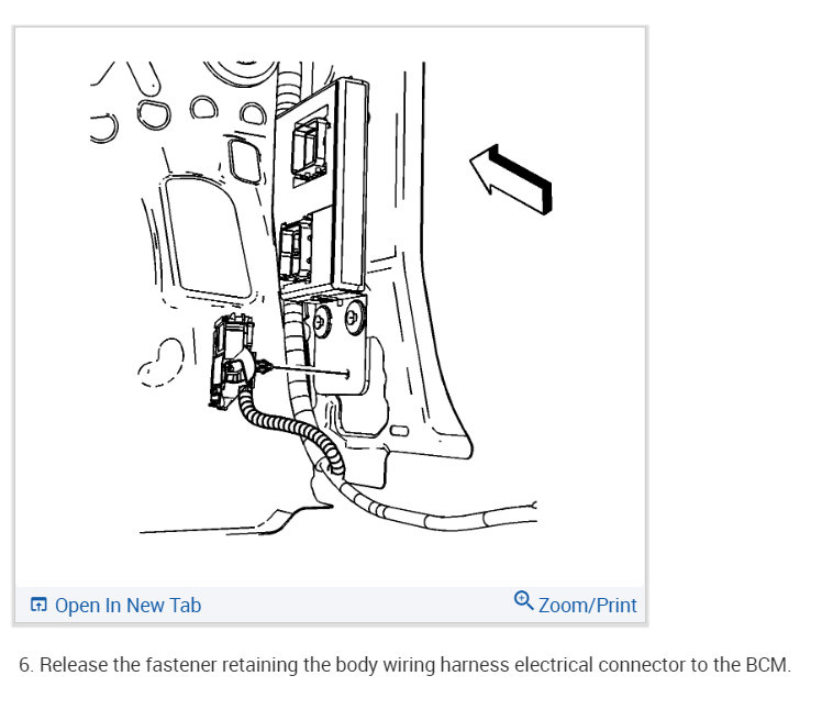

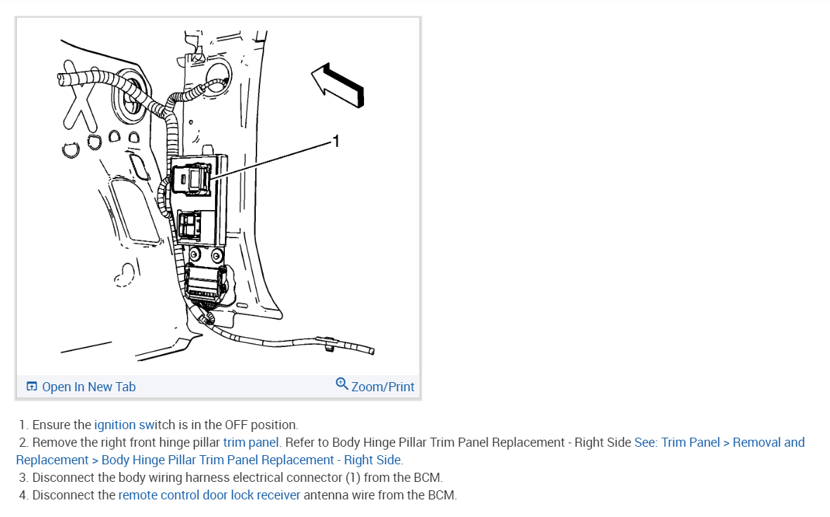

If the BCM is bad here is how you replace it and the complete running light wiring diagrams so you can see how the system works. Check out the diagrams (below). Please let us know what you find. We are interested to see what it is.
