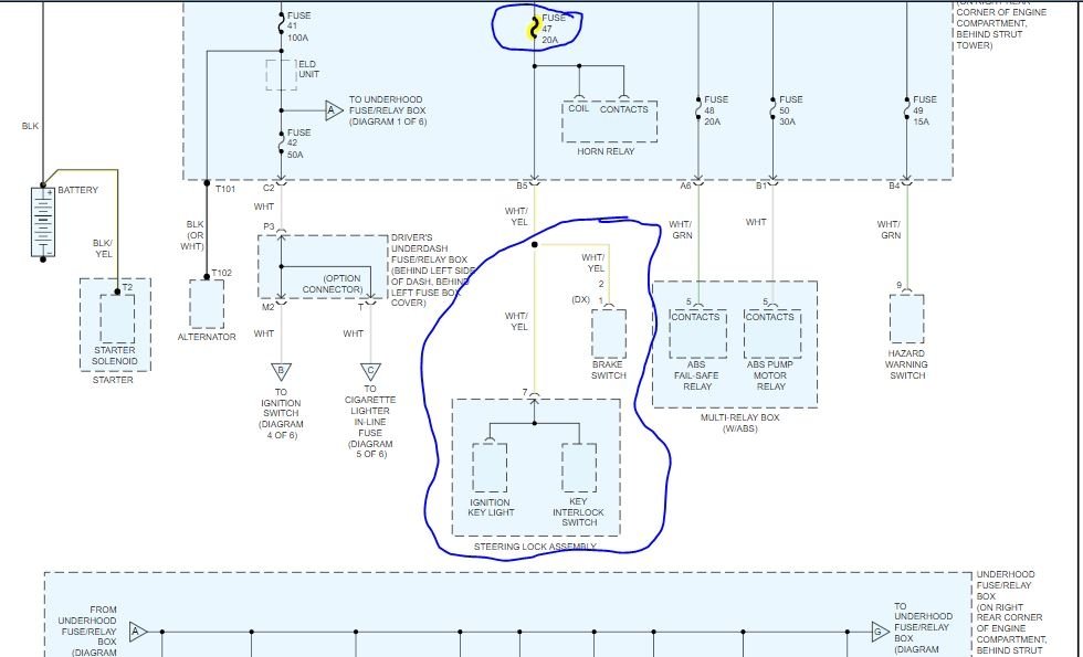

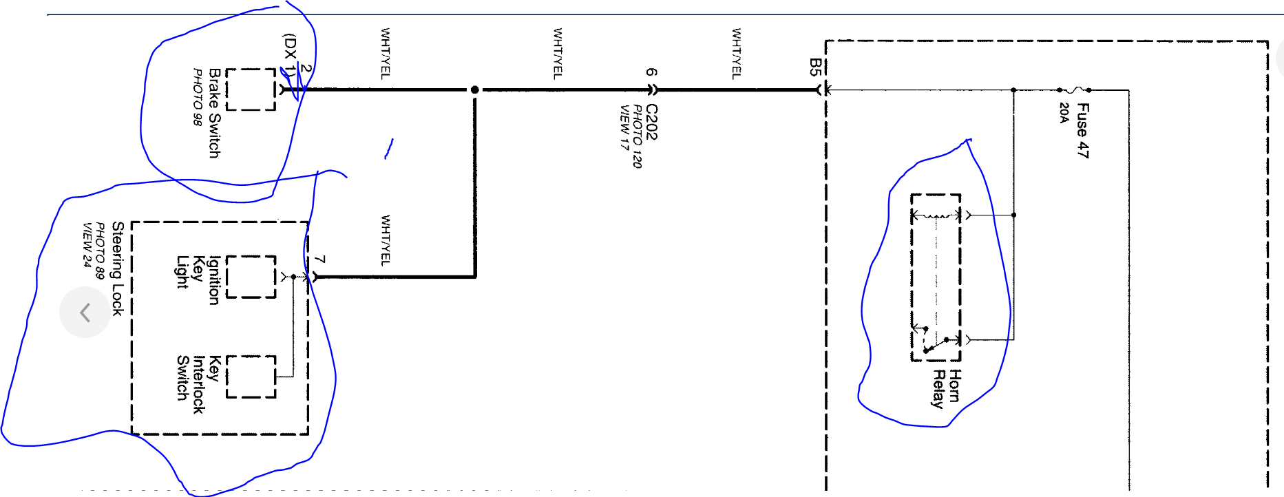

Car battery died. After doing a test with my multi meter I found a fuse labeled "stop" was drawing significant power from the battery. After removing the fuse the draw was back to normal. What exactly does the fuse label "stop" control. The brake lights?
Jul 2, 2020 at 3:04 AM
Good afternoon,
How much was the draw?
https://www.2carpros.com/articles/car-battery-dead-overnight

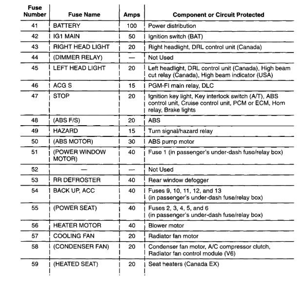

I attached what the fuse controls. You need to disconnect each component until the draw drops down to 50-75 milli amps.
Jul 2, 2020 at 3:31 AM
DAVIDWRIGHTSON
the meter read like 6 amp if i'm not mistaken. after i removed fuse 47 is was down to 50 milli amps.
Jul 4, 2020 at 5:13 AM
You need to disconnect the horn relay, the brake light switch, ignition key light and the key interlock switch.
Then recheck the draw and see if goes to 50.

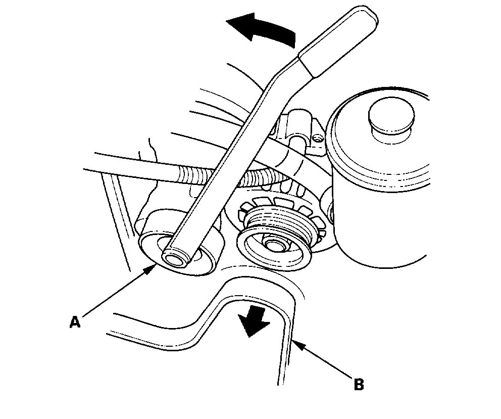

3. Move the auto-tensioner (A) to relieve tension from the alternator belt (B), and remove the alternator belt.

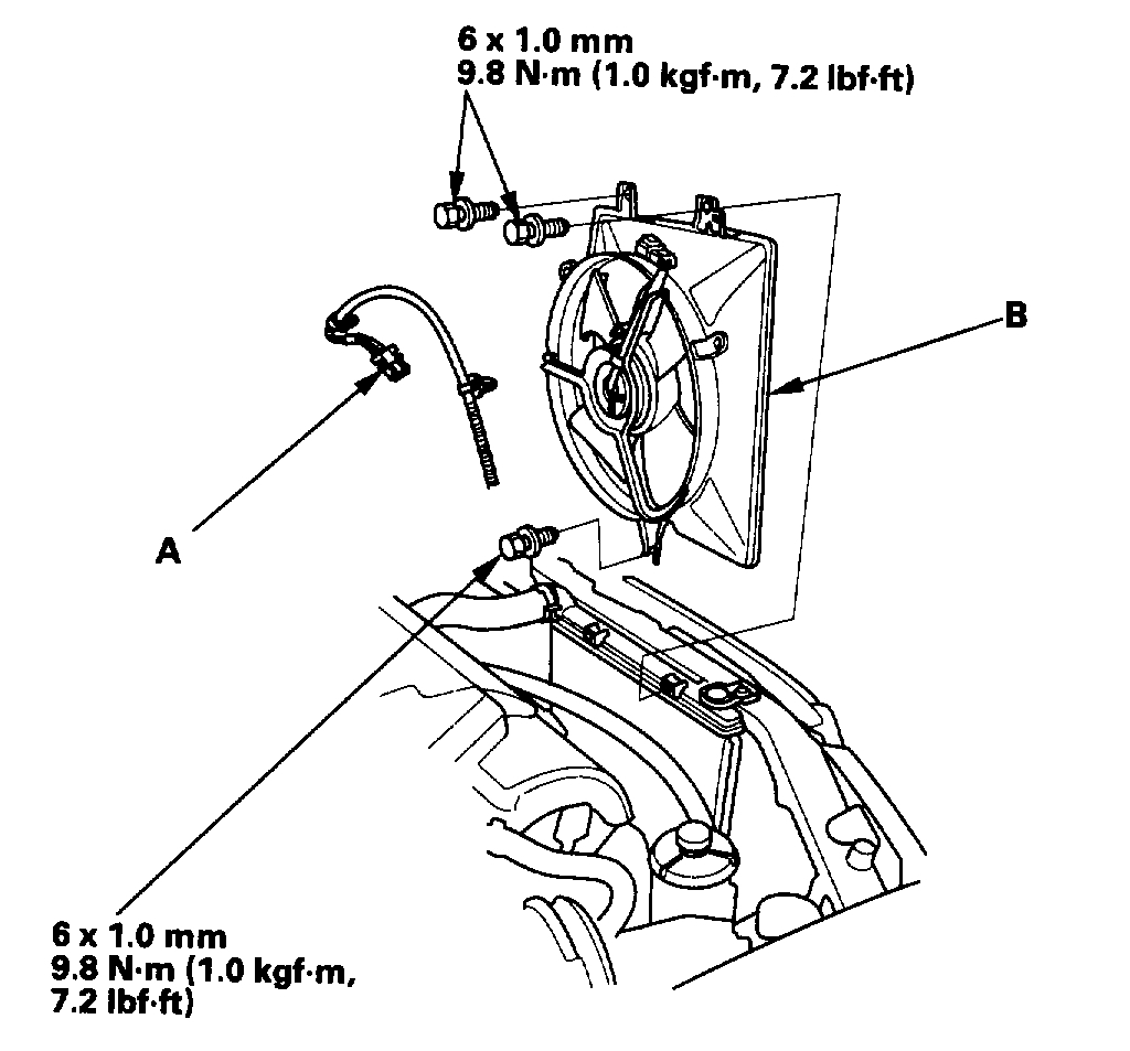

4. Disconnect the condenser fan motor connector (A) from the condenser fan shroud.
5. Remove the condenser fan/shroud assembly (B).

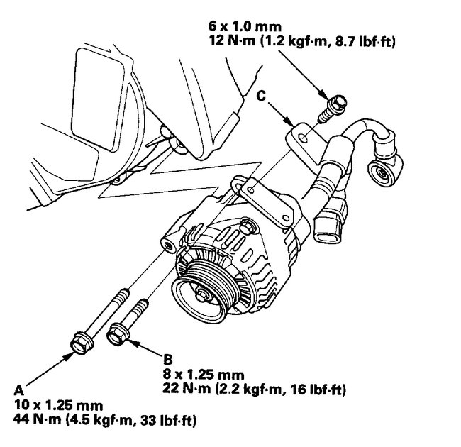

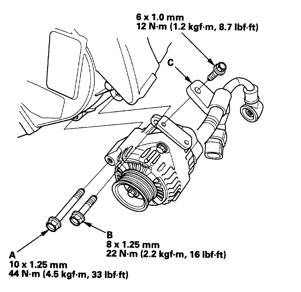

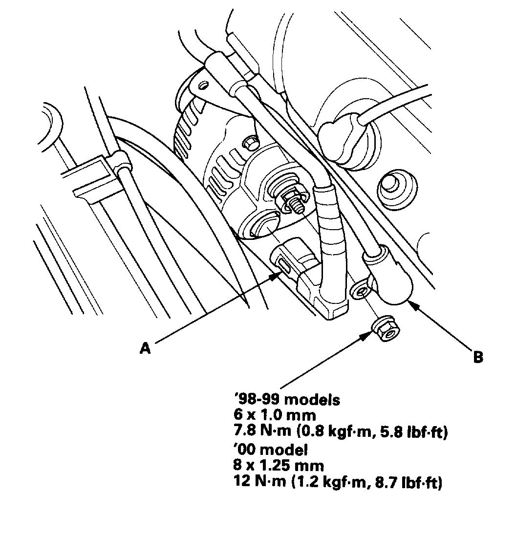

6. Disconnect the 4P connector (A) and BLK wire (B) from the alternator.
pic 4
7. Remove the mount bolt (A) and alternator bracket mounting bolt (B), then remove the harness clamp (C) from the alternator bracket.

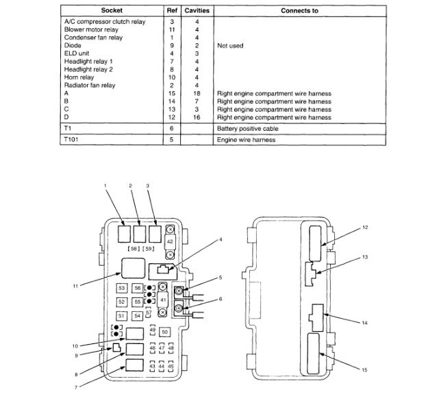

Have the electrical load detector unit located underhood fuse/relay box right rear of engine compartment tested

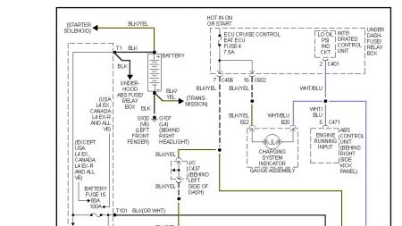

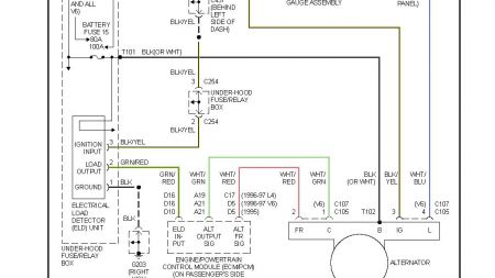

  • 75,992 POSTS
Have them check the electrical load detector and computer control of the alternator-see below
https://images.2carpros.com/forum/automotive_pictures/12900_h1_3.jpg
https://images.2carpros.com/forum/automotive_pictures/12900_h2_3.jpg
