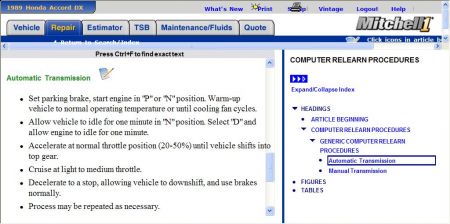

ALISSA4621
I have the code to reset the radio-it works. The car is making a jerking sound and keeps reving up and down like it isn't set to the computer chip or something- how can I reset it to stop idling up and down like it is?
Sep 30, 2020 at 8:56 AM (Merged)
  • 75,988 POSTS
Disconnecting the battery is not a good idea it causes the computer to lose some of its memory data Try below for the computer to relearn itself
https://images.2carpros.com/forum/automotive_pictures/12900_relearn_3.jpg
