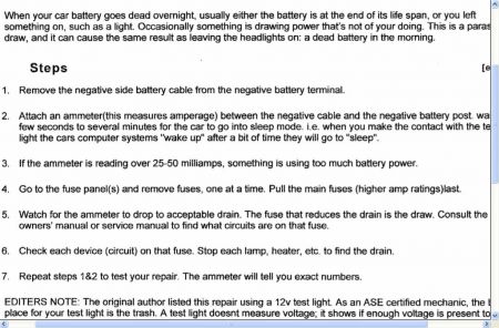

you leave it on and then start pulling fuses to see which area the problem is in. When the needle drops you found it. Pull fuses one by one. This guide will help show you what to do

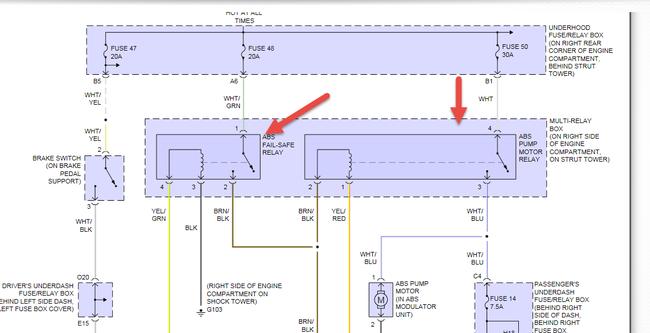

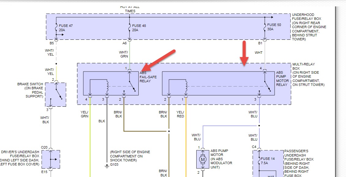

HEYMIKE87
Since approximately two months, my new battery from this summer can't hold a charge for more than one or two days without being used. I got the battery checked at a garage and it is still good. with my ampmeter I found a leak of 0.13 to 0.15A. Removing each fuse one by one didnt help me to find the leak. I don't know if this leak has always been present, but in my opinion I think that a leak of 0.13A isn't enough to drain all my battery so I can't start it in like 36 hours. The last fix I had on my car was the heather control valve replacement about 3 months ago. Could it cause a probleM? And If I disconnect the battery after I use it, the car can easily start again one week later.
Sep 30, 2020 at 8:44 AM (Merged)
HMAC300
  • 48,601 POSTS
try unplugging the abs unit
HEYMIKE87
By abs unit you mean the abs relay in the fuse box?
HEYMIKE87
And I think there is some relay / fuse for abs in my car but I don't remember it working since I have the car (4 years ago).. there is no abs light in the dash neither
HMAC300
  • 48,601 POSTS
see pic
HEYMIKE87
Ok I saw it but what should I get from this?
HMAC300
  • 48,601 POSTS
it may stop the draw on your battery then you knot the problem is.

The voltmeter negative lead goes to the negative side of the battery and the positive lead from the meter goes to the cable. NOTE: When you're doing the test make sure there's nothing On such as the glove box and trunk lights are not On etc.
If you get a battery voltage that means you have a short circuit in the electrical system. Start removing fuses one @ a time. The fuse that drops the voltage to zero is the trouble circuit. If you remove all the fuses and you still have battery voltage disconnect the alternator and see what happens.

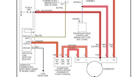

BLGIBLIN
  • 5 POSTS
having trouble starting car. got a new battery and my alternator was replaced. went to start this am and the battery was dead need jumpstarted. runs after jump started. took it to dealer a couple of weeks ago they said it was my radio drining power replaced radio still having problems. also seems like cool ait is always blowing out vent. what to check next?
Sep 30, 2020 at 8:45 AM (Merged)
  • 75,988 POSTS
This guide can help us find the problem https://www.2carpros.com/articles/car-battery-dead-overnight The field circuit is controlled by the computer could be a problem there. See below
https://images.2carpros.com/forum/automotive_pictures/12900_alty_honda_1.jpg

I gave you this because the alternator might not be putting out and you're running only with battery power without the help from the alternator due to a problem with the field generation controlled by the computer-something like a built in voltage regulator not maintaining the output of the alternator. The best way to check for the parastic drain is to use an ammeter-see below the light should go out when you pull the fuse on the radio/lighter-25milliamps and below is allowable due to the vehicle memories-radio/clock etc.
