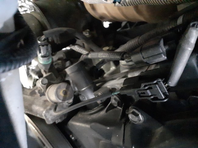

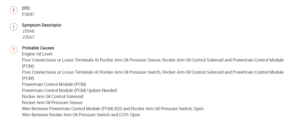

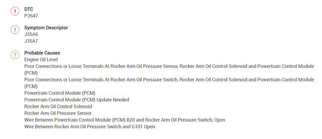

So I did a oil change with the correct factory oil recommended and filter. Oil level is good afterwards, then I started to get a oil light flickering when engine is stalled. Vsa and engine light are both still on. Anyhow p2647 read
A rocker arm actuator system stuck on bank 1
Oil pressure switch (a) circuit high voltage..
So I'm looking at changing out solenoid, oil sensor and gaskets. I'll attach a photo and was wondering if you can help me identify if this is the exact location of both sensor and solenoid. I couldn't seem to find any other sensor or solenoid in the engine. And bank 1 is closest to firewall. anyways some advice will be helpful before I order parts..
Dec 18, 2020 at 8:38 AM
I attached the location of the pressure sensor and the rocker arm sensor location as well.

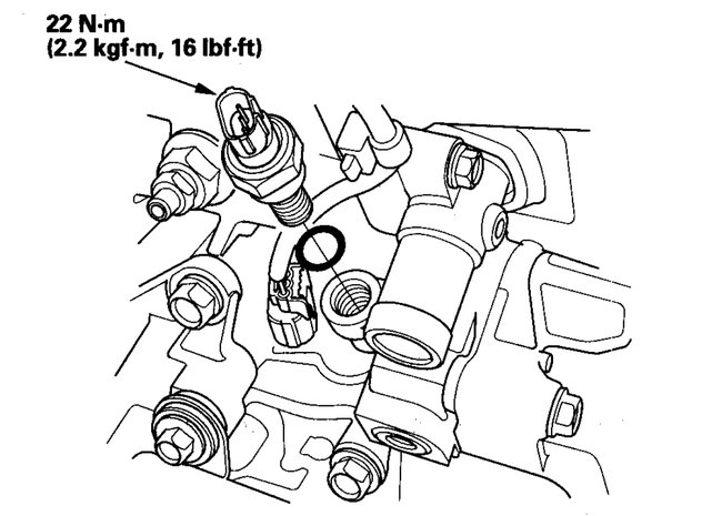

Oil Pressure Switch Replacement
'07 model J35A6, J35A7 engines and '08 model J35A6 engine
1. Disconnect the oil pressure switch connector, then remove the oil pressure switch.
2. '07 model J35A6, J35A7 engines: Remove any old liquid gasket from the switch and switch mounting hole.
3. '07 model J35A6, J35A7 engines: Apply liquid gasket to the new oil pressure switch threads, then install the oil pressure switch.
NOTE: Using too much liquid gasket may cause liquid gasket to enter oil passage or the end of the new oil pressure switch.
4. '08 model J35A6 engine: Install the oil pressure switch with a new O-ring.
5. Connect the oil pressure switch connector.
Rocker Arm Oil Pressure Sensor Replacement
'08 model J35A7 engine
1. Disconnect the rocker arm oil pressure sensor connector, then remove the rocker arm oil pressure sensor.
2. Install the rocker arm oil pressure sensor with a new O-ring.
3. Connect the rocker arm oil pressure sensor connector.

thank you for this, but may i ask the photo i have attached that would be the oil sensor yea the green switch? the rocker arm sensor is that also on the bottom by the oil sensor and solenoid area? sorry i did read through your information there was only one photo that i'm assuming was the rocker arm oil sensor?
Dec 18, 2020 at 8:58 AM
Correct.
Your picture has the sensor location correctly. The green is the oil pressure sensor.
