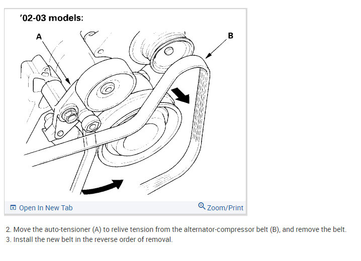

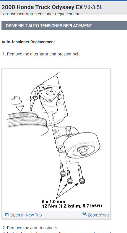

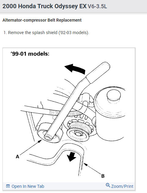

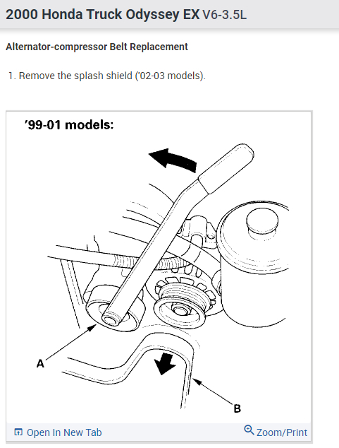

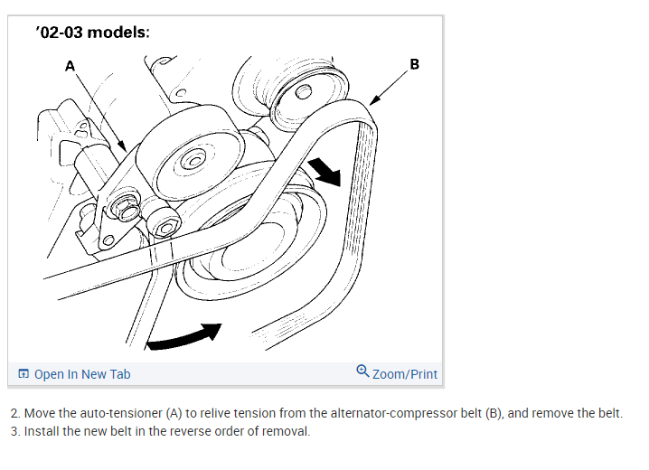

How do I adjust and replace the alternator belt
Saturday, February 27th, 2010 AT 1:01 PM
SQM
  • 6,383 POSTS
In order to replace the alternator belt you will need breaker bar with a correct size socket for the tensioner pulley. Apply pressure counter clockwise and the tension will loosen and you will be able to get the belt out.
https://www.2carpros.com/articles/how-a-serpentine-belt-works
This vehicle is equipped with auto-tension alternator belt, it cannot be adjusted. If the tensioner is defective and does not have enough pressure it will have to be replaced.
https://www.2carpros.com/articles/how-a-serpentine-belt-tensioner-works
https://www.2carpros.com/articles/serpentine-belt-tensioner-replacement
