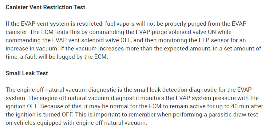

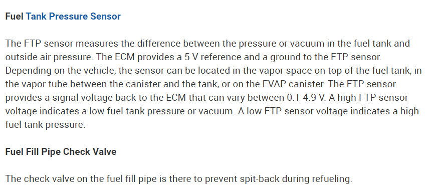

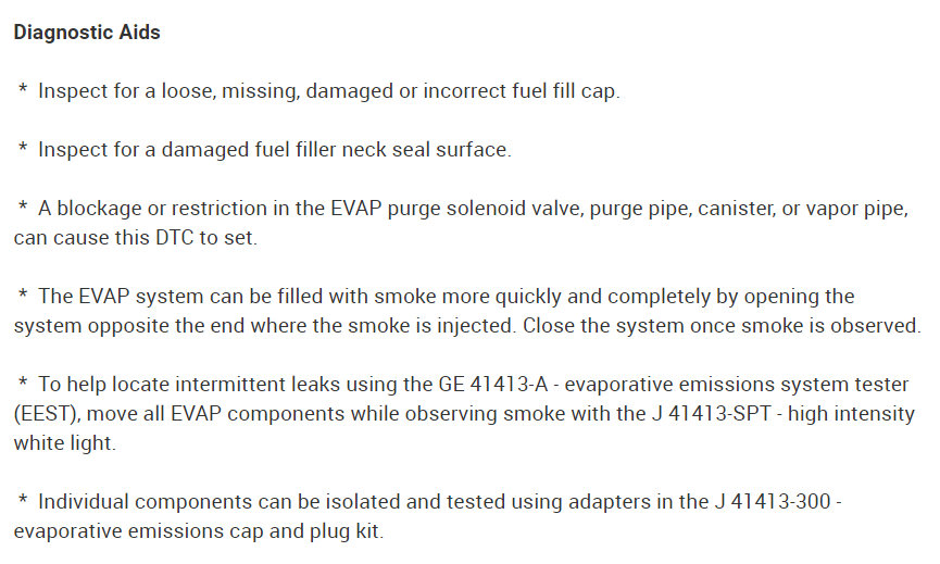

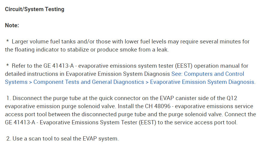

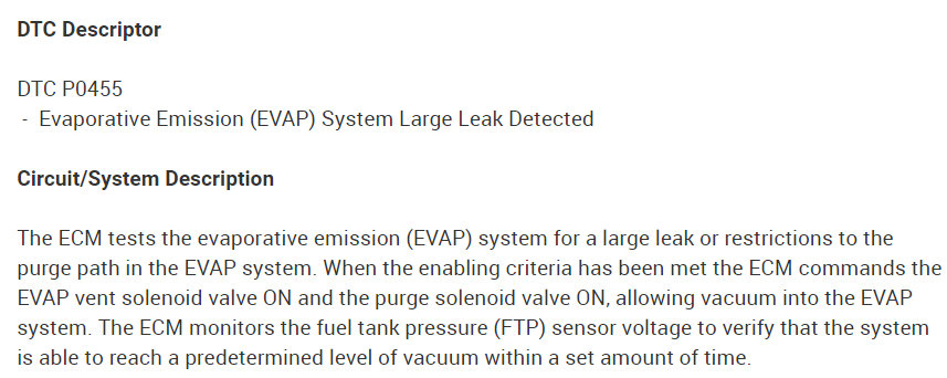

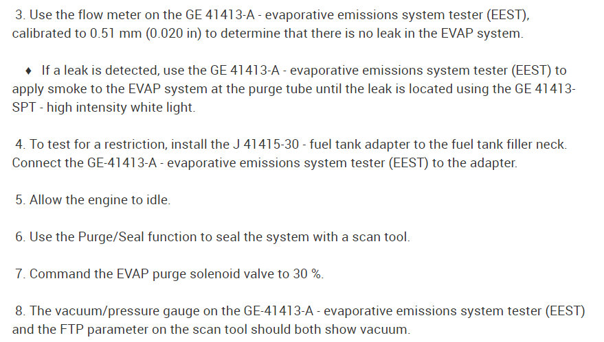

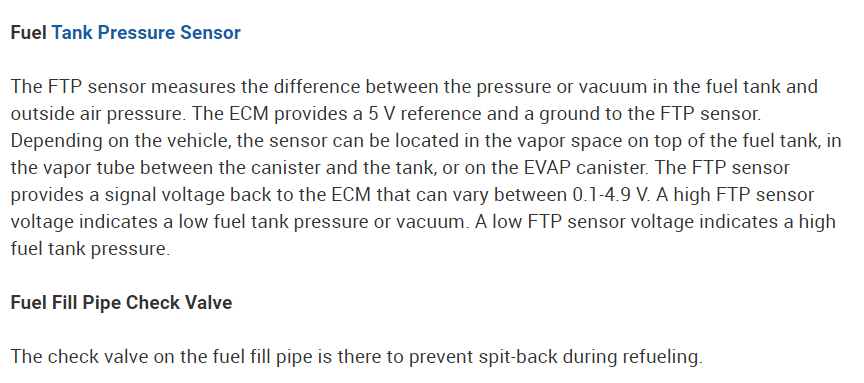

Gas cap has been replaced. Both the purge valve and the vent valve have been removed and checked by applying voltage and sucking on them. Both seem to be working properly. From under the hood, I can blow through the tube attached to the purge valve and hear air coming out in the gas tank. So system does not seem to be blocked. If I plug the tube attached to the vent valve, and blow through the purge valve tube, I can build pressure in the system after several breaths. Pressure seems to hold indefinitely (I waited several minutes). I suppose it could be a bad pressure sensor, but don't any way to test this. Any thoughts?

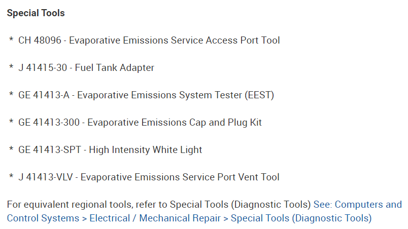

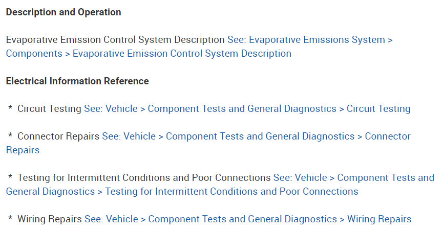

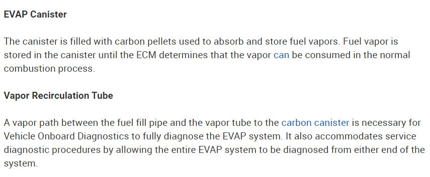

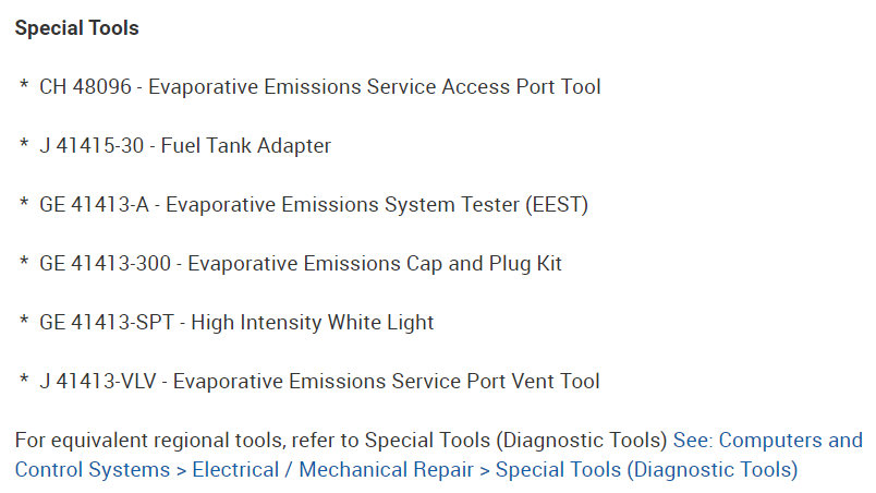

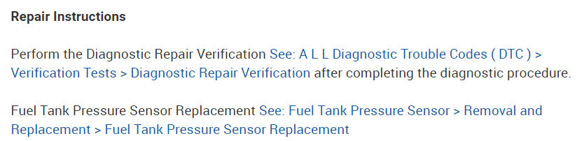

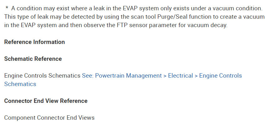

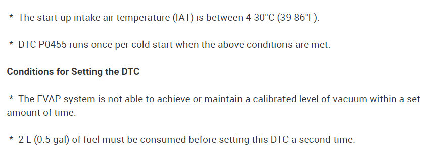

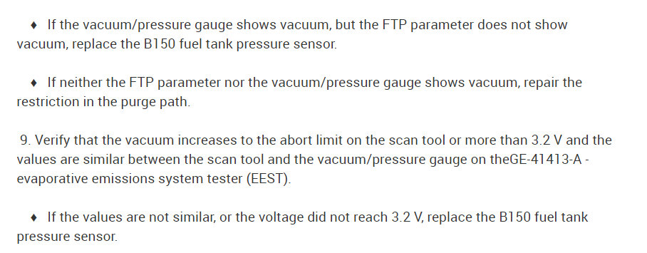

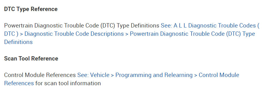

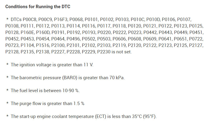

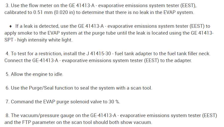

Hello, I'm Danny.

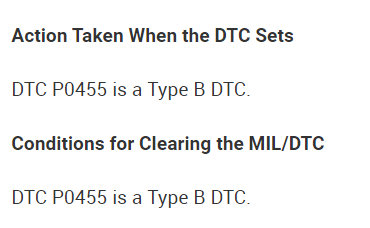

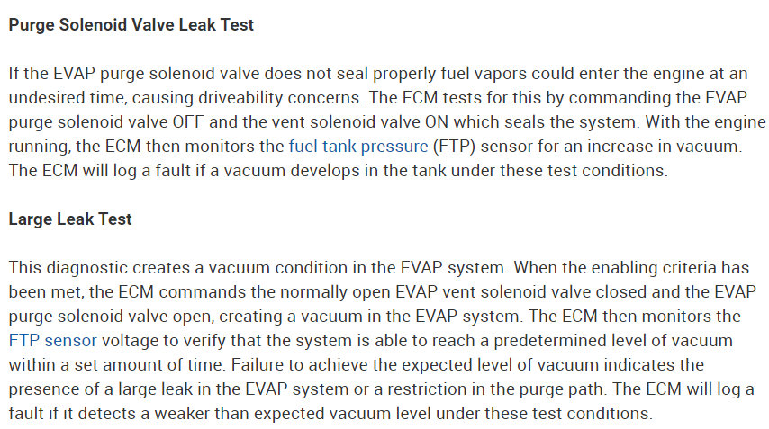

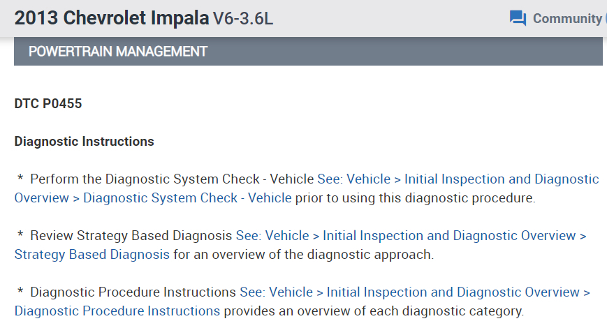

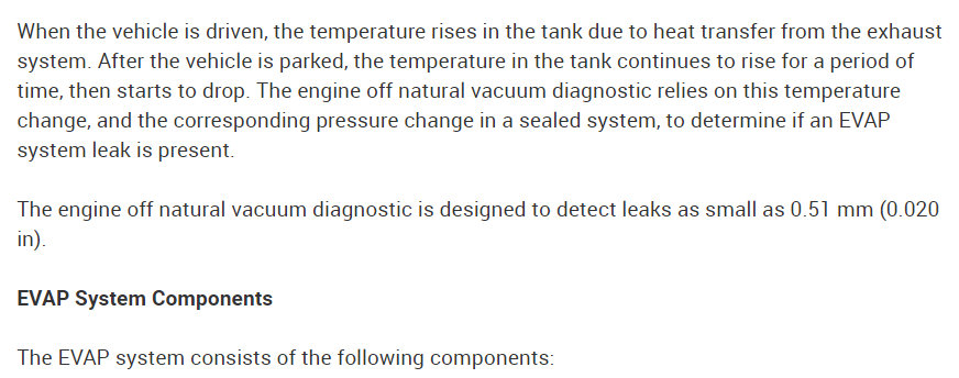

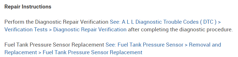

I've attached below what I've found relating to your P0455 code. These are picture diagnostic steps for your car. Let us know what you find. Have you considered having a smoke test performed. Basically smoke is applied through the EVAP service port to determine where the leak is coming from. Hope this helps and thanks for using 2CarPros.
Dec 6, 2020 at 8:55 AM
SIDETRAIL
I am a home mechanic, and don't have access to all these speciality tools. Did you read my explanation of the problem? The system seems to be able to hold pressure for at least several minutes, so what would a smoke test show? If the system is not blocked and there is no leak what else can trigger the error code?

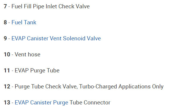

DANNY L
  • 5,648 POSTS

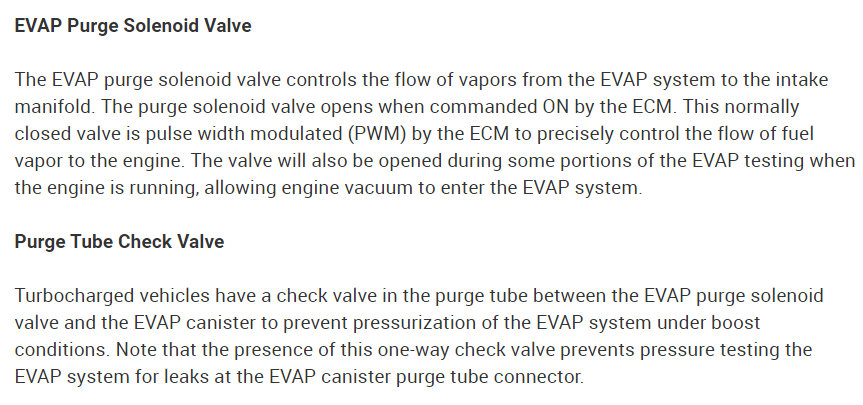

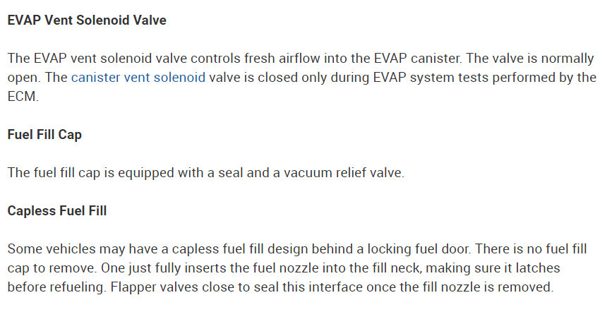

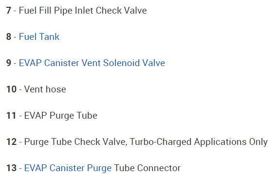

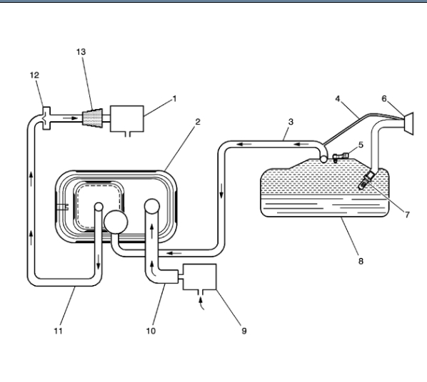

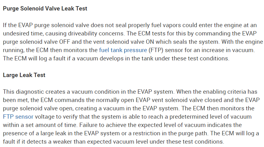

Hello again

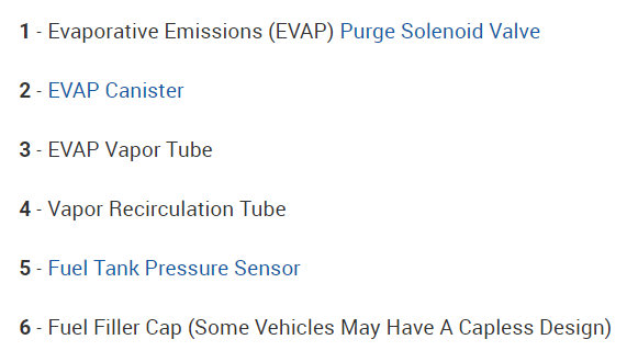

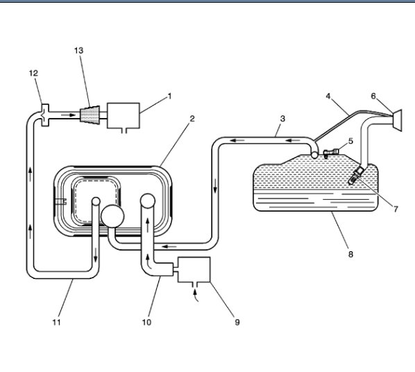

I've attached an evaporative emissions lines diagram of all the hoses while we are trying to figure this out. They have there descriptions on the pictures I've attached below. Hope this helps and thanks again for using 2CarPros.
