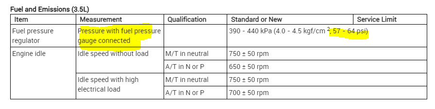

Next, low fuel pressure can cause a lean fuel mixture. You should also check fuel pressure to see if there are no vacuum leaks.
Here is a link that explains how that is done:

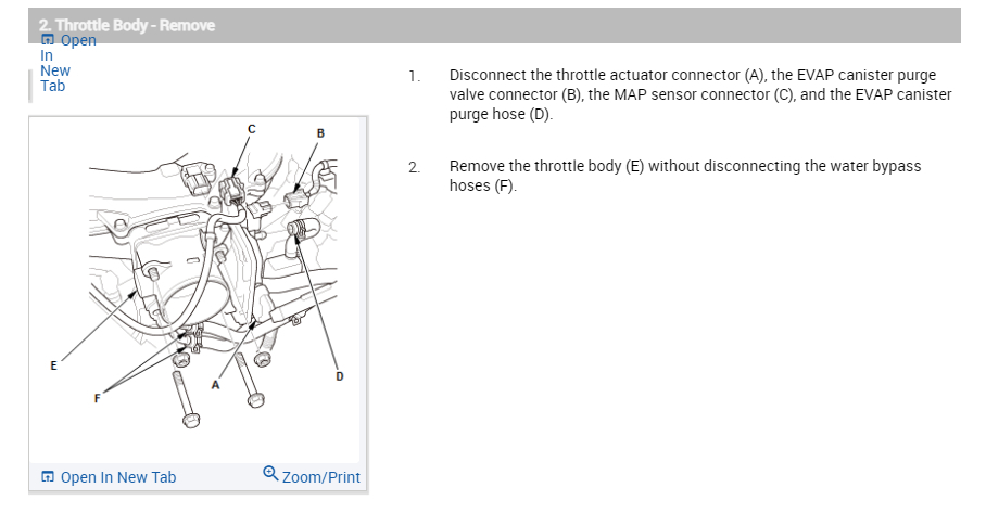

You will need a fuel pressure gauge, but most parts stores will lend one to you. Also, I attached the manufacturer's fuel pressure specifications below.
Let me know if you are comfortable performing these tests. Also, let me know if the vehicle has a smooth idle.

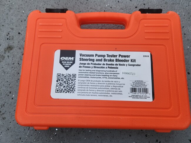

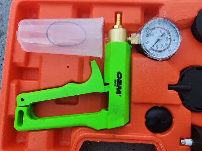

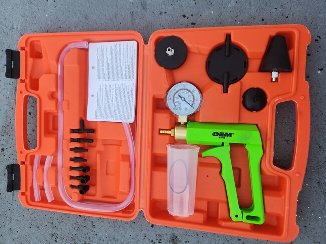

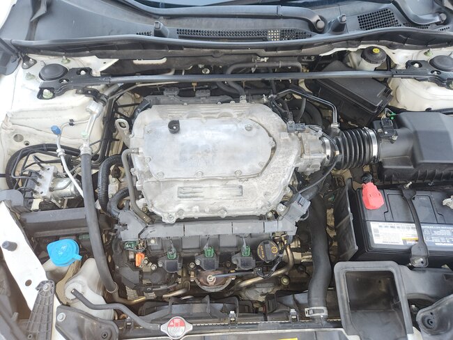

I rented a vacuum pump, but I don't think the guys at the auto store gave me the right tool. I also have no idea where to connect the vacuum pump to, can you point me in the right direction? I'm going to attach some pictures.
Nov 10, 2023 at 6:18 AM
  • 110,244 POSTS
The tool they provided is useable for several different things, including vacuum testing. A vacuum tester can be used to check items such as a MAP sensor, EGR valve, vacuum canister, brake booster, or an HVAC blend door actuator. We haven't narrowed it down to a specific component.
The tester they provided is used to determine if a component holds a vacuum or if it is leaking. In most cases, a leak is the result of a hose issue or failed gasket. Have you done a visual inspection or used something like carburetor cleaner to check?

I did a visual inspection but did not find anything. Can you tell by the pictures where I'm supposed to connect the vacuum tester?
Nov 10, 2023 at 10:52 PM
  • 110,244 POSTS
As far as the pics, they are fine. However, a vacuum pump is used to check a specific component such as an EGR valve.

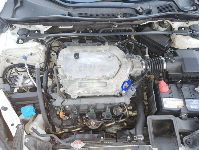

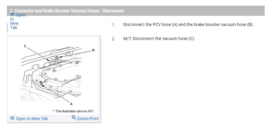

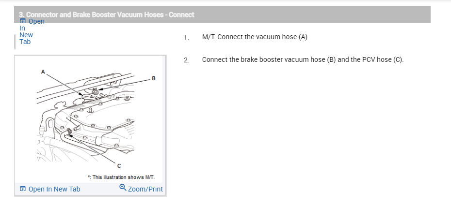

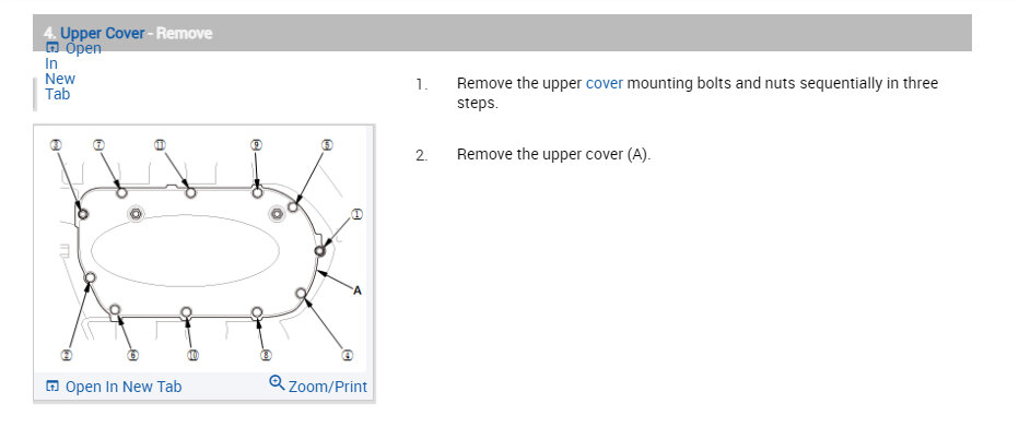

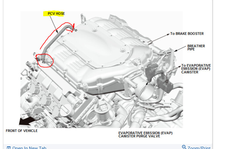

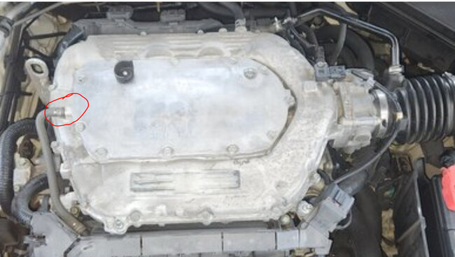

If you want to check the engine vacuum, any vacuum hose on the intake will work. I attached a pic of the PCV vacuum hose. When you connect to this point, remove the vacuum hose from the intake (circled in pic 2). That is where there will be vacuum.
Plug the opposite side.
Nov 11, 2023 at 12:45 PM
DG201
  • 6 POSTS

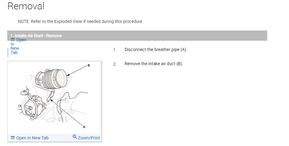

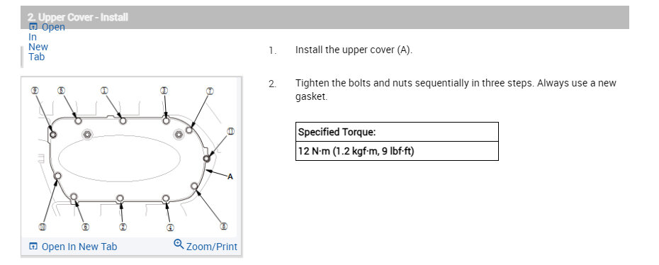

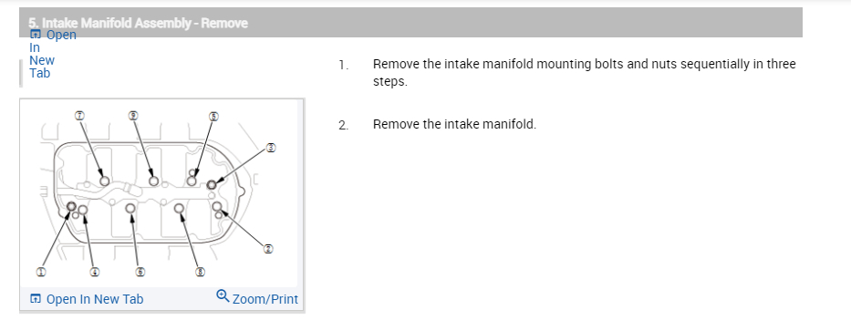

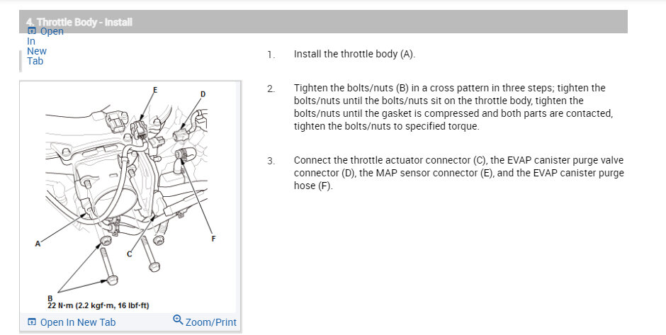

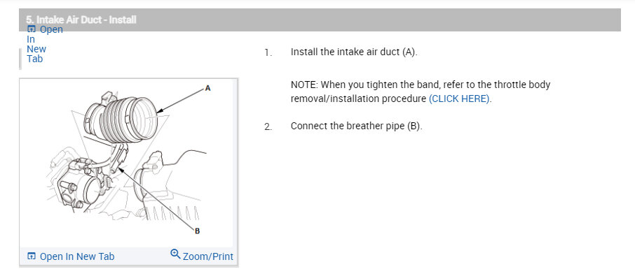

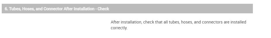

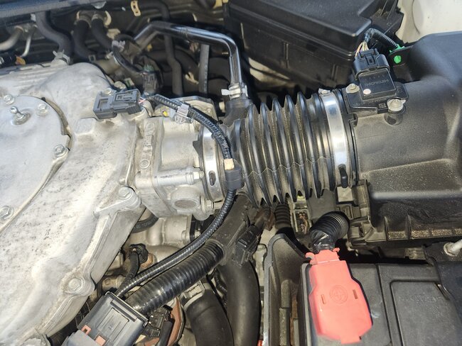

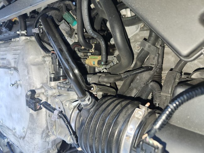

I found the issue; I have air coming in through the intake manifold (see the picture). There is a small crack on the top. The gasket seems to have failed as well because there is air coming through where the 2 pieces meet.
Nov 13, 2023 at 10:44 PM

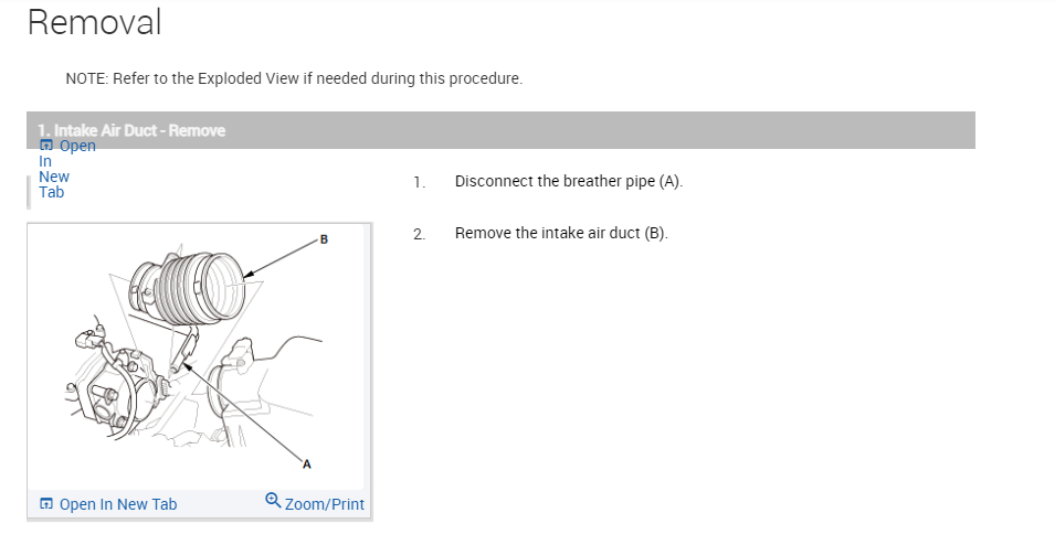

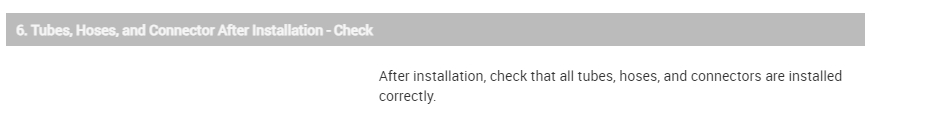

  • 110,244 POSTS

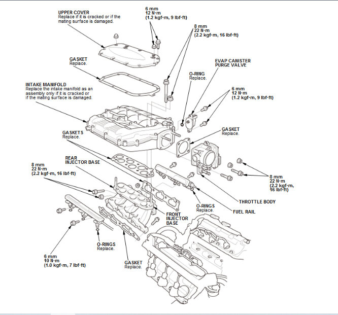

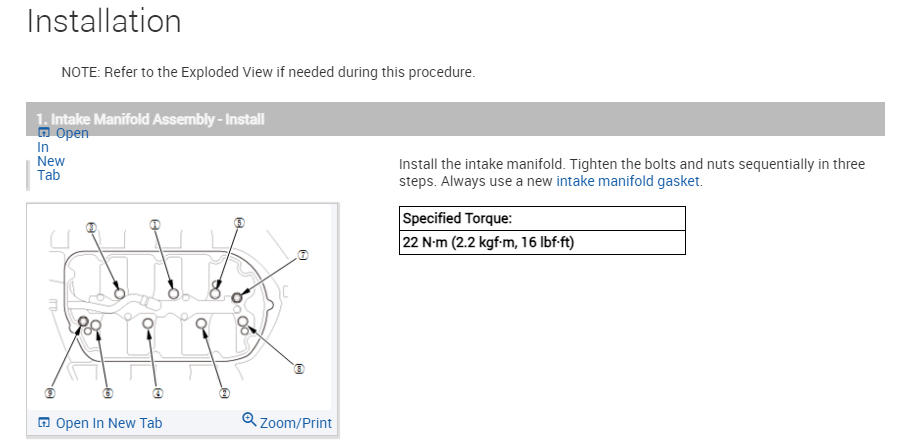

I can't zoom in tight enough to see the crack. However, if one is present and the engine speed changes when you spray carb cleaner on that spot, that is the problem.

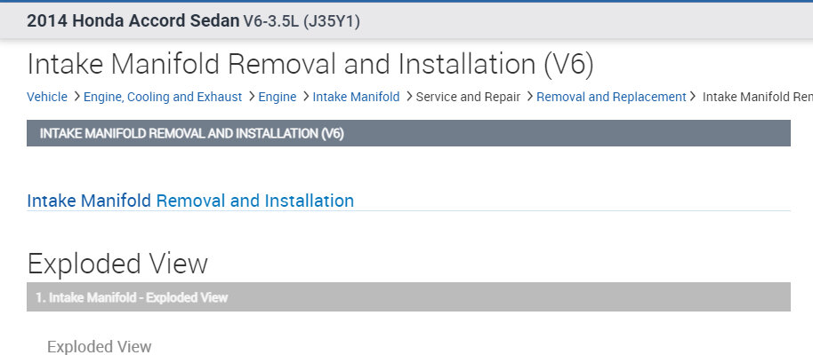

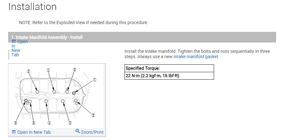

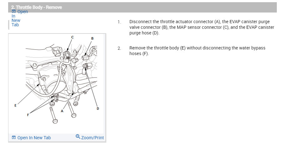

If you plan to replace it, I attached the directions below. The directions include the torque specifications and sequence.
Let me know if this helps.
