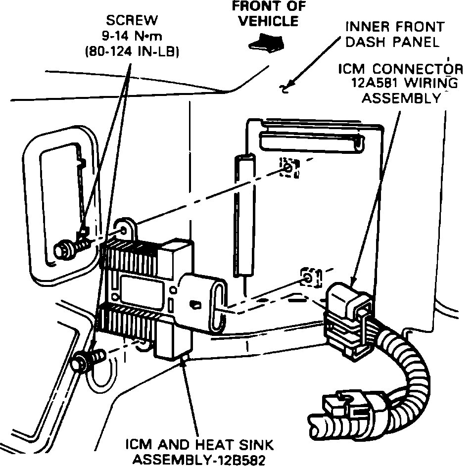

My truck turns off while driving or will not start, randomly, a few times a month. I did a turn up and replaced the dist-cap and rotor and wires, a few months ago. Other than that, I have not tried fixing this issue, yet. 4 out of 5, the vehicle turns on fine and drives.
Nov 8, 2019 at 12:29 AM
BMDOUBLE
  • 1,139 POSTS
Have you replaced the ignition control module yet? It sounds like the crankshaft angle sensor, main control relay or fuel pump is going out but the be sure lets go over these guides to help us fix it the problem. The should scan for codes as well you could have a MAF or MAP sensor going bad which will leave a code (a bad crankshaft sensor will not leave a trouble code FYI). When the engine stalls lift he hood and check to see if any of the relays are hot in the main fuse panel (PDC).

Replaced module. Check wiring and connector. No problems as of yet.
Nov 16, 2019 at 10:05 AM
  • 55,721 POSTS
Good to hear I was thinking the ECM relay should be replaced as well. Here is the location. I like the T-shirt :)

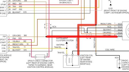

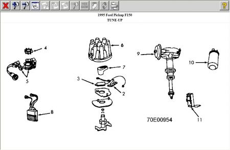

My '95 F-150 5.8l occasionally will not start and engine will stall when driving. when this happens there is no spark from the ignition coil. I can sit there and try to start the truck form 10 min. to an hour and it will eventually start. This happens when the truck has been sitting for awhile.
Recently when it happened the engine was sitting for 14 hrs. When I tried to start the engine sounded like it was going to start but it was weak. I checked for spark and it was very weak then went away. After trying for 30 min. it started.
I have replaced the ignition coil and ignition control module. I took it to an auto shop a month a go and they said it was a bad wire between ICM and distributor. It was fine for awhile but problem returned. I took it back, they had it for 4 days and told me they got it to act up one but not long enough to use a scoop on it. They basically said it could be a number of things, pick up coil, ignition switch, bad wire some where, and good luck to you. Funny thing is when I got the truck back the second time I tried to start it, it exibited the problem, in fact it did it twice in the same day. Please help!
Apr 26, 2021 at 6:19 AM (Merged)
  • 75,988 POSTS

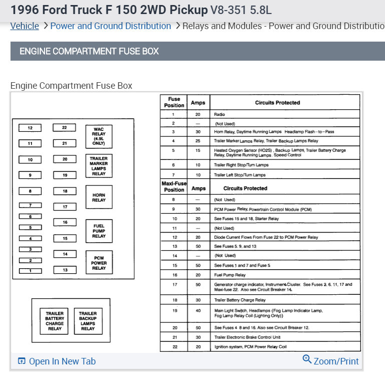

I want you to check fuse U 20amp in engine compartment fuse box. Is its okay? Hook it up on the red and light green wire-do you have this?

KHLOW2008
  • 41,812 POSTS
Pulling the distributor out will be easier to deal with the problem,
https://images.2carpros.com/forum/automotive_pictures/192750_Distributor95FordF150_1.jpg
Item # 5 = Ignition stator Item # 8 = Ignition module.
MICT
Thanks for the info. Irepacled the distributor with a rebuilt unit seems to have fixed it.

wont idle for more then 20 minutes sometimes shuts off while im driving it desnt get any spark from the coil i have changed the coil, distubtor, distubtor cap, plug wires, ingion module, ecm, ecm relay
Apr 26, 2021 at 6:22 AM (Merged)
HMAC300
  • 48,601 POSTS
check the spout connection near the ignition control module it may not be making a good connection. it goes through that to the supply power to themodule from the pcm.
