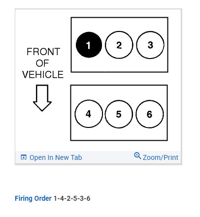

Working on the vehicle listed above with a V6.
There is a misfire on #2 and #3 (both are bank 1).
Spark plugs were replaced.
Live data numbers look fine to me, except for downstream 02 on bank 1 fluctuating (almost mirroring the upstream sensor).
Both fuel trims look good, from -5 to +8 and the three other O2 sensor numbers are normal.
I can't figure out why I'm getting a misfire code, when those numbers look right, but I am not getting a p0420 for a bad catalytic converter even though that downstream sensor's numbers would suggest it.
Any ideas are greatly appreciated, and thanks in advance.

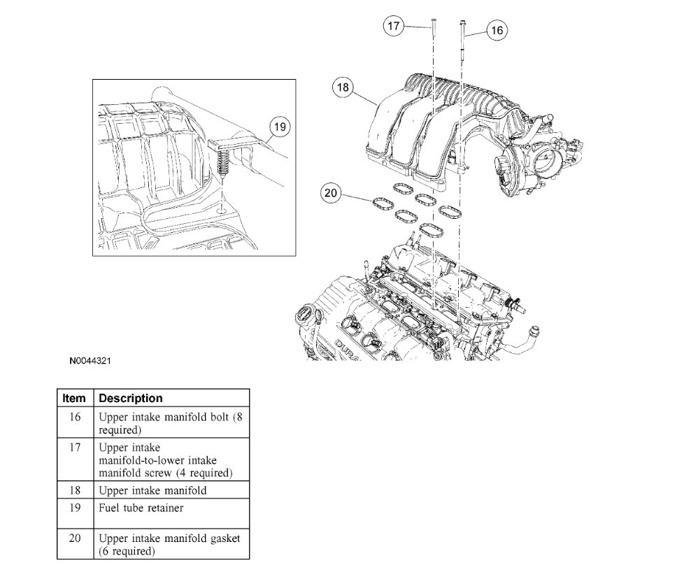

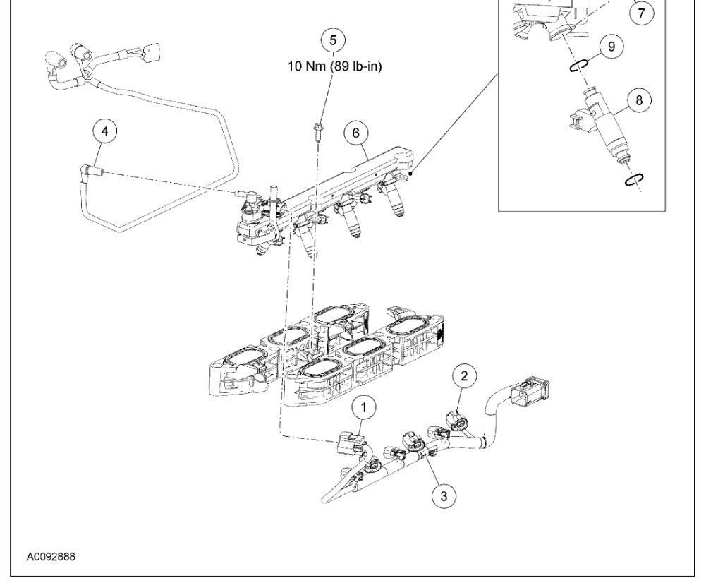

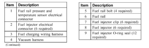

When you pull the spark plugs on number 2 and 3 what do they look like? It sounds like you have two injectors that are having a spray pattern problem. Here is how to remove the injectors and how to check the spray pattern to see if this is the issue. I have included diagrams below to show you how to use your car as well. Please upload what the plugs look like so I can see what's going on.
https://www.2carpros.com/articles/how-to-test-a-fuel-injector
Also let's make sure the gaskets for the intake are not leaking, this guide can help:

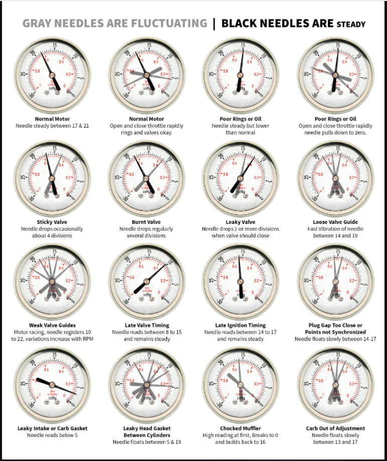

If we are not, then we need to monitor the intake vacuum using a vacuum gauge and find out if we have intake valves hanging open. I attached a chart below that will help with this.

Okay, so, I performed a vacuum test, the numbers were perfect - steady 19 at idle, when you hit the gas fluctuated down and up then back again.
I'm pretty sure this passed test eliminates a lot of the other tests to perform (I was looking through the list of things that the vacuum gauge would show if they were faulty).
Hopefully there's no need for a compression or leak down test now, seeing I passed the vacuum test.

So today I pulled the intake, and the spark plugs look fine.
performed a compression test and had 175 - 180 across all cylinders but 2 and 3, which still fell within spec at 165 and 175
And as stated before it passed the vacuum test with flying colors.
Cleaned injectors and inside the intake, then reassembled.
