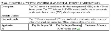

The codes previously posted was 2109 and the other was inconplete so I was not sure what they were. Both trouble codes are related and the primary concern would be P2106. P2106 = Throttle Actuator Control (TAC) System - Force Limited Power.
https://images.2carpros.com/forum/automotive_pictures/192750_P2106TAC06Freestyle_1.jpg

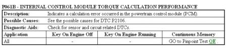

For the pinpoint test, I would send the article to you as it is too complex to be posted here. P061B = Internal Control Module Torque Calculation Performance
https://images.2carpros.com/forum/automotive_pictures/192750_P061BTAC06Freestyle_1.jpg
