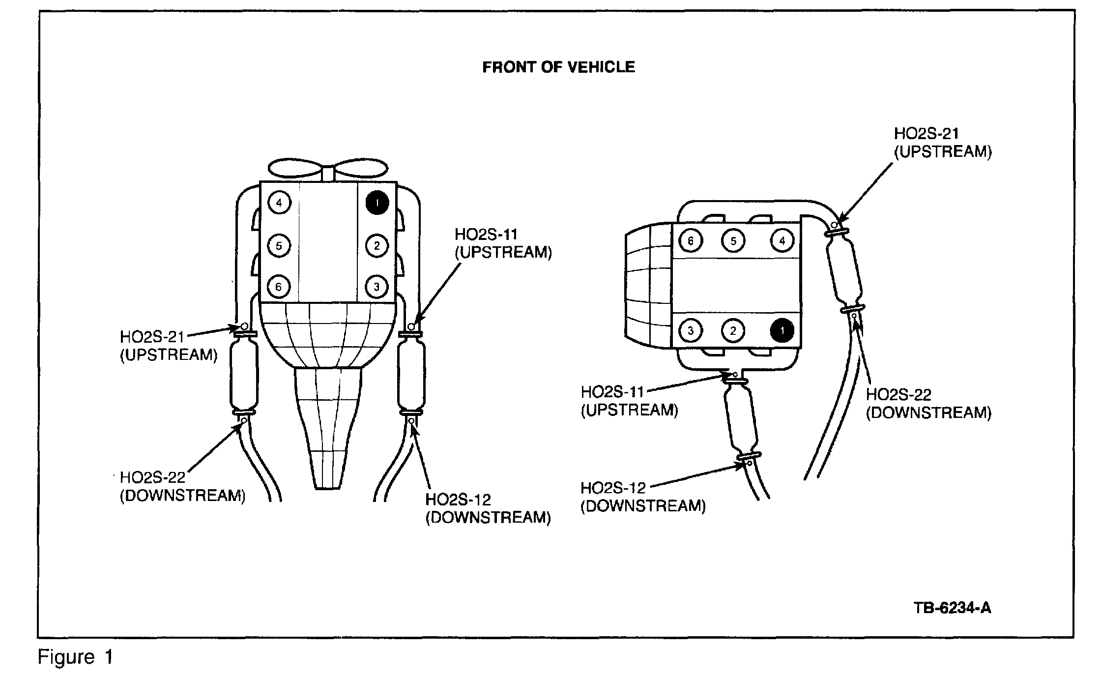

Okay, I got ya man. P0430 is passenger side, right?
Saturday, December 1st, 2018 AT 3:20 PM
  • 109,874 POSTS
Bank 1 will always be the side with cylinder 1. In this case, passenger side. See the attached picture.
