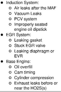

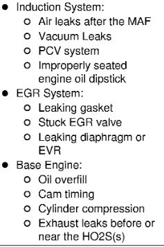

Okay, so the fuel pressure checked out as normal. The boot on the back if the throttle body is fine, no holes or anything. I am also getting a p1131 and p1151. This is oxygen sensor problems that are tied into this problem I believe. I also checked manifold and all other vacuum lines with starting fluid. Is there anything else that would cause this? Give me all you got because this completely stumps me
Nov 2, 2018 at 6:51 AM
  • 110,194 POSTS
Hi again.
The 1131 indicates a lean mixture and the computer has maxed it ability to compensate. See pics 1 and 2 for possible causes. The 1151 is the same thing for the opposite bank.
Take a look through the two pics I attached. See if anything clicks with a possible issue.
Also, these engine often times have exhaust manifold leaks. It will sound like a ticking oftentimes. Is that happening?

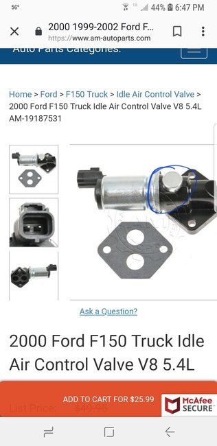

Okay. So I smoked a fat cigar in less than five minutes and not only did I manage to find a couple of air leaks, but I also smell like an old man with good luck at a poker table. LOL. I can vouch for the cigar test but only if you use at least a 3/8 hose, because you cannot push enough through a small 1/4 line if you are trying to test everything. Plus it will give you lockjaw's (which is another problem you do not want).I went through the PCV tube on bank 1 (passenger side). The first leak was found off of the cold air intake. I have two outlets about half way down the intake pipe. The bottom outlet goes to the PCV valve on bank 2. The outlet above it goes to the IAC valve in the back(its against the back firewall right above the notorious boot that dry rots.) Both leaks was on that line. Someone who had the truck before me used a piece of hose as a sleeve between the hose off the intake (1/2 in) to the hose going to the IAC (5/8in). It was not tight so unmetered air can get in. The other leak was actually at the IAC valve. I put this part on about 2 months ago because of this vacuum problem. The smoke was coming out of the bottom of a little metal cap that has made on to it. I believe this metal cap is meant to be designed this way for some reason but when I put a little carburetor cleaner to it while it's running, there is no difference in idle.
I fixed the hose problem and I am not sure if anything needs to he done about the IAC.
Nov 6, 2018 at 4:44 PM
PACKERS27
  • 207 POSTS
This is not my IAC but its the same one for my truck and here is the cap I am talking about. It seems like it is for venting because the cigar smoke came out from under it. It was not excessive smoke but a small amount.
Nov 6, 2018 at 4:49 PM
PACKERS27
  • 207 POSTS
So after further research, I have read that this cap is suppose to do that. It is unmetered air but the PCM compensates for it. The cap is for pressure relief to balance the idle speed and without it, the idle cant be stabilized. That is good to know.
Nov 6, 2018 at 4:58 PM
