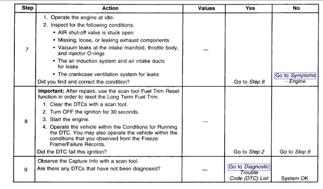

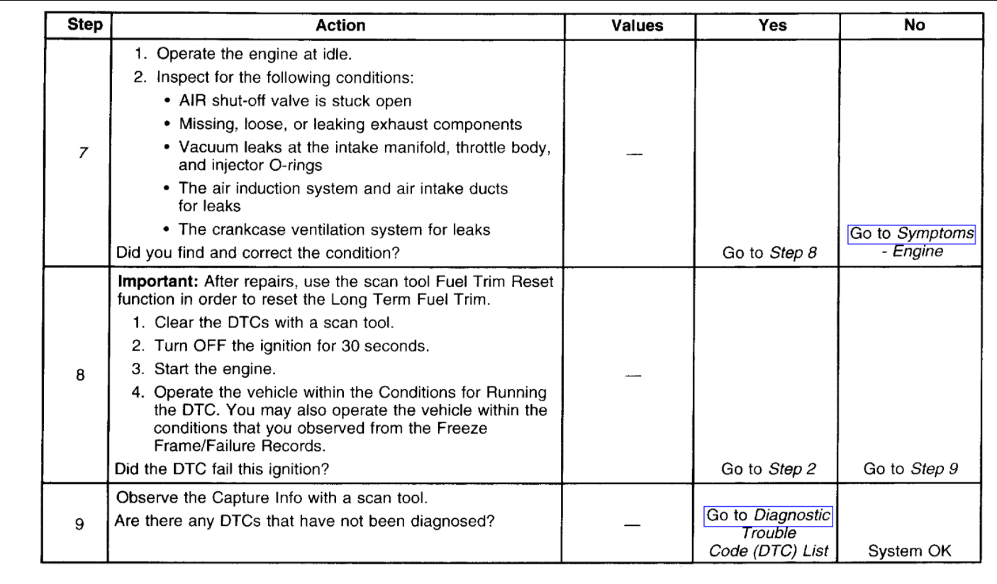

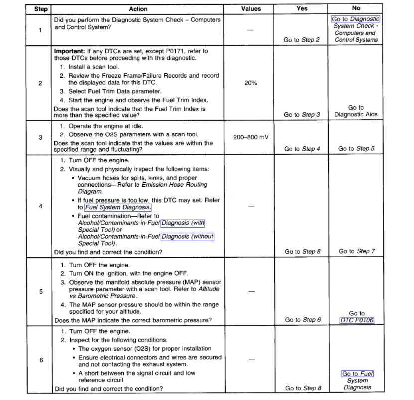

Obd2 code p0171 bank one lean. Truck is missing, no power when floored, no other codes. Can anyone tell me were to start without fixing everything scanner says to?
Dec 4, 2020 at 7:00 AM

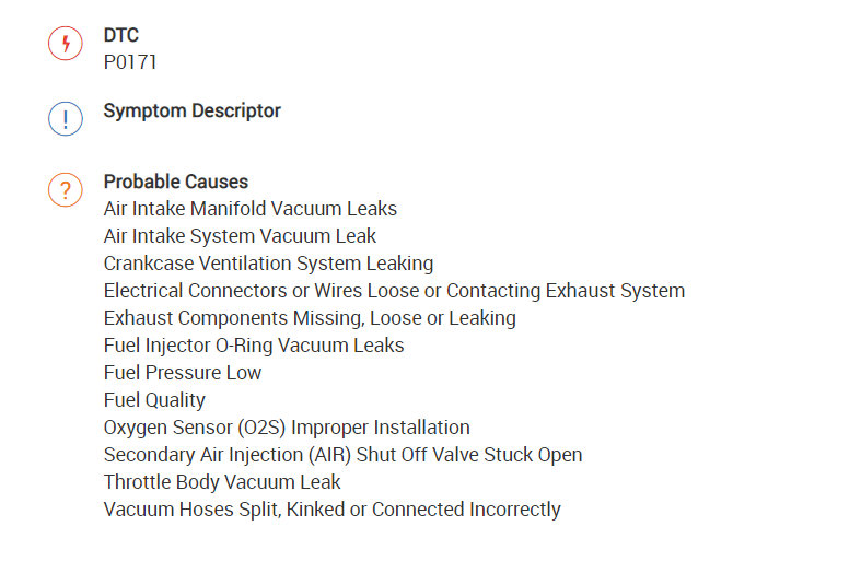

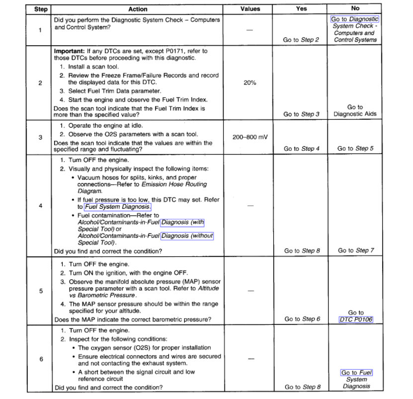

Good evening,
This is a lean code. That means you may have a vacuum leak causing this or it could be something else.
https://www.2carpros.com/articles/repair-lean-mixture-codes-p0171-or-p0174-on-some-manufacturers
I attached the flow chart for testing for you. Follow the chart the best you can and let me know the results.

I did the fuel pressure test turning the ignition on is roughly 25. in order for me to get the car started I have to turn the key on turn it back off turn it on turn it back off the third time it will start. Indian before that it just turns over fuel pressure after startup is 17-19 somewhere in there the fuel filter fuel pump are roughly a year-and-a-half old. I've replaced the injectors and then it came up as a misfire Sports number 4 cylinder. so I moved a coil pack up to number 2 and came up with a misfire on number two. so I replace a coil pack take care of that problem, but I'm still getting that lean code no vacuum leaks. I replace the forward O2 sensor.
Dec 13, 2020 at 4:12 AM

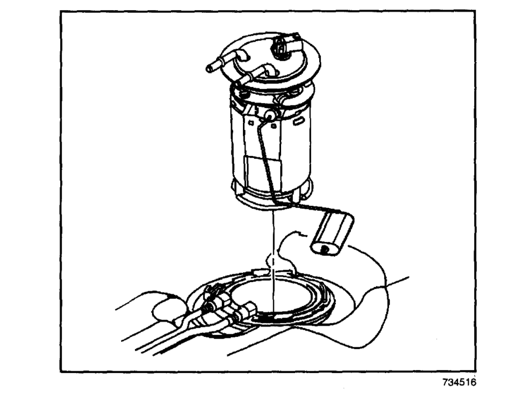

Okay, the fuel pressure is the issue.
Fuel Pressure (Key ON, Engine OFF) .................... 345-395 kPa (50-57 psi)
As you can see the pressure is out of spec. You need to replace the fuel pump.
https://www.2carpros.com/articles/how-to-replace-an-electric-fuel-pump
FUEL SENDER ASSEMBLY REPLACEMENT
TOOLS REQUIRED
J 44402 Fuel Tank Sending Unit Wrench
REMOVAL PROCEDURE
1. Remove the fuel tank.
NOTE: Do Not handle the fuel sender assembly by the fuel pipes. The amount of leverage generated by handling the fuel pipes could damage the joints.
2. Use the J 44402 to remove the fuel sender assembly retaining ring.
3. Remove the fuel sender assembly and the seal. Discard the seal.
CAUTION: Drain the fuel from the fuel sender assembly into an approved container in order to reduce the risk of fire and personal injury. Never store the fuel in an open container.

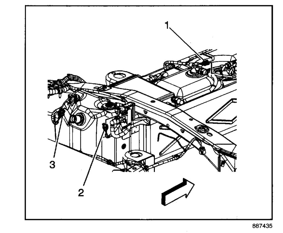

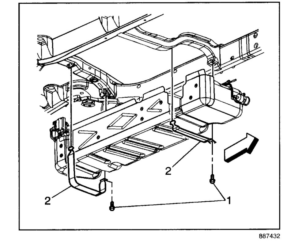

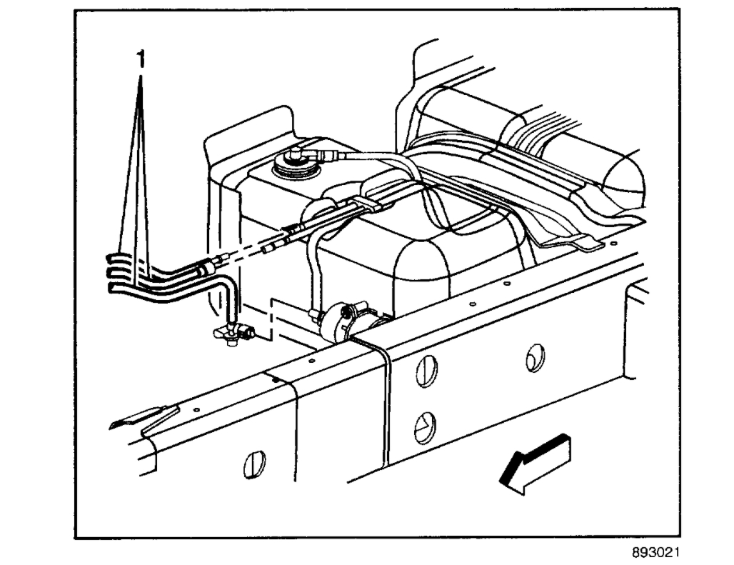

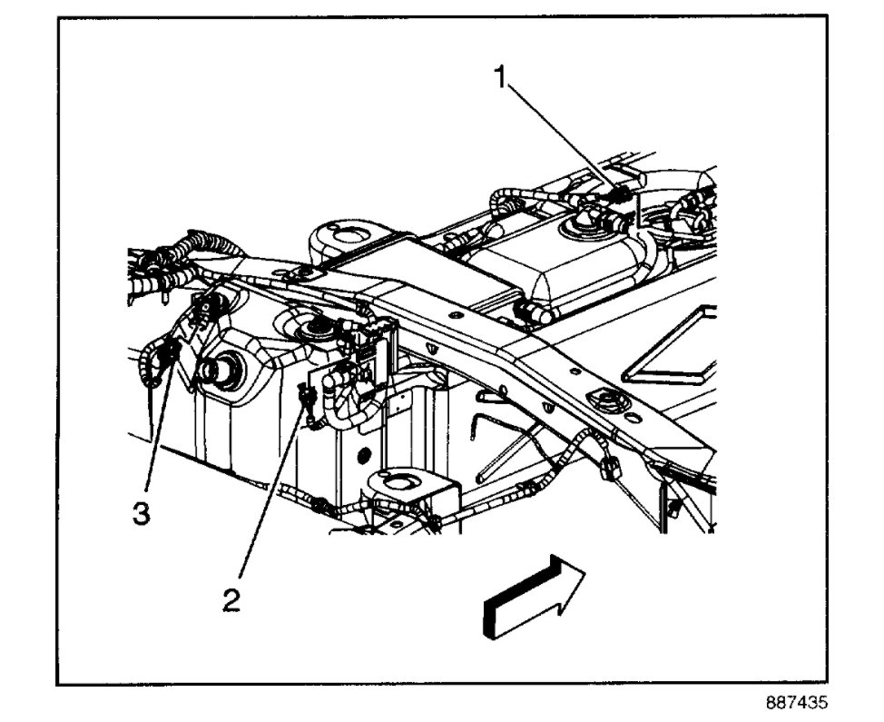

FUEL TANK REPLACEMENT (TRAILBLAZER EXT, ENVOY XL, ENVOY XUV)
REMOVAL PROCEDURE
1. Relieve the fuel system pressure. Refer to the Fuel Pressure Relief Procedure.
2. Raise the vehicle. Refer to Vehicle Lifting.
3. Remove the frame brace.
4. Remove the fuel tank shield, if equipped.
5. Drain the fuel tank. Refer to Fuel Tank Draining Procedure.
6. Disconnect the fuel tank pressure sensor electrical connector (3).
7. Disconnect the evaporative emission (EVAP) vent valve electrical connector (2).
8. Disconnect the fuel return pipe, the fuel teed pipe and the EVAP purge pipe (1).
9. Cap the fuel and EVAP pipes in order to prevent possible fuel system contamination.
10. With the aid of an assistant, support the fuel tank.
NOTE: Refer to Damage to Fuel Tank Straps Notice in Service Precautions.
11. Remove the fuel tank strap attaching bolts (1).
12. Remove the fuel tank straps (2).
13. Carefully lower the fuel tank.
14. Disconnect the fuel sender electrical connector (1).
15. Remove the fuel tank.
16. Place the fuel tank in a suitable work area.
17. If the fuel tank is not being replaced, go to the Installation Procedure.
